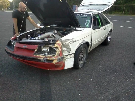

and @Davedacarpainter 4.9x's in the 1/8th is 7.7x's in the 1/4 And it will still make a beer run after any event if need be! :beer emoji:
Well nearly any event:
Reactions: 84Ttop and RaggedGT
OUCH!! Luckily that was testing and not an actual event

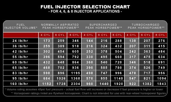

Here is a basic rule of thumb:
Reactions: General karthief

The chart is a little confusing due to the fact that the kit advertises more horsepower than the chart says my injectors can handle and the kit doesn't require new injectors. With the added fuel pressure on the rail due to the fmu included with the kit, it seems like they might be okay. The guy that I spoke with on the phone whose built a million motors was telling me that it usually isn't your injectors flow rate that can't keep up it's usually the pulse rate. He said that they had a 750hp motor running on 24lb injectors due to the fact it only turned 7000 rpm. With my little v6 only revving to 5grand I'm sure the injectors shouldn't have a problem keeping up the pulse rate.
The issue with turning the fuel pressure up is this.... it will put strain on the pump. None of us use an fmu anymore, we use injectors sized for the application at 43.5 psi and utilize a rising rate fuel pressure regulator....
When an fmu is used it make the injector act larger by cramming a tonne of fuel pressure into them. As fuel pressure rises the injector "size" does as well.. ie. (The amount of fuel moving thru the injector.)
This leads to other issue however, what happens when the fuel pump gets hot? Or the injectors themselves get damaged from too much pressure? It's simple a lean condition... then the motor goes... boom.
The flow rate relies upon the pulse width and injector size to deliver fuel. When you start elevating pressures to fuel injectors, you run the risk of sticking that injector into either the full open or full closed position. Neither is desirable.
As pressure increases, fuel volume decreases until you hit the limit of the pump, lines, or rails. Everything in that system is being pushed pass specification and this increases the chances for failure. As an added benefit, you also create an awkward injector spray pattern.
Does it work though? Yep... It does.
On a side note: I'm not buying 750 hp on 24lb injectors at any rpm. It may have been a motor capable of producing 750 hp but it did not produce it with 24 lb injectors, not even at 90 psi. without supplemental fuel.
This statement doesn't make a lot of sense so I'm trying to decipher:
Why would your V6 only turn 5000 rpm? Is something wrong with it?
Pulse rate does not determine whether the motor has adequate fuel. Pulse rate is how quickly the injector must cycle to maintain AFR with engine demand, fuel volume, pressure, and injector size. You don't get to pick the pulse rate and it is not the limiting factor of an injector.
A fuel system is just that: A system
You don't get to pick on a single attribute of a single component to determine whether it is adequate to meet power demands. You could put any injector of any size you like into a car with an 88 lb/hr fuel pump and be able to support LESS HP than you did with 19 lb/hr injectors.
Perhaps the term you are looking for is "Duty Cycle" and that varies with volume and pressure capabilities of the rest of the fuel supply system.
One last note: FMUs and in-line pumps are BOTH dicey. They are band-aids that introduce additional failure points.

I think at this point I'm just going to go with a bigger fuel pump in the tank, bigger injectors and eliminate the piggyback and fmu. Sounds like that's the safest bet.
Glad to read this. I think you will be glad you did. Less clutter, and less chance of failure. Thinking 24 lb/hr injectors, and a 190 l/hr pump in the tank? I dont think there is much of price difference in fuel pumps, so I would say while you are in there, go for a 225 l/hr pump incase you ever decide to get radical in the future (ie stroker, etc).

If it were me making the decision only knowing what is printed in this thread, I would choose 30# or 36# injectors.
Here's why:
Supercharger + injector swap of any kind = dyno-tune or more equipment.
Since the tune is required anyway, why not run an injector that will not need any additional "help". Leave the stock fuel pressure regulator right where it is. Change the in-tank pump, run a proper sized injector that will put you at 85% duty cycle at Wide Open Throttle, and get a tune.
Don't skip the tune. Don't think you can get away with railing on it even one time until it's tuned.
