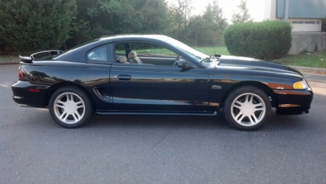

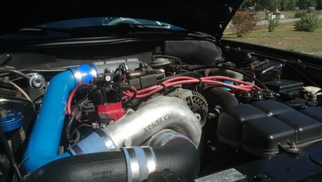

Hey guys just picked up this beauty and looking for a little advice as to what i need to do next or improve? Abiut how much hp its putting out? Air fuel ratio seems to jump around goin from 14-16 cruising and hitting around 10 at wot..... i was thinking 42 lb injectors?
-Single Over Head Cam (SOHC) 4.6L 281ci V8 with Vortech V2 supercharger -255lph T-rex fuel pump -MSD ignition packs and wires -BBK shorty headers into catless X shape midpipe and Flowmaster 40 mufflers -BBK 78mm throttlebody/ intake plenum -Ngk Tr6 spark plugs (.35 Gap)
Drivetrain -T45 5 speed manual transmission -Spec stage 2 clutch / high clamp pressure plate -Adjustable clutch cable / aluminum clutch quadrant -3.73 FRPP ring and pinion rear end gears
Suspension/Steering/Brakes -Eibach Drag launch springs with inflatable air bag in rear -Brand new front struts and rear shocks w/ axle dampeners -Brand new front Cobra lower control arms (tighter turn radius) New swaybar links -Tubular steel upper and lower rear control arms w/ Greaseable bushings -Brand new Vented brake rotors/ pads/ and hardware
Misc. -Autometer Boost, Oil, and Air/fuel ratio gauges with dashpod -American muscle fiberglass cowl hood -Short throw adjustable shifter
Here's a couple pics

Might want to have a tuner look over it and log it on the street for piece of mind. AFR seems good at WOT. He will be able to tell how much timing the car has, if it is detonating at WOT, etc. Sounds like a nice car!
You need to provide a lot more info if you want a decent HP guess. How much boost? Stock NPI motor?
If the car is still the stock NPI motor running the basic 8psi (or so), I'd say your pushing around 330-350rwhp.
Yes stock npi motor... and boost im not to.sure i believe the belt is slipping.... pulls strong still but only shows a max of 3-4 psi.... belt looks a little worn so i have another on the way.... any opinion on the injectors?
Why are you jumping to injectors right away? AFR is rich under boost. Not sure that you need them if your FP is good and the car is staying rich. Again, log the car, and a tuner can see what duty cycle they are at. You need to get the car to a tuner, asking people on the net on what you need with little info isn't going to provide you with near the info as simply logging the car will. This will also show belt slippage, etc.
