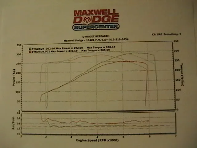

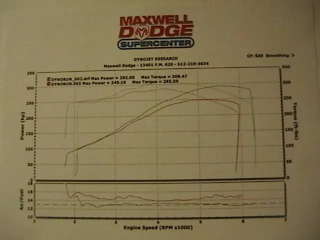

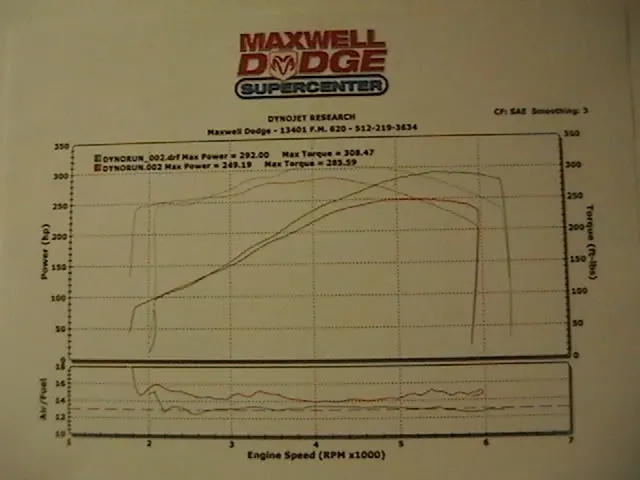

Here it is. Car feels stronger all the way around to me. bolton vs Cammed/LT
Those are some good numbers, and it's kind of cool to compare.
I was looking at Stage 2 cams.
Below is a dyno run from a 00GT bone stock other than a set of Flowmasters.
So it looks like a bone stock 4.6 will get more power from a stage 2 cam swap than it will from "EVERY bolt on" and only be down 28HP and 15 FTlbs of torque from "EVERY bolt on" and a set of Stage 1's
I thinl that is some good info for people trying to decide where to start modding :nice:
