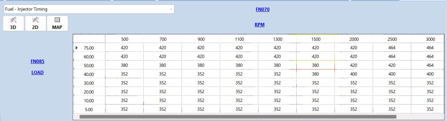

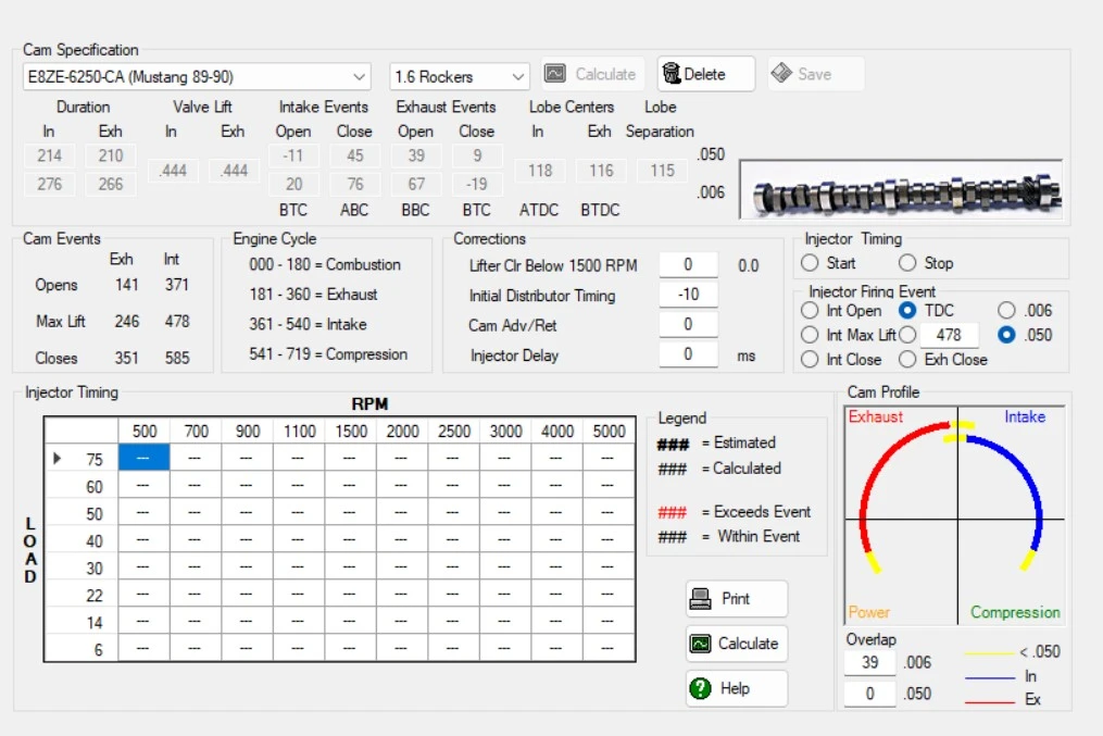

Youre gonna need to know when to spray the fuel from the injectors into the intake and also gonna need to modify the lil holes in your butterfly in your TB with a slightly larger hole.

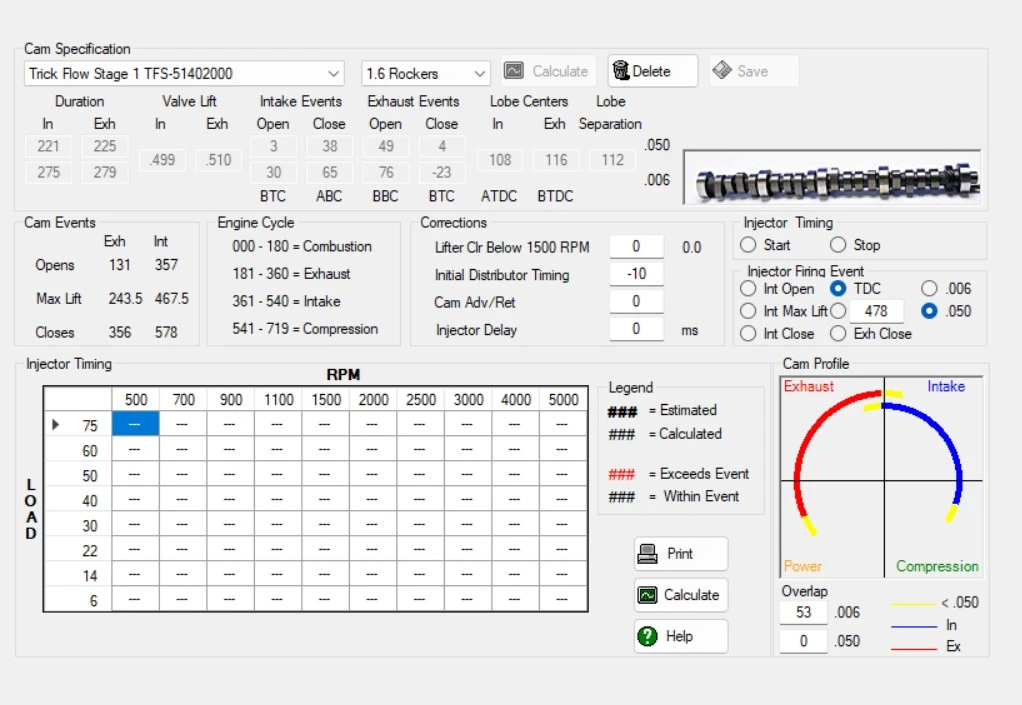

Knowing when to spray the injectors is a fine art with aftermarket cams especially ones with alot more overlap than stock because you can literally throw fuel out of the exhaust or even overheat the intake valves by not taking advantage of the atomzation off of the hot valves which also cools them ..
This is gonna require a tuning chip to accomplish as youre gonna need to change idle settings and tailor your maf transfer and injector size etc....
Most try to bandaid the issue by advancing the distributor and turning the throttlestop screw which throws off all calculations based off of load and causes you to be a slave to doing frequent battery draindowns and idle relearn procedures..........
Right now when you look at a stock cam vs the stage 1 camshaft the overlap between the two its evident that with a stock injector timing table youre puddling up fuel inside your plenum right now and if you remove the upper intake will probably find its all wet.
Screenshot 2024-06-25 142854.jpg Screenshot 2024-06-25 142827.jpg Screenshot 2024-06-25 145459.jpg

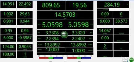

My injector timing settings are all changed from the stock setting above and I had to raise my highslope in the injector setting by 5 points just to smooth out the injector pulsewidth with the 255lph fuelpump in the fueltank and the reason why I run the 255 is because I have a water seperator filter aswell as a couple super microfine fuel filters one for the engine and the other for the N20 and never want to guess an issue as being fuel related especially when Im running very safe....LOL

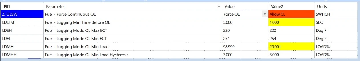

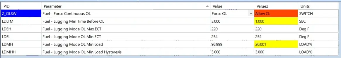

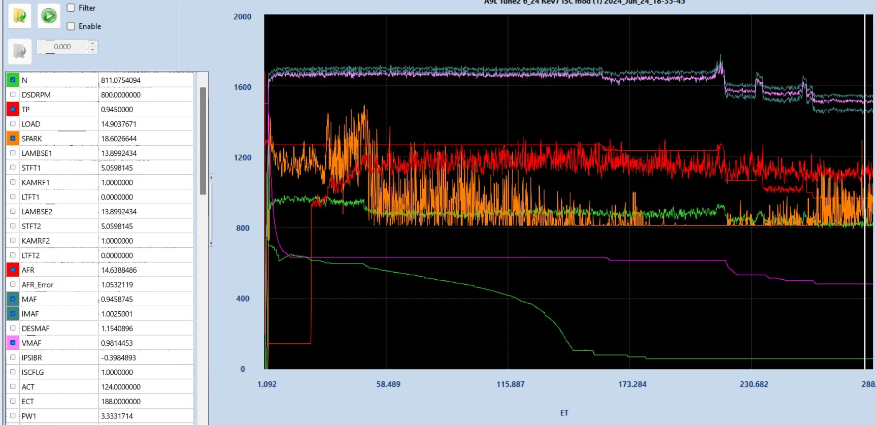

I just went through a similar issue except I have the tuning chip and couldnt get idling smoothed out enough without leaning it out then when the adaptives kicked after entering closed loop so I had to force it into open loop and then get the fueling worked out manually.

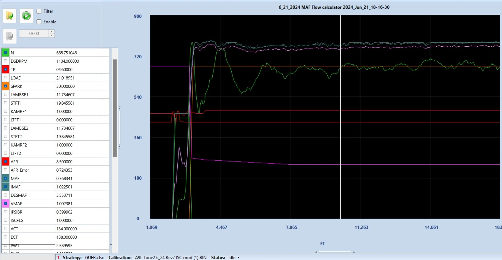

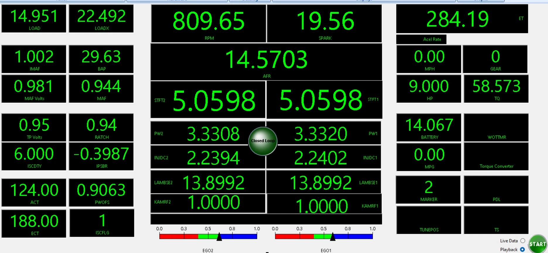

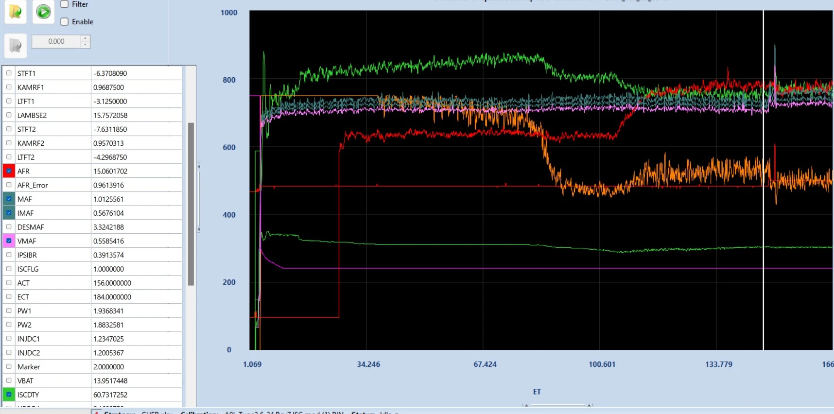

Heres a logfile from a direct startup then doing the bandaid way of upping the timing and t-stop screw just to see what happens......
In the final stages of my tuning was to slowly back down the TB throttlestop screw until I got the idle I wanted as the ratch followed no problem..

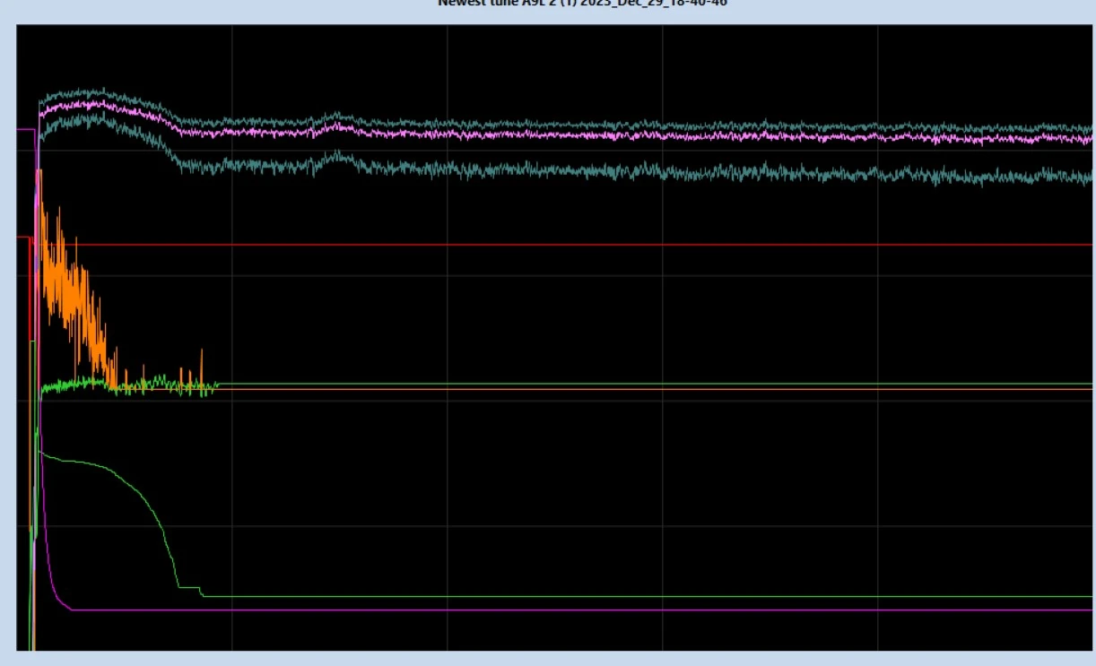

I couldve backed out the throttlestop screw a tad more to put the IAC to more work but I like when the rpm's dont dip down alot better as it gives crisp flawless shifts with a manual///.......This below was one of the logs that was in phase with setting idle and AIC/ISC......

I went from a 1/16" stock pin hole in each throttlebody flap to slightly larger 1/8" holes in both flaps and changed the injector timing table to match the camshaft events of my camshaft plus turning on closedloop to get the idle smoother than I ever imagined..

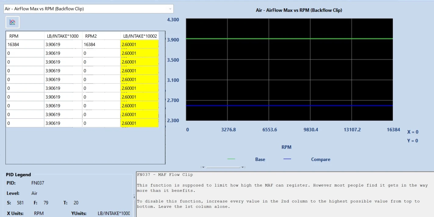

Your ECU has a backflowclip setting allowance for a stock engine...On a modified engine you want to adjust this so its not an issue...

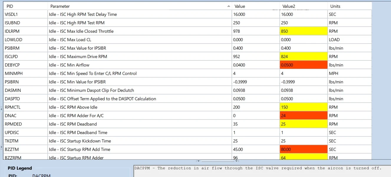

All values on the lefthand column is my tune and the ones on the right highlighted are the stock settings....

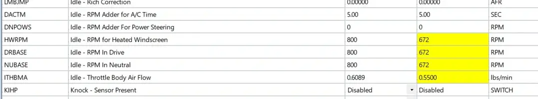

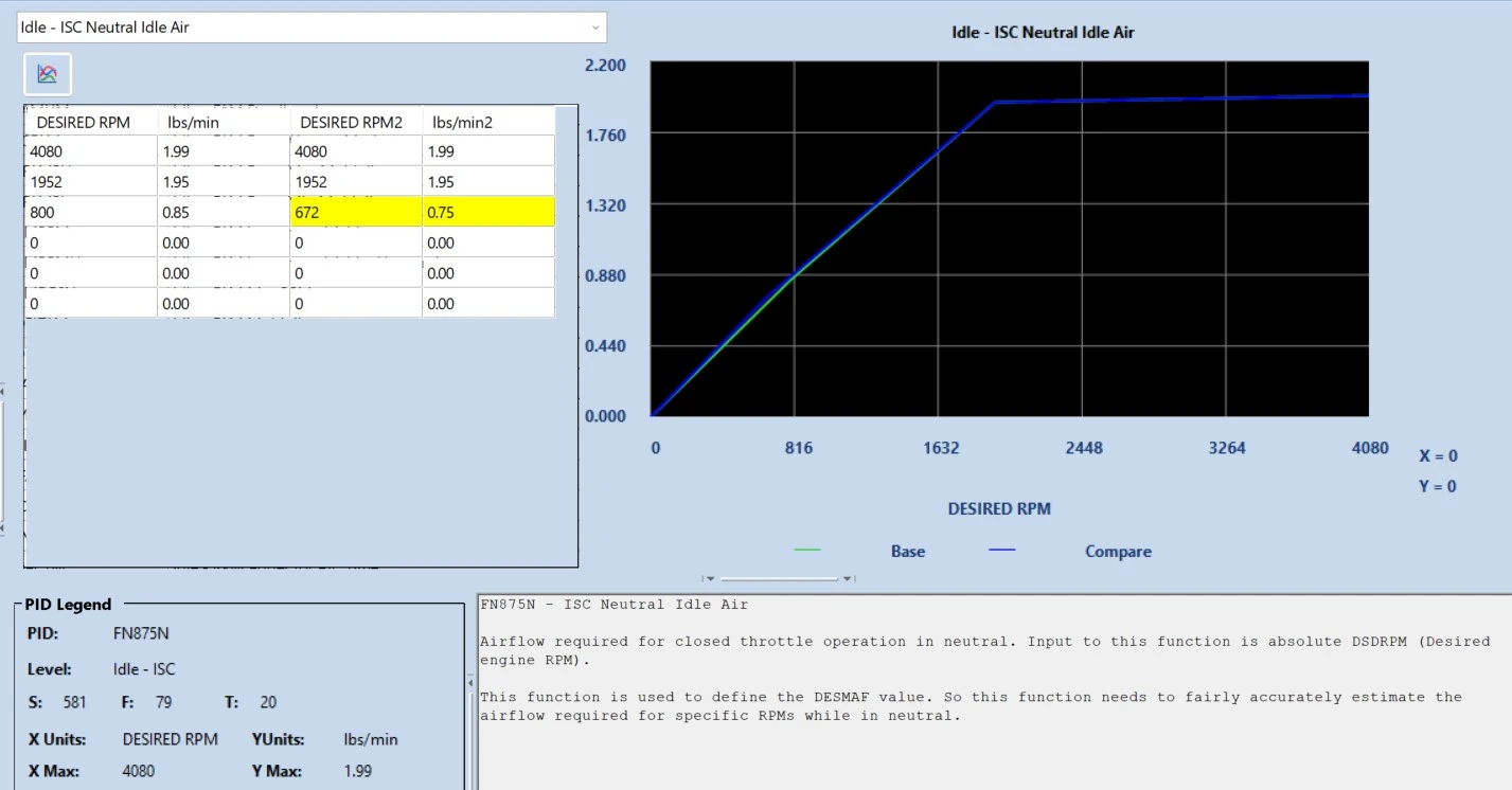

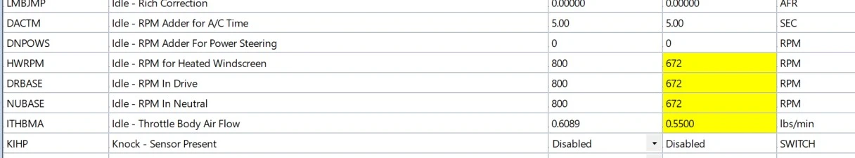

My new idle settings for my camshaft recommendations are custom set in the ECU to 800rpms with all other parameters changed and raised accordingly so proper calculations can takeplace alot faster..
When you raise the idle just by turning the throttlestop screw is all wrong as theres many parameters that must match the new idle needs in order for the ECU to calculate and function correctly and make your engine run as efficiently as possible...
Seeings 800rpms is 128 rpms over stock setting everything in alot of parameters must be raised by that same 128 or calculations will be way off at WOT...

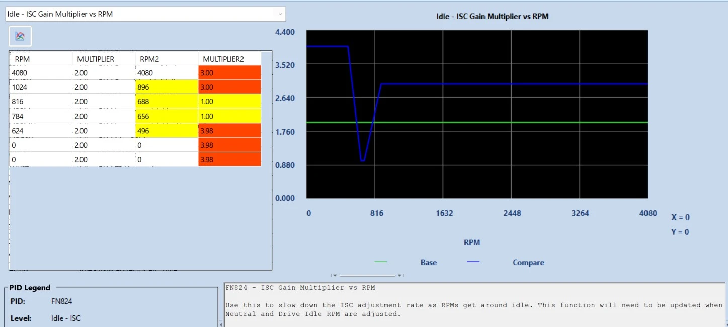

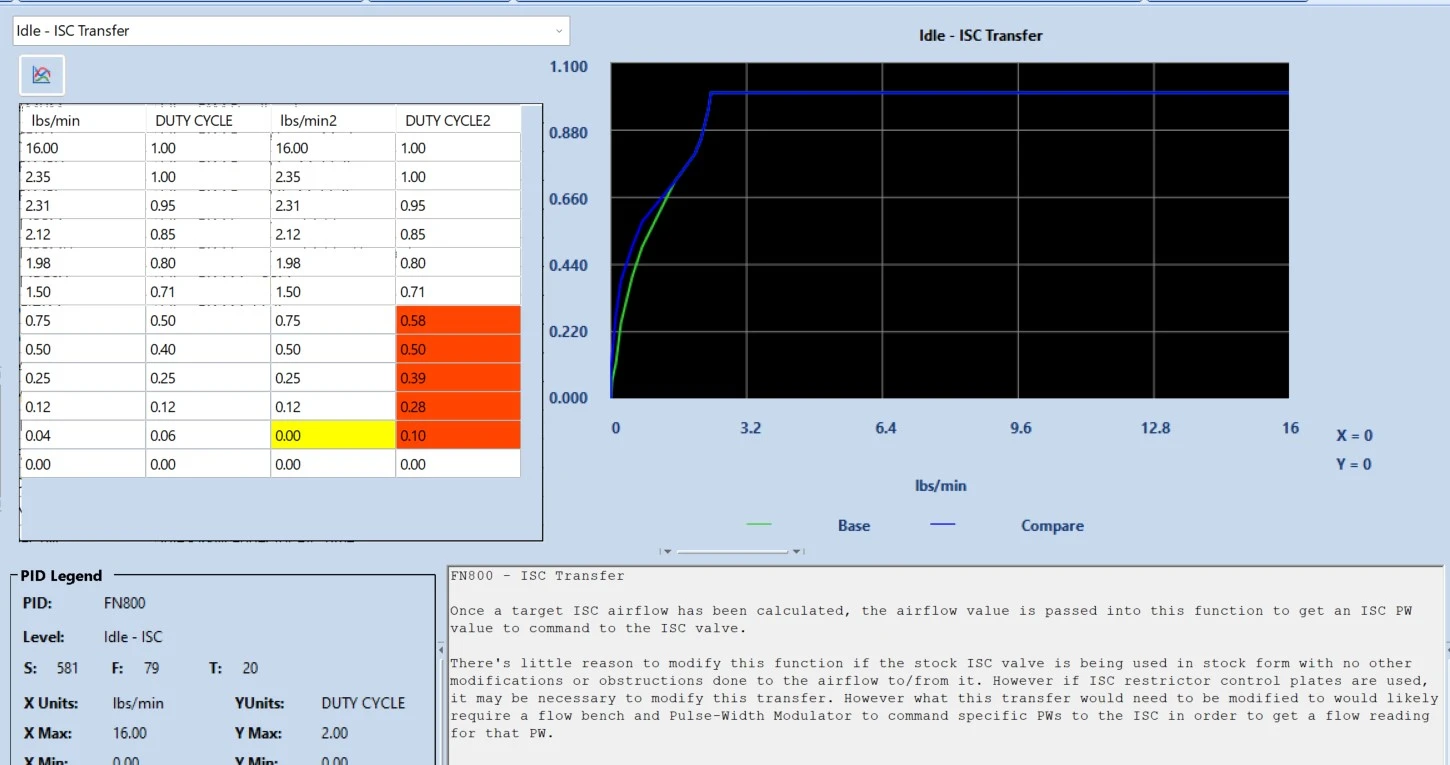

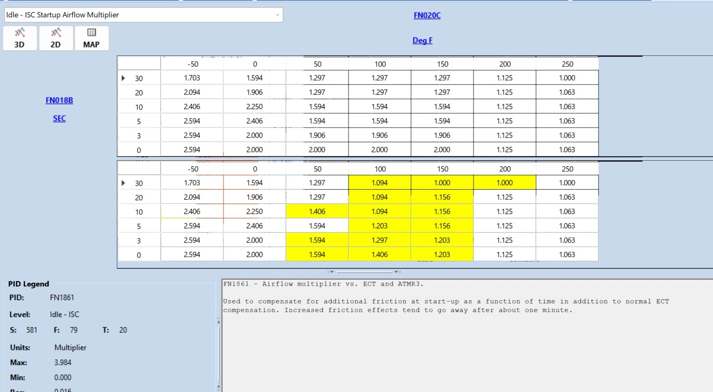

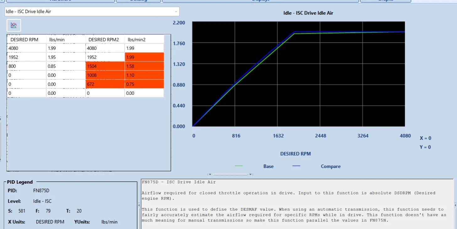

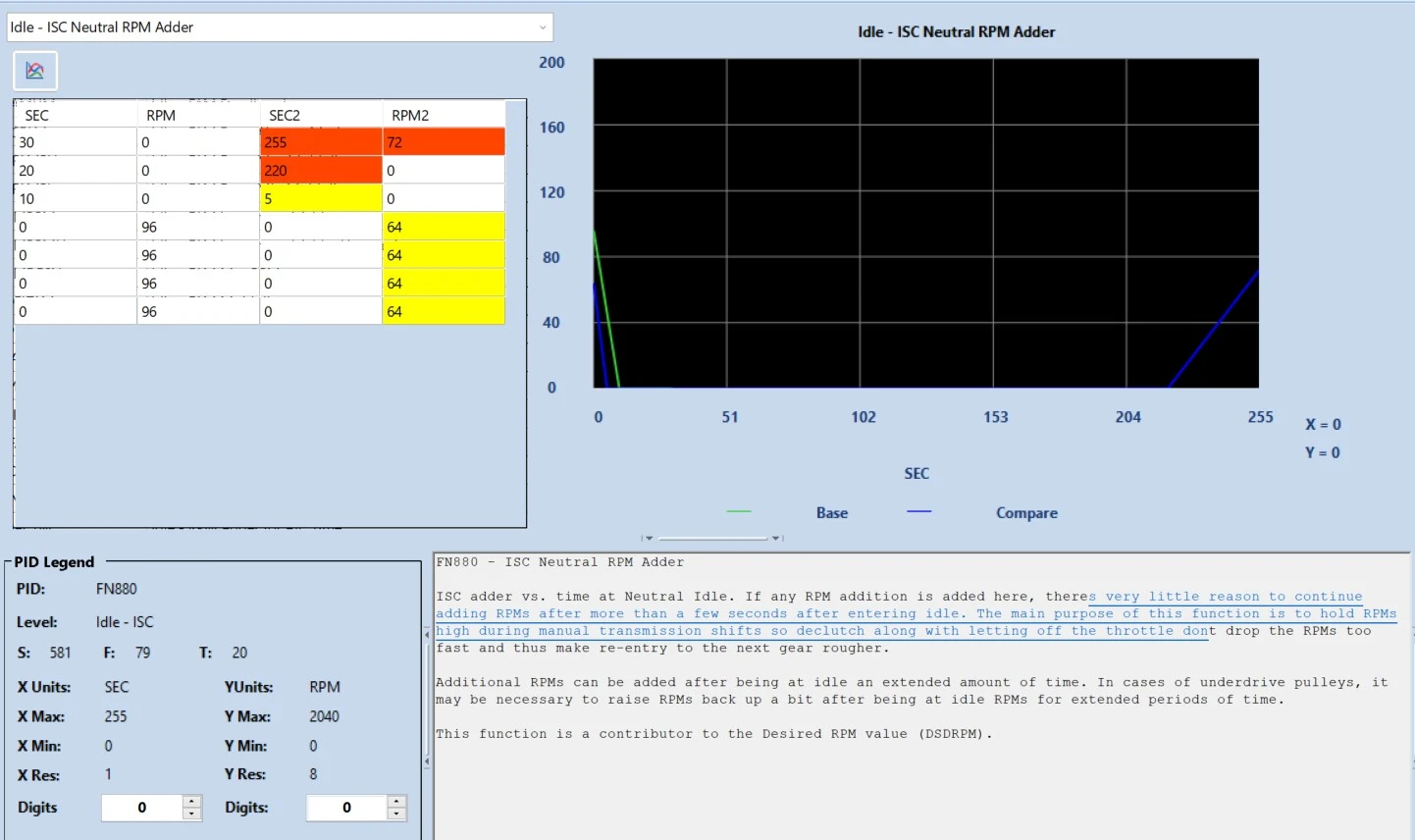

The other things needed to change was rpm gain multiplier in ISC which I changed to all 2's and it stops the wicked idle swings and surging....youll also need to lower the IAC opening in the ISC transfer section asell as adjust the a few other parameters to get your A9l to adjust correctly..

But like I stated if your fuelling isnt good this wont work because adaptives must be abled and also so does closed loop mode....

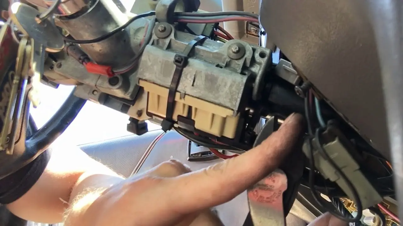

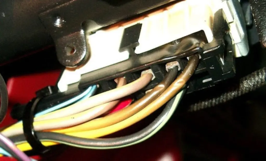

There was a recall on them due to a fire hazard. They have issues with the metal part separating from the plastic part and wires getting hot. Most if not all of Fox Mustangs have had the ignition switch replaced once and some a couple of times. Examples of failures:
Melted wires and connector:
Plastic part and metal part separation with zip tie"fix":
