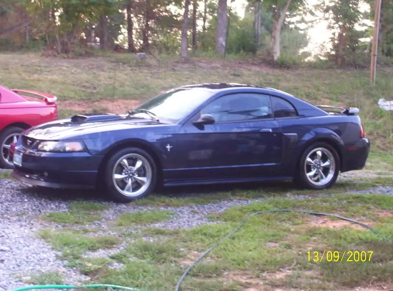

2002BLGT can you post a pic of your car if you have the eibachs?
car looks a little low in the pic but its actually not , but its not sitting on a level parking lot , the gravels in my driveway have some high and low places
Ya, that's really high compared to my car with the H&Rs.. damn it :(
I guess I'm gonna have to compromisse either comfort or looks.... :(
yea I am kinda in rural VA so some of the roads are not that great , I got the prokit because its lower than stock , but not in the dirt ........ here is a couple pics of a 98 cobra with H&Rs that I tuned 3rd car down , blue cobra
