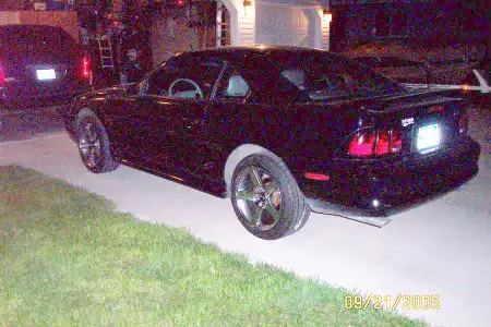

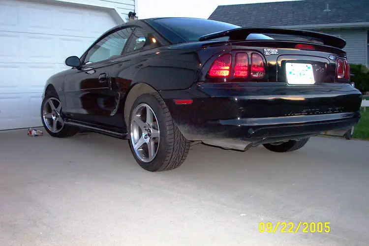

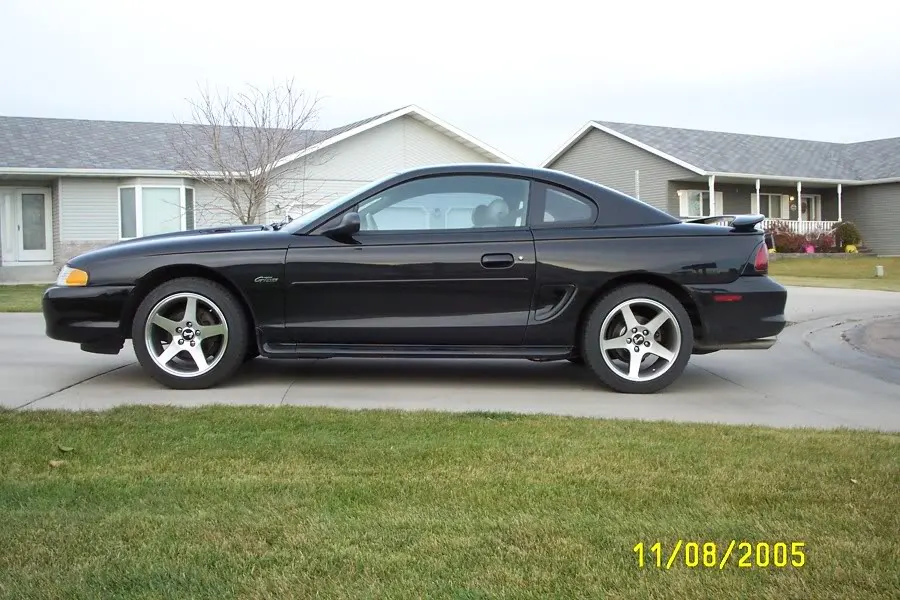

Like Cobra showed you, it's a nice drop...
Before
After
The more I look at my car though the more I want 18x10's in the rear...
