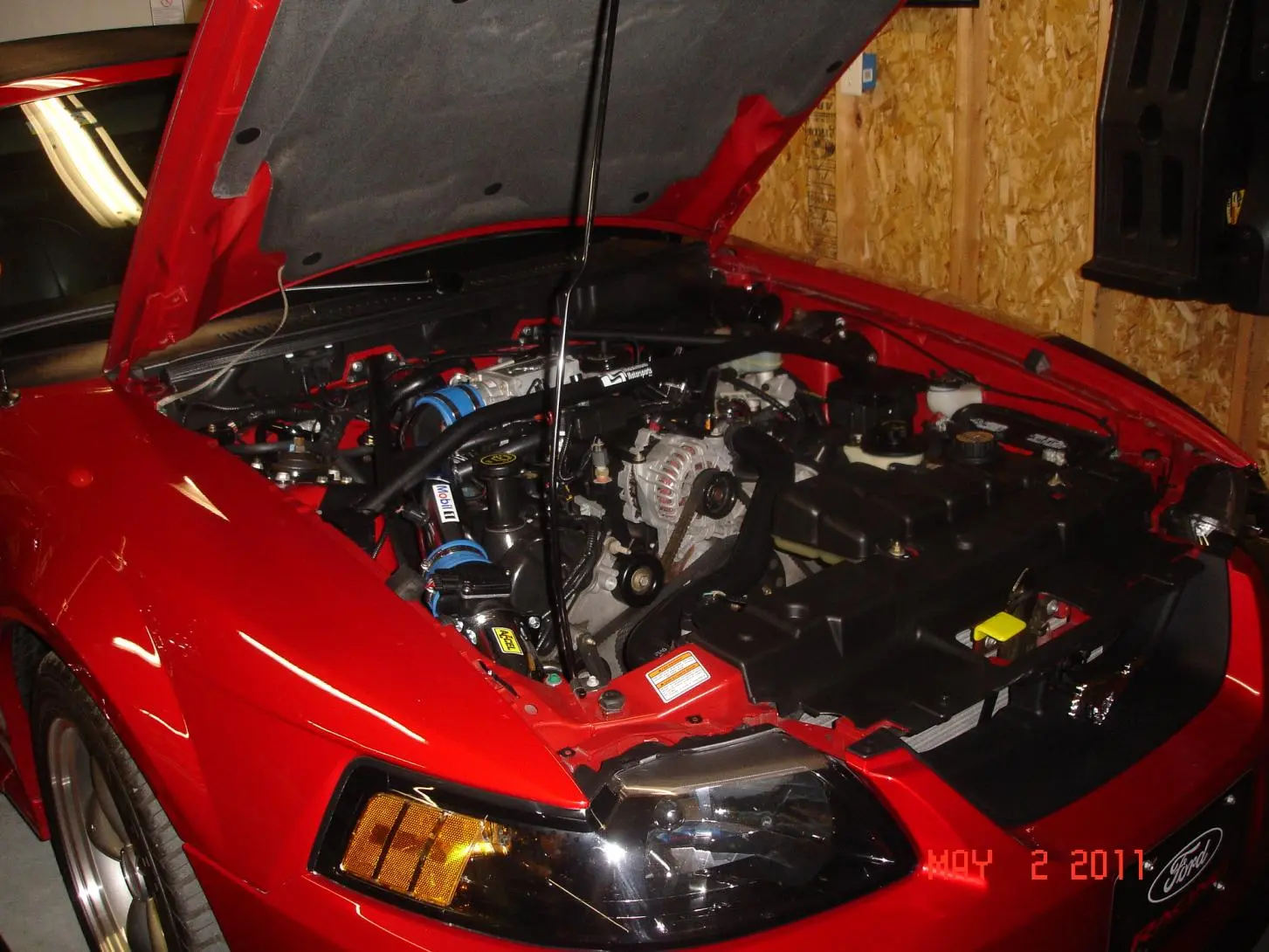

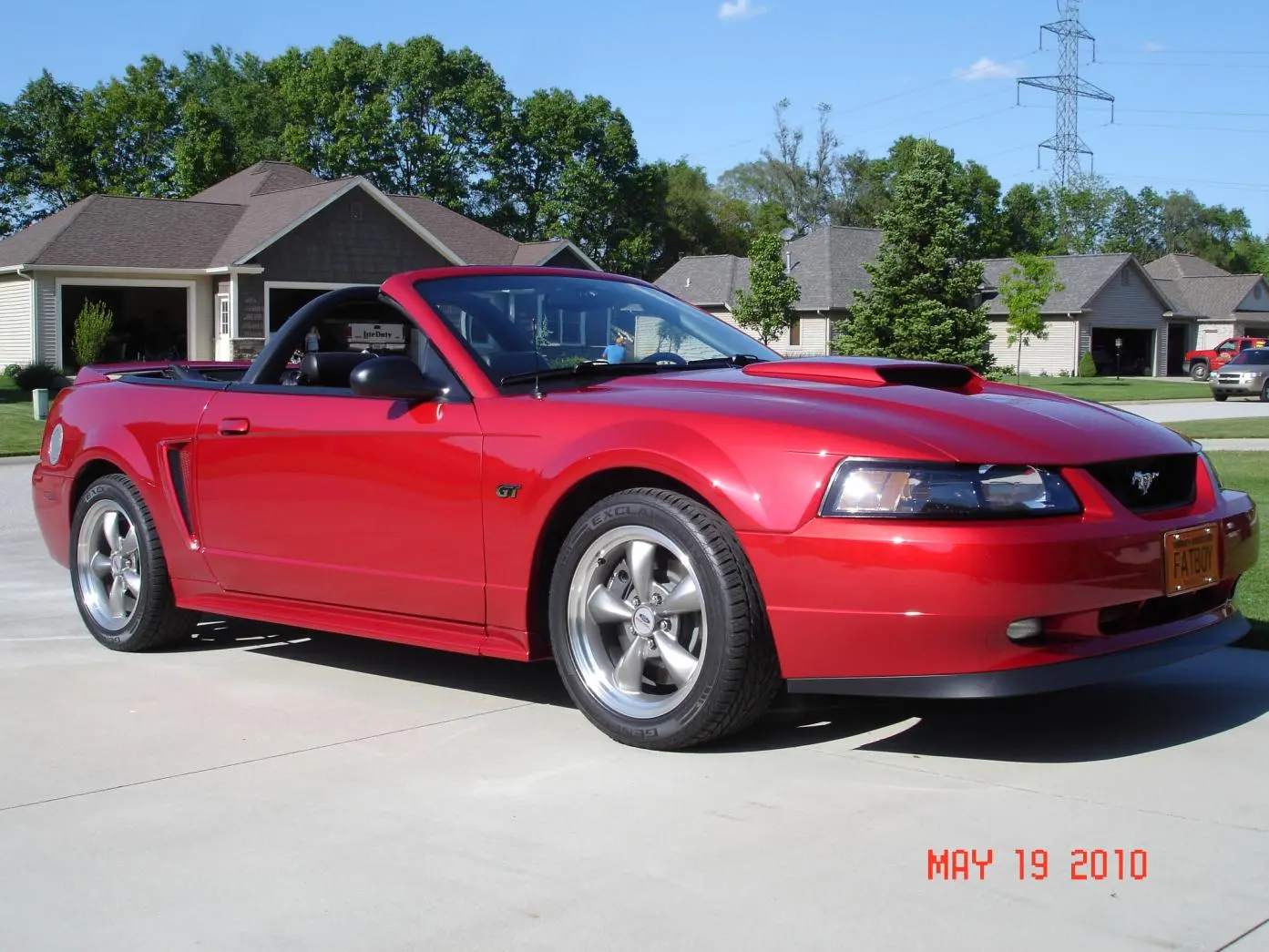

I installed Ford M-5300-G springs on my 00 Vert, they're made by Eipach, the ride is very good and they lowered the car 1 3/8" on all 4 corners, with a full tank of fuel, the rear will rise a 1/4" or so depending on the fuel level.
I also installed a MM strut tower brace which is a very high quality part that bolts to the pinch weld on the fire wall. The only problem I had with it is I had to trim the BBK CAI to clear the brace, very tight fit, it truly helped with the creaking noises.
My next project is to install Global West subframe connectors, Brenspeed is doing the work in June not sure on the cost yet?
Good luck on your mods...
