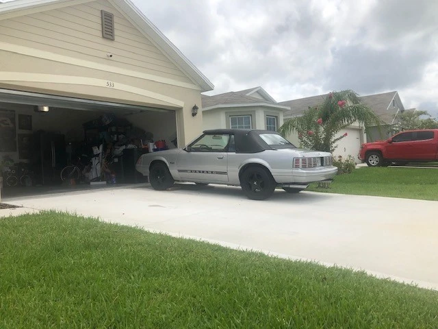

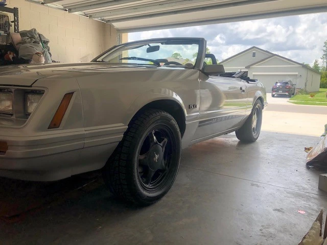

I had Eibach lowering springs installed last week and the rear looks great, but the front did not lower even a little bit. The springs are the ones specifically for the convertible. I have taken some drives and hit every bumpy road I can find and no settling at all, even if they settled it wouldn't make much of a difference.
I am wondering if maybe changing to aftermarket struts that are more compatible with lowering springs would help? My thought process is that maybe the struts on the car now are too high gas pressured struts and are not allowing the front to come down?
Attached are the before and after pictures, as you can see the front end was already a good bit higher than rear before spring install.

Struts won't change ride height, usually. Some struts are high pressure and may lift the front a little thoigh.
How did you replace the spring? Did you unbolt the lower control arms from the K-member? If so, did you retorque at ride height or with the wheels dangling down.
How are the springs orientated in the control arm cups? Did you install new poly or rubber isolators? Did you position the springs so the lower pigtail loop is covering one of the small drain holes, but not covering the bottommost?
Struts won't change ride height.

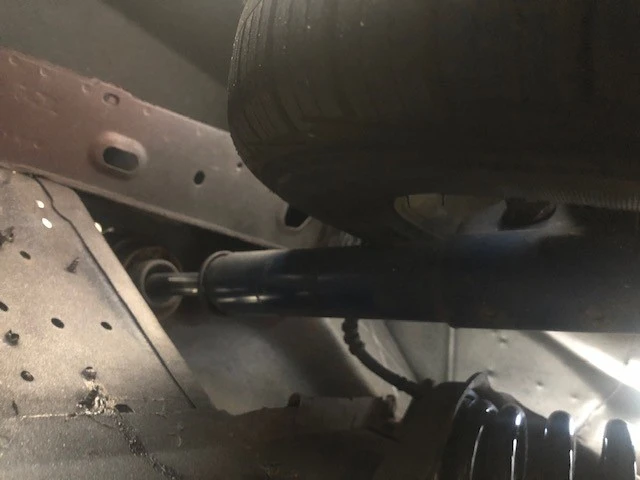

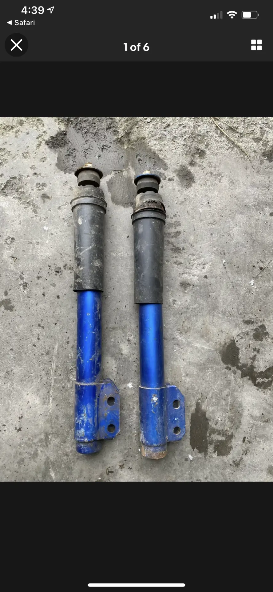

As for the strut thing, I read online if the incorrect strut was installed with too high of a gas pressure it could keep it from coming to correct height...Attached is a picture of the strut on my car..not sure if it shows anything that could help me or not....I am just not sure which way to go with this issue and already spent $250.00 on an install
You could try giving Eibach a call and see what they have to say. If it isn't to much trouble for you I would suggest pulling one of the front wheels so that you can check how the spring is seated in the lower spring perch. If it is in the wrong position, as in the tail of the spring is not fully rotated into the recess in the perch, it could be causing the front to sit up higher than it should.
Eibach should be able to answer your question about the strut as well.

We’re those struts ever changed out before? I assume so.
they are missing the typical stock style dust boot. (See attached) What’s up top for a caster camber plate?
since this issue might have been present before, I wonder if something in your front suspension is binding. Properly working struts don’t play a roll in ride height, but bad ones might. If the strut or any suspension part is binding at all, it too can keep the car lifted up higher than it should

I am thinking the struts were changed at some point( I have only had the car for a few weeks). My gut feeling is either they are bad or are incorrect for this car. While a proper low pressure strut shouldn't make a difference, from the research I have done and techs I've spoken to, a strut with the wrong gas pressure(too high) can affect it
I am 270lbs and in order to get the strut to move at all I have to lean on it and then put my muscle into it pretty heavy to get a couple inches of travel.
My first guess is the shop probably loosened the a-arm bolts to help get the springs in place(since they said they had trouble)and tightened them back down on the lift with the suspension at full droop.
The Eibach tech I spoke to thought this was a potential issue also, but wouldn't any shop worth a :poo: have just gone back and simply fixed that issue? Regardless I have new struts coming and will be learning about Mustang suspension geometry to try and figure it out LOL
Yeah, that doesn't sound right.
With my Bilstiens, if i lean on the strut i can compress it down by hand easily hold it compressed
