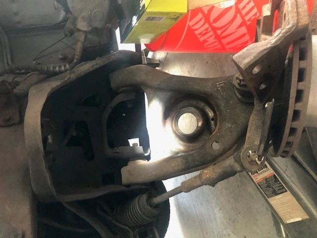

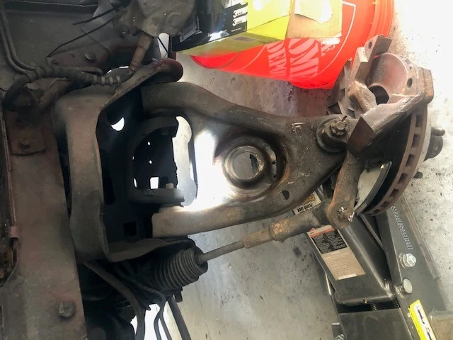

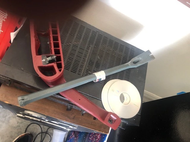

Does any of this look odd? Only thing I noticed is there is no sway bar on this car, is that a vert/84 model thing that didn't come with? Also, this is the pry bar I am using...I cannot get the spring to compress enough to get the rear to come within 2" of the perch.

I have no problem swapping springs. Swapped a bunch both lowering and stock back in. What I haven't done is try it with the spindle on. I may be wrong and it works fine with it on. I couldn't do it like that. You need the spring as close to in place as you can, then use the pry bar head on. That's the best spot to keep the spring from popping out. You start slightly lifting the control arm with a jack (a second prison would help you) while using the pry bar to place to bottom of the spring. At first if you have the arm low enough, only the back side of the bottom will be touching the recessed area on the lower control arm. The pry bar keeps the spring from popping out as the jack slowly lifts the arm.
That's difficult to explain. Hope it's sorta understandable. You'll get it. We'll all keep helping till you do.

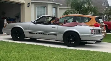

Update...So I was able to get the new springs I ordered in...had to use the old struts still because I ordered the incorrect year on the new ones but it came out pretty good...is very close tot he stance I was looking for to begin with.

I am not sure if I took that pic I have to go back and look...I was so wrapped up in my nightmare(honestly if my cousin didn't come to visit this past weekend the car would still be on jack stands--lol) that I might have forgotten...but the newer springs I got were definitely 3/4--1" shorter, had one less coil in them, and the coils were farther apart so they had more flex in them. The odd thing is the ones that were "wrong" were rated 500--570lbs and I could not get them to compress with the pry bar hardly at all, maybe 1"...where as the new ones are rated 525lbs and the compressed a good 1-1.5" easily....the springs are the only thing I changed though so either they were the issue or me working on stuff "unbound" something.
