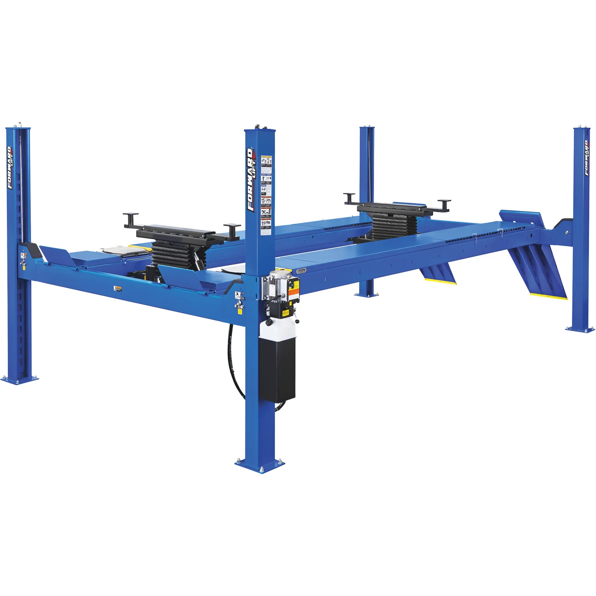

Some drive on lifts have the ability to pick the car up while on the lift to allow the wheels to be removed. Like this one.
