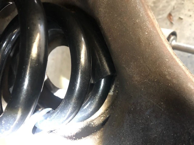

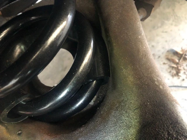

Finally got them loose and looked at the spring and sure enough it was NOT in the perch...the pigtail was about 1.5" past the perch slot.I tried to pry it backwards but had no luck and ended popping the spring out....and now I have not yet been able to pry it back in place so guessing I might need to get a spring compressor from auto parts store?

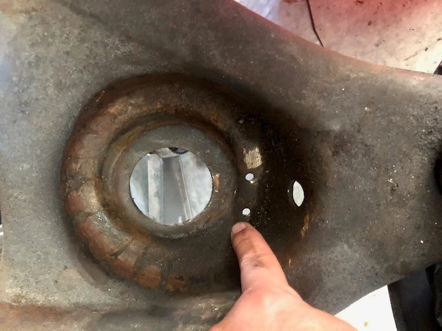

below are the pics...first 2 are pics of the spring in the car and the gap below it is where the perch is if what i am pointing to in pic 3 is the perch. lol

Is it my eyes playing a trick on me here or does it look like there is a broken coil off the old spring rusted into that control arm??

The perch where the spring rests on the bottom should be clean and have nothing in it. Yours looks like there is at a minimum a lot of rust and if not just crusty stuff it might be a broken piece of the old spring. Take a screw driver and a hammer and clean that perch area out if you can.
Yeah I will do that...I was exhausted when i took those pictures...Im gonna get a start in the morning and see what happens

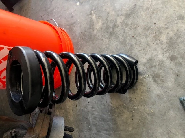

Do you have one of the springs that came out of the front? If so, please show us a pic of it sitting right beside the new lowering spring showing the height difference. A pic from the side.
