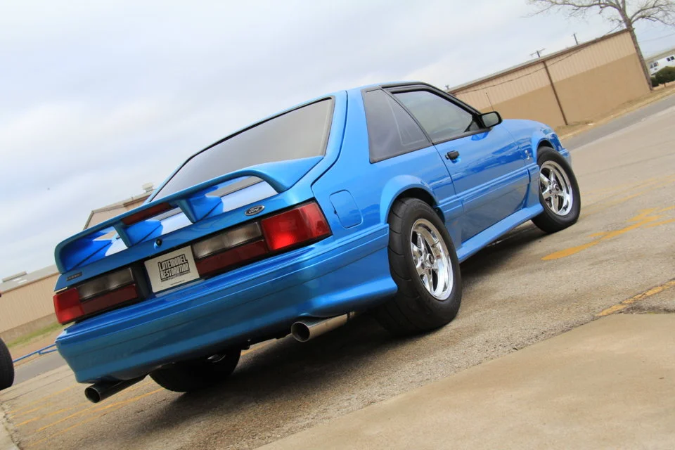

My 88 Notch with 17x4 and 15x10 SVE Drag wheels, I was worried about the 6.25 BS but they fit great, I did roll rear lips and used a hammer to beat in rear inners, The ET streets 28x11.50 wanted to still rub on inside when car leaned hard. So I went with 1/4 spacers and racing studs. With a lil smaller tire I wouldn't have had to do that. My Front brakes are SN95 and rear is still stock with Drums

It has a stock 302, b cam, 1.6 roller rockers, ported e7 heads, gt40 lower with a comp polymers upper intake. stock inj, mass air and TB. Shorties,h pipe, 355s drag struts, stock front springs, 50/50 rear shocks , 4cyl springs, 190 pump, adj regulator. cenerforce clutch, hurst shifter. Zex dry kit on 125 which is a lot less than 125 actually. Car runs 12.20s at 114 on 26x10.50 et streets. I didn't try these 28x11.50s at the track yet. It hooked ggod at flashlight drags but you don't get timeslips at that event.
