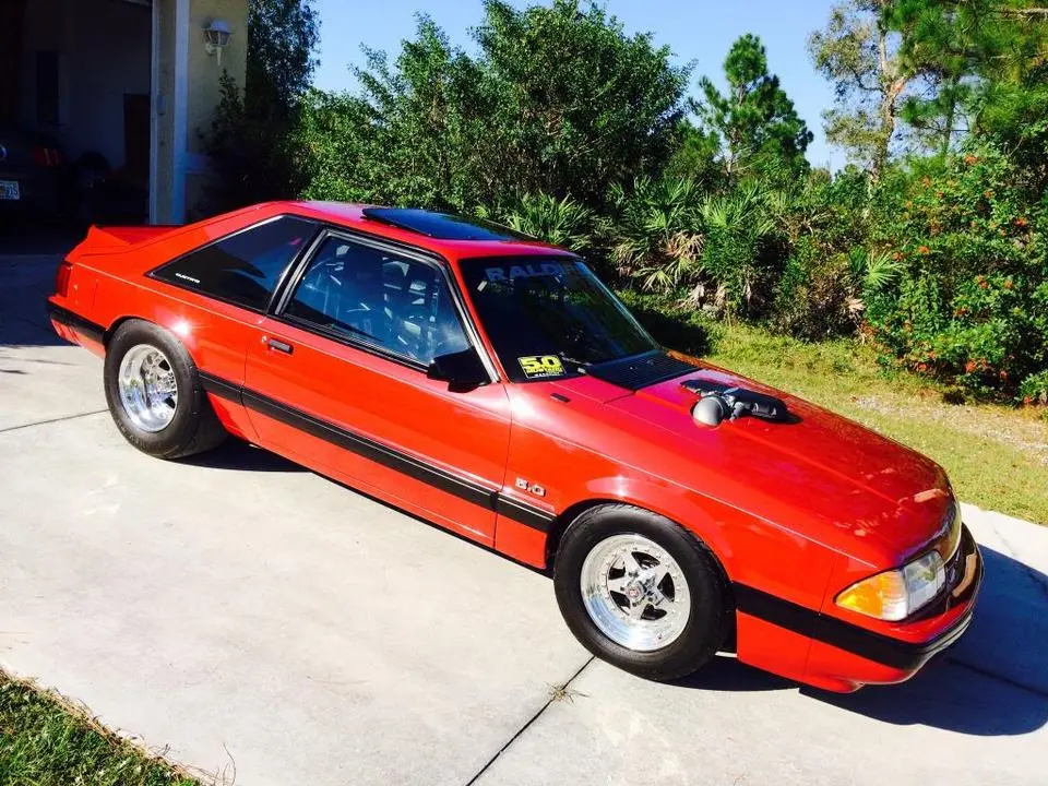

@Sharad I love the stance of your LX. What size are the weld Pro Stars, and suspension work? What brakes are you running?
Thanks! I'm running Holeshot Holestars, 15x4 front and 15x10 rear. Full UPR Pro Series suspension, Strange Pro Race brakes. Here are some articles I wrote about all of that. The combo has changed over the years, so the latest article shows the current combo:
http://www.mustang50magazine.com/te..._sheetmetal_9_inch_housing_rearend/index.html
http://www.mustang50magazine.com/te...ont_suspension_installation_part_5/index.html
http://www.mustang50magazine.com/te...ang_project_shocker_back_to_life/viewall.html
Current stance:
Reactions: stykthyn
@Sharad Thanks! Looks like you mini tubbed it. Dont wanna go that far hahaha. I think ill just stay with the 15x8 Drag wheels and the 17x4.5 on the front. Now i just have to figure out shocks and struts.
I only minitubbed it because I messed up when I ordered the rear end and the wheels. Measurement was off somewhere and the tires were hitting the inner fenderwells. I actually had 275/60-15s on it before I minitubbed it, and it was lowered then.
