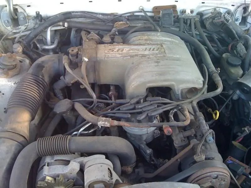

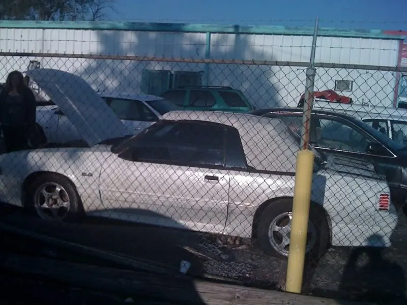

Hey guys, I figured Ill try and update this as we go along. Today, he had the motor turning over just no spark which is a great sign. At least its not seized and we're thinking we can probably keep the stock motor in but may have to pull a few things off the 86 to replace anything thats bad. Hes checking wires and the computer first. Heres a few pics of the beginning. We're taking photos as we go through it. This is Monday, the day I first hauled it over there. 1 of the outside and 1 of the engine. I think its a pretty solid car for a mere $700.
