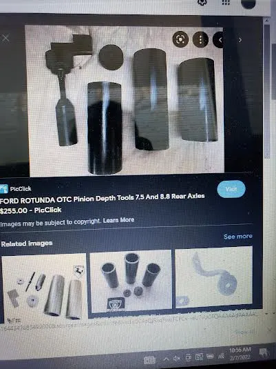

All you need is the pinion depth gauge to set them up correctly so they will not howl
You get the depth set correct first then set the backlash and they will not howl
Unless they are crappy Yukon gears et al. that have a disclaimer for noise

That rotunda set is expensive. Just hog out the old pinion bearings to use for setup and use marking compound. On final assembly be advised the crush sleeve takes around 400 ft pounds to crush. You'll also need an inch pound torque wrench. Not a super hard job but without the rotunda tool it's time consuming.
