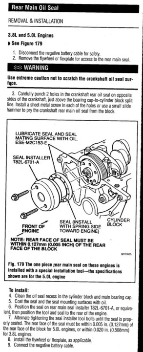

Do you not have to drop the crankshaft any to change the rear main seal on a SBF?
no,you might be thinking about the oil pan it needs to be dropped....

I'm not sure of the year, but i know ALL H.O. engines do NOT require the pan to be dropped to change the rear seal.

Isn't there two different types of seals you can put in it? One is easy and doesn't seal as well, then the other is tough, but seals better? Maybe I'm wrong. Dunno. Never done it before. I chose to let it go until the engine swap. The car made it.

Yeah, the teflon seal is supposed to be a pita to put on....guess I'll find out about that tomorrow when I do mine. luckily my engine is out the car though.
