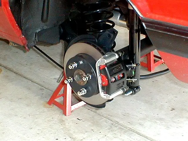

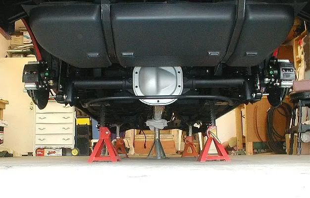

I did the swap on my '89. Pretty much bolt in. Swap in the Mustang axles and use the NorthRaceCar brackets to retain the rear discs. I'm running Eibach Pro Kit springs with no tire rub.
