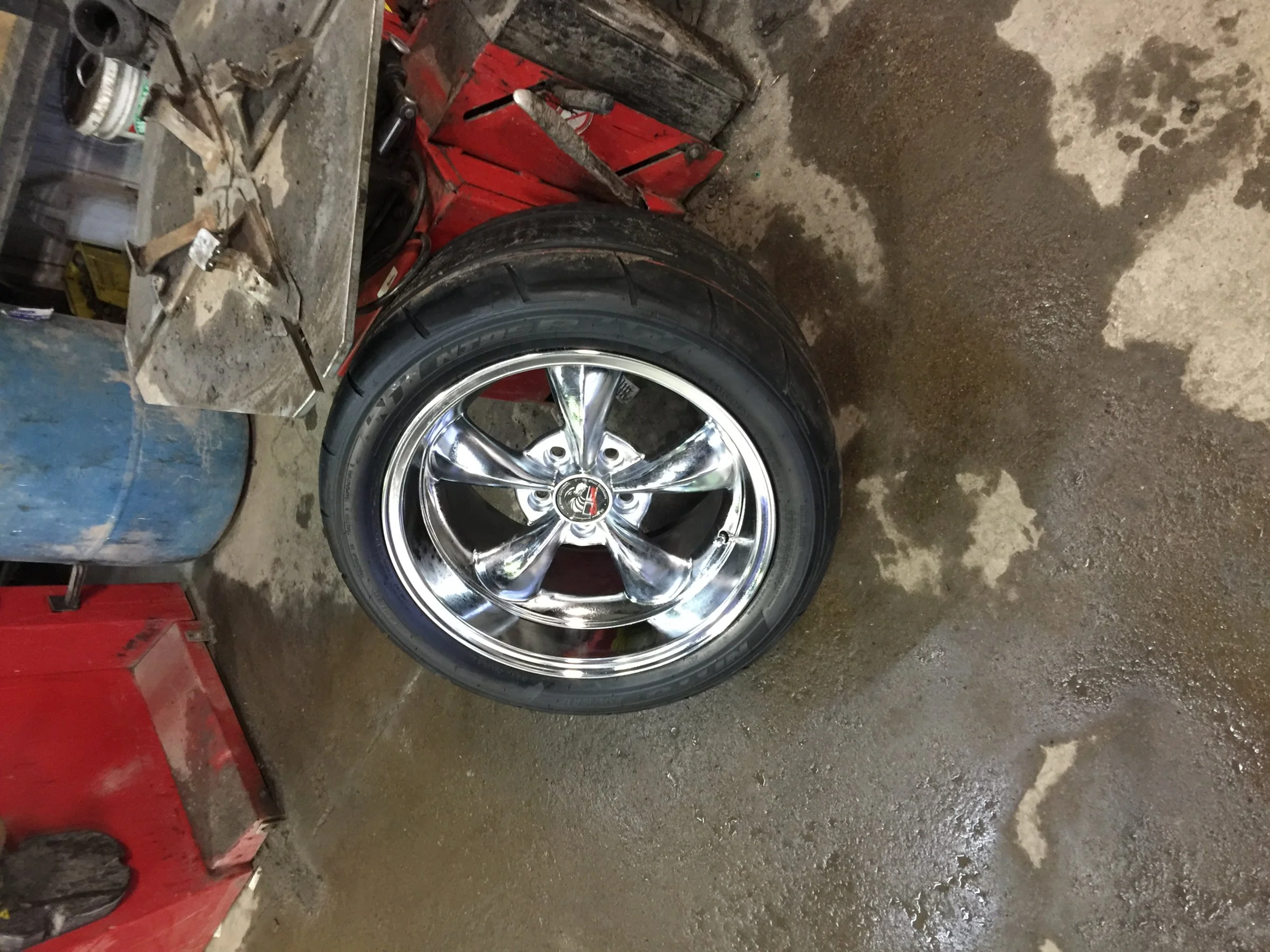

As long as they work well and last fairly long, I'll be satisfied with the wheels. This car doesn't see winter, so I hope they last a while. They are Chinese knock offs after all, 250$ more still makes them the cheapest wheels around by a long shot.

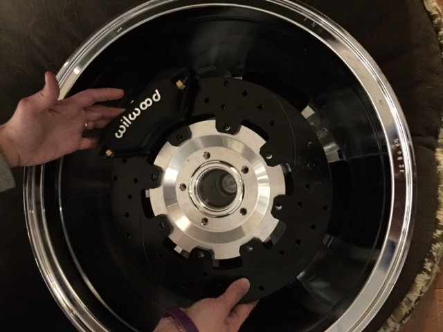

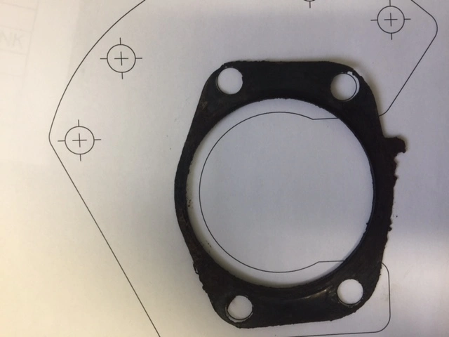

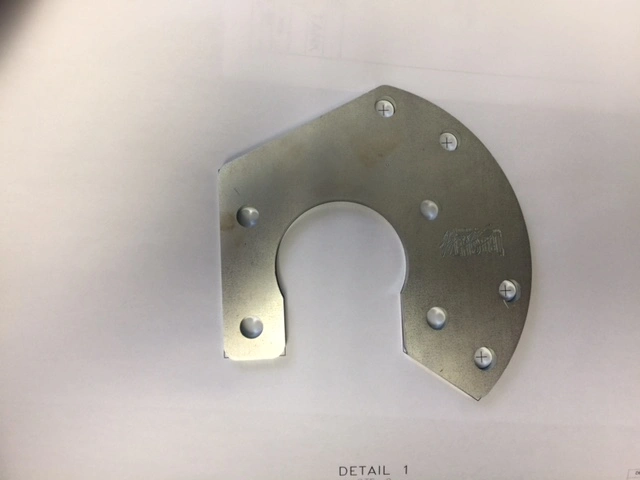

I plan on having new brackets laser cut for the brakes. I deal with laser cutting pretty frequently and I know a place that will do it for pretty cheap in about week. I'll have to do some cad drawing when I start work next week and have them made. I'm expecting it to cost me 10$-20$ a piece.

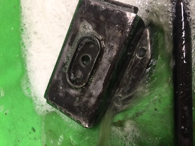

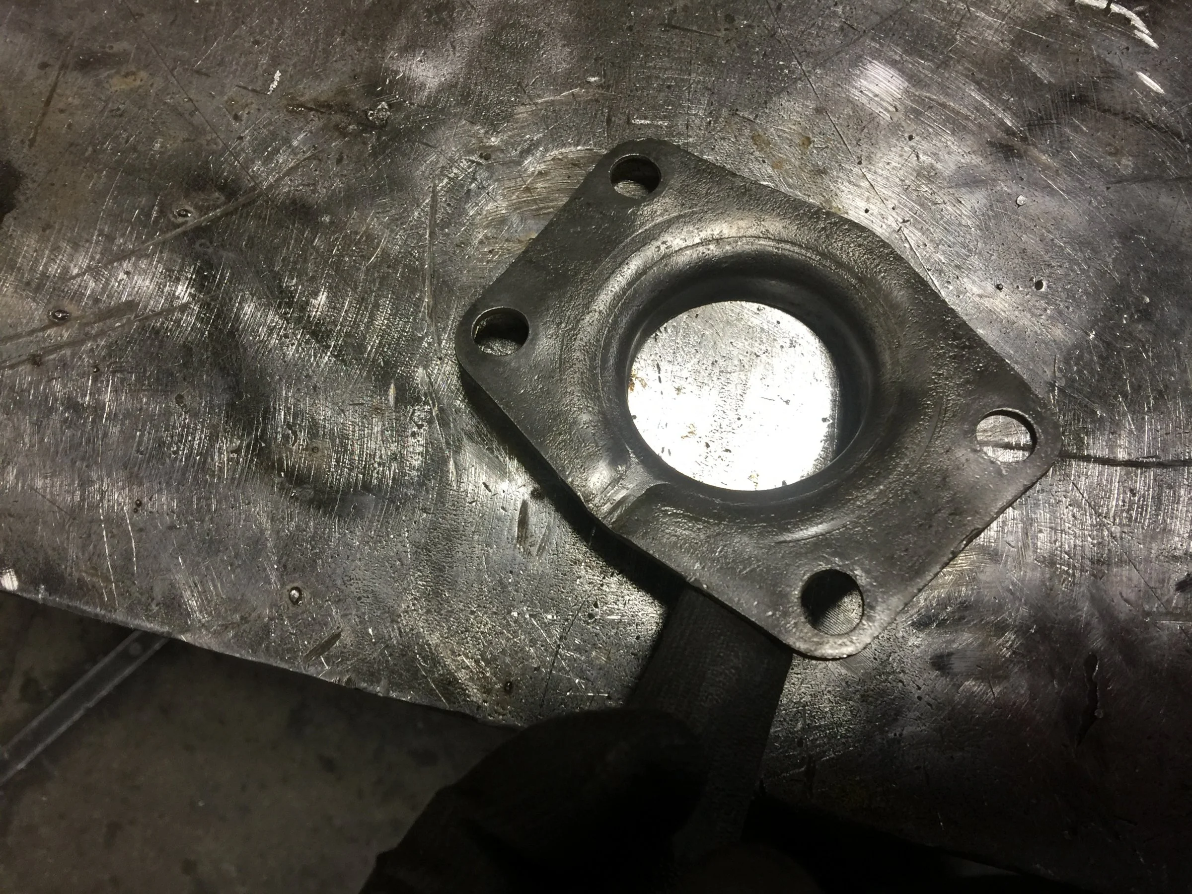

Lowering block Questions.
First off, my heynes manuel doesn't look anything like what I have on my car, is that normal???

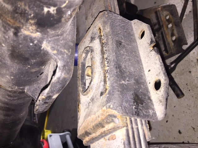

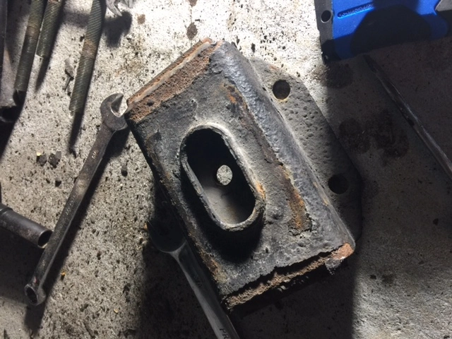

I took apart my U-bolts and I am trying to figure out a good way to lower my car by one inch. I see 3 options.
1. I have a custom pieces made that fit perfectly between these two pieces. Probably cost me 150-300$ for 2 custom blocks at my local machine shop. Aluminium with a recess on one side and a bump on the other to fit the Oblong shape.

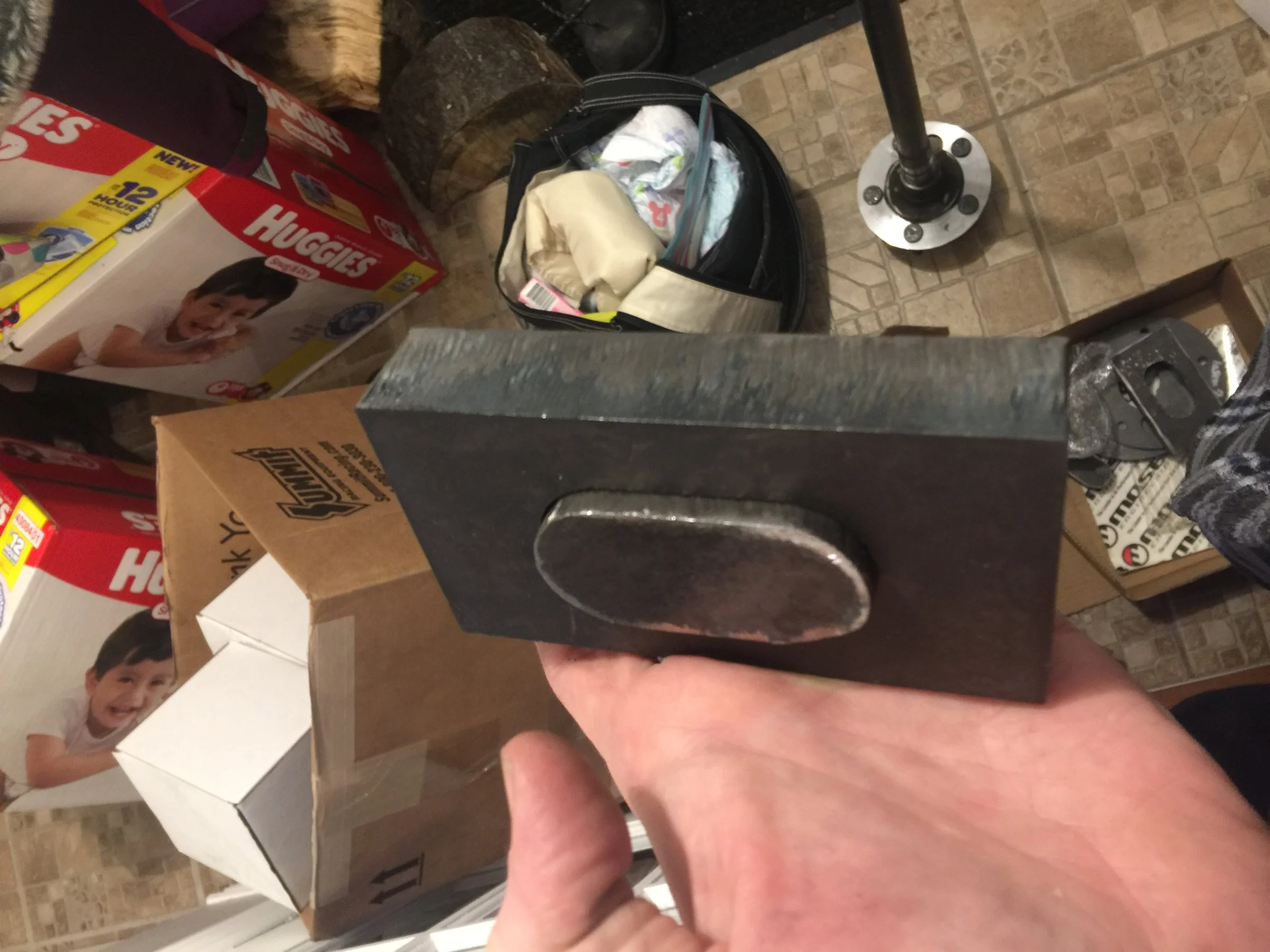

2. I grind down the lump on the piece in the picture below and buy this block from summit:
https://www.summitracing.com/int/parts/aaf-all56130/overview/

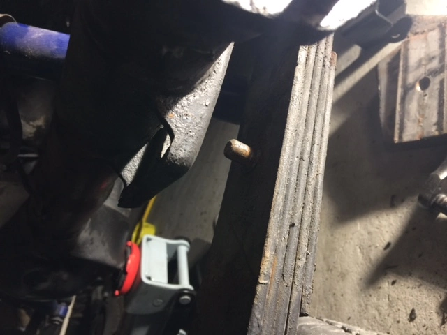

It's dirt cheap, but will it move around on me and do weird things to my suspension and alignment? The pin in 9/16 and the hole in the differential casing is over 1 inch and oblong shape. There would be nothing centering it from underneath ether, just the ubolts and the weight of the car.
3. This is my least favorite, but looks like it's the way people are doing it? Remove the piece that covers the spring and insert that lowering block from summit directly between the leaf spring and the differential casing flange. The aluminium block would be directly impacted from the springs movement and I'm afraid it might break? (Looks kind of week to begin with, extruded aluminium I'm guessing?) That pin in the leaf spring would hold it in place tho. Like in a sandwich between the pieces in this photo:
In option 3, like the next photo, what stops the differential and the whole u-bolt assembly from sliding forward and backwards on the spring say 1 inch in any direction? (The pin from the block has that much play in the differential casing flange hole) Could that mess up my alignment at every bump in the road?
Well I hope I was clear in my question, it's difficult to explain what I want to know, let me know if it is unclear pls. Is there a better way of doing it?
On the IIs, there's an oval shaped hole that has the pin through the middle if I recall correctly. Depending on what time I get up tomorrow, I may or may not be putting my traction bars on my II (Stumpy did an AMAZING job on these, you guys are going to love the pics and write-up in my thread), and if I do, I'll post pics of what the stock setup looks like when I take it apart.

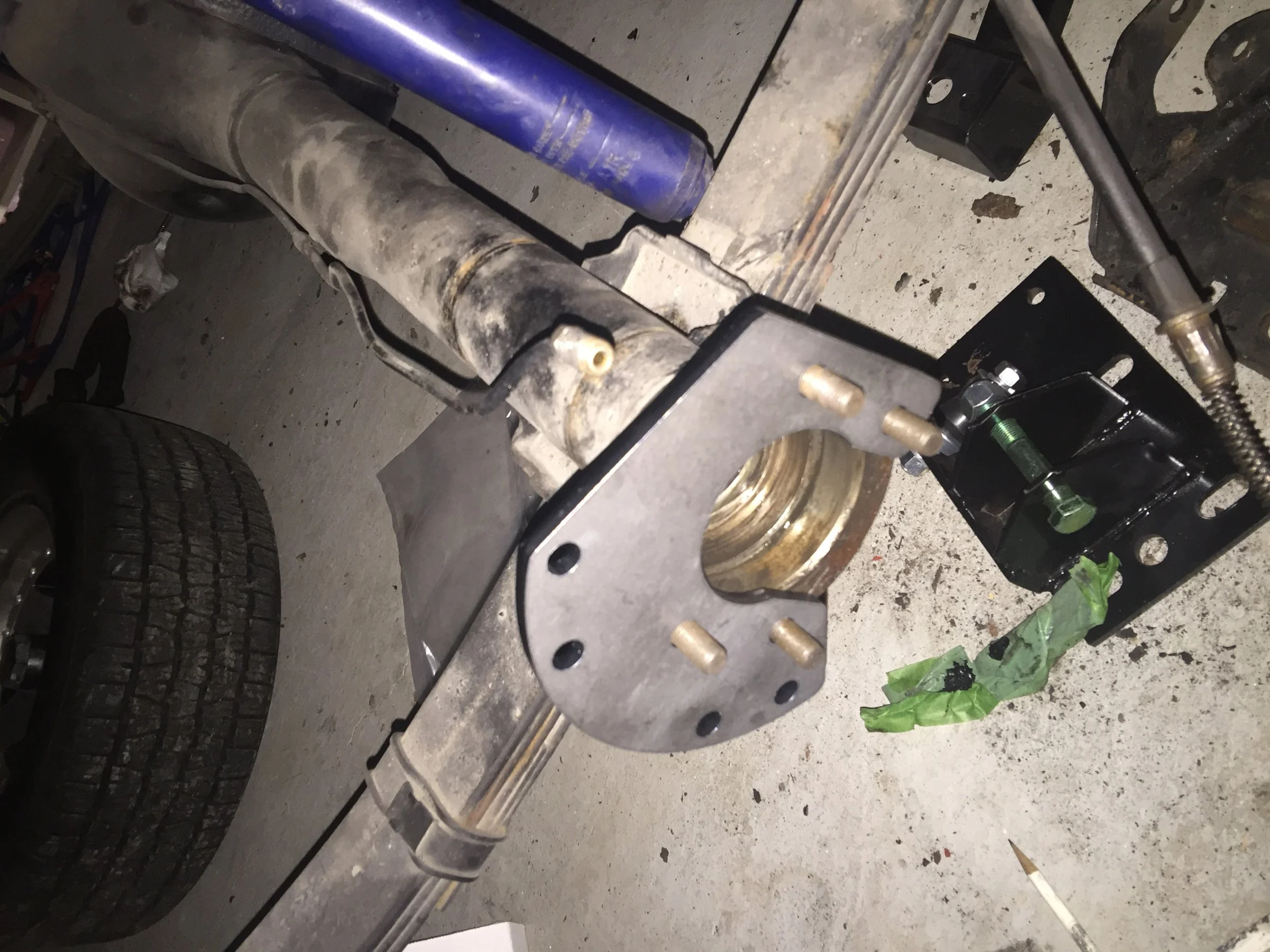

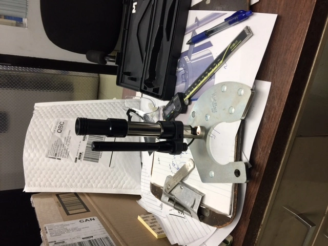

Brakes don't fit.
I'm with @jozsefsz , those brackets could be fixed to fit correctly fairly simply. A good welding shop and/or machine shop could do it if you don't feel comfortable with it.

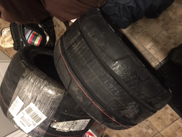

Any suggestions for tires? I want a real sticky tire that does not cost an arm and a leg and is drivable in the rain.
Is this any good: http://www.discounttiredirect.com/d....do&fl=&pc=40527&counter=0&ar=35&rd=18&cs=285
Are drag radials horrible in the rain? How do they perform in a corner?
Drag radials and rain don't mix. Drag radials only carry a D.O.T. number because they meet the minimum requirements for a street tire.
A good sticky tire in the rain would be Hankook Ventus S1 Noble, Firestone Firehawk WideOval A/S, Nexen N'Priz, or tires that are similar that have good water channels. I can warn you that Pirelli PzeroNero's suck horribly in rain, and that Uniroyal Tiger Paw A/S's are good in the rain until you find their limit, and then they become a nightmare (it's like an on/off switch at it's traction limit in the rain).

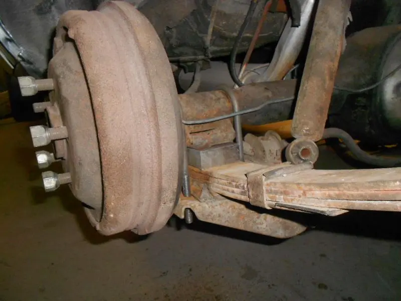

I'm installing the same traction bars from stumpy as well as other stuff. The first 3 pics are from my car, the last one is from the web.
Do you know of a place that make lowering blocks that will fit our cars? If I could just buy some that would be best.
Those types of spacers are as solid as anything. As long as you torque them properly (and make sure your studs don't protrude past the face of the adapter) they're much stronger than the wheel itself and aren't going anywhere. I have the 2" version on my front-end. I get more worried about the 2-piece spacers (I have those in the back) than these adapters and those have never given me a problem either. With any adapter, a hub-centric design (vs. the lug-centric design that these are) gives you less chance of misalignment or balance issues. It might be worth your time to measure the hub and look for a hub-centric spacer. If not available then a lug-centric should work just fine -- as I mention I've never had a problem but your mileage may vary.

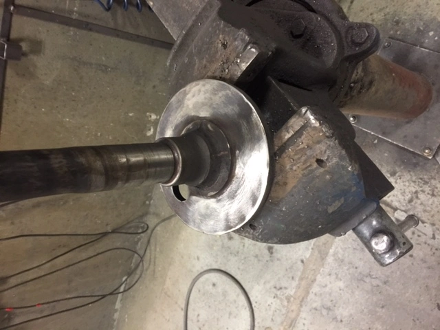

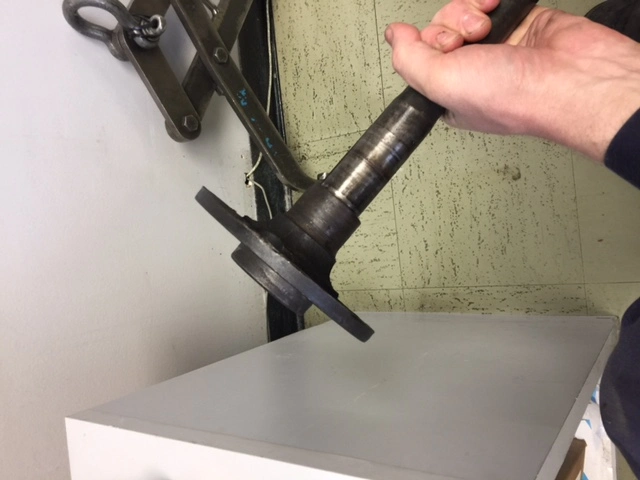

I looked into it a little bit. Hub centric would basically mean modifying just about every piece. The disc is 2.75, the axle is 2.5, the wheel is 70.5mm and the only hubcentric spacers I found in my dimensions are something else. I would need to remachine the axles and press on a 70.5mm od sleeve, then turn the disc to fit. Then make a custom spacer.
The wholes on the discs are rly tight on the studs and every other nut is conical, so I am going the easy (lug centric) route for now. I'm keeping the hubcentric idea as plan b. If I can find a hub spacer to match my 2.75 ID discs to my 2.5 OD axle, I would do that in a heart beat. Any suggestions were to find that?

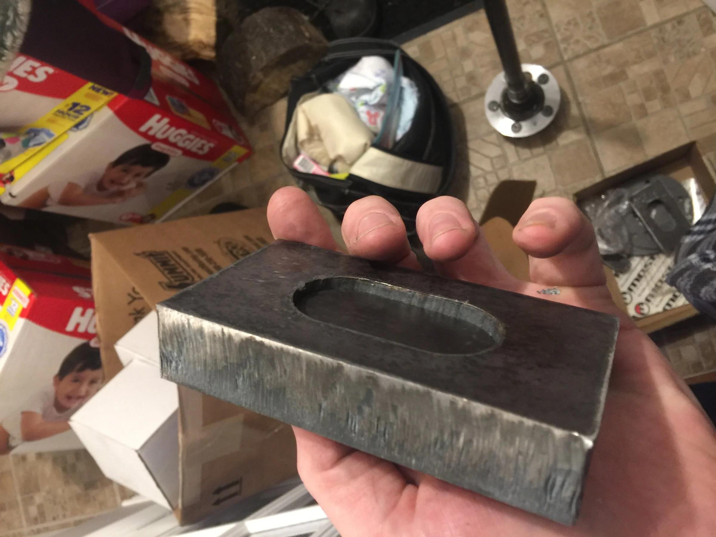

I think I have come up with a cheap way to make a better lowering block than what's on the market. My favorite are the walsh spacers, but you need to remove the piece that goes over the spring. That piece hugs the leaf spring and is guided by a pin. I think it is designed to align the lower plate with the spring via those u-bolt holes. I might just be overthinking it, but I don't want to make my suspension sloppier, I want everything nice and tight. I'll make some drawings next week and post them on here.
