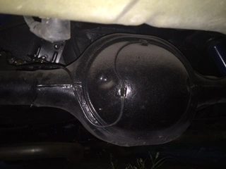

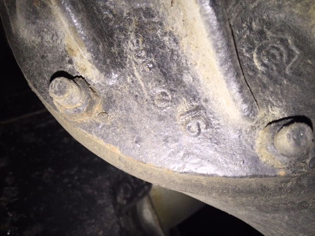

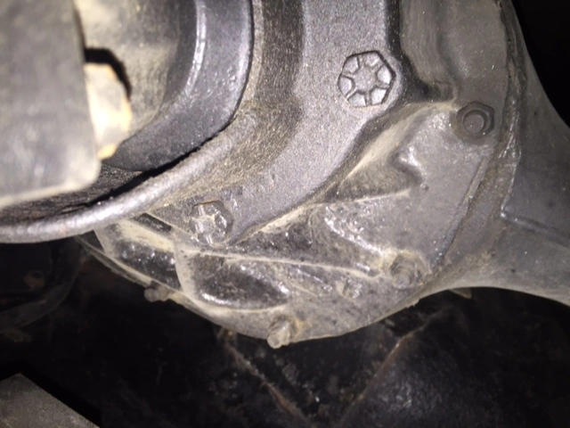

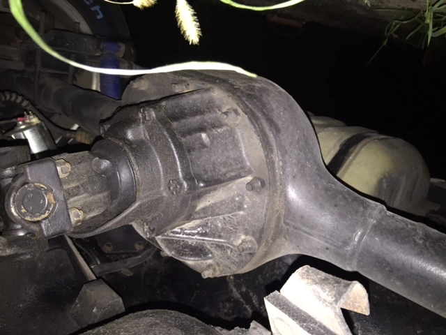

I took a few pics of the diff. I was also given some spear gears to go in it. Non locked ones. He said that the diff in the car was a 8.8 locking diff and that he bought it 1200$. He could of just been covering up a broken diff, I am not familiar enough to tell if it is working right. I can turn the steering wheel 3/4 of a full turn with no problem, passed that, it will not want to turn anymore. (Tire start screeching, slows the car way down).
I didn't see any numbers on the differential, were should I look?

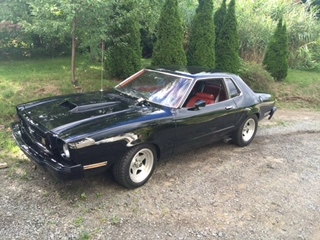

This picture is just me bragging about my new toy.

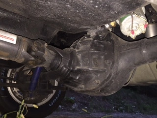

This is the diff from the rear of the car

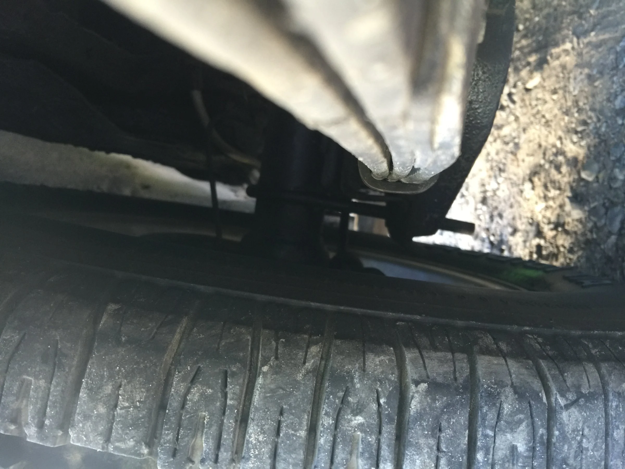

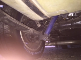

Left rear suspension viewed from the rear of the car

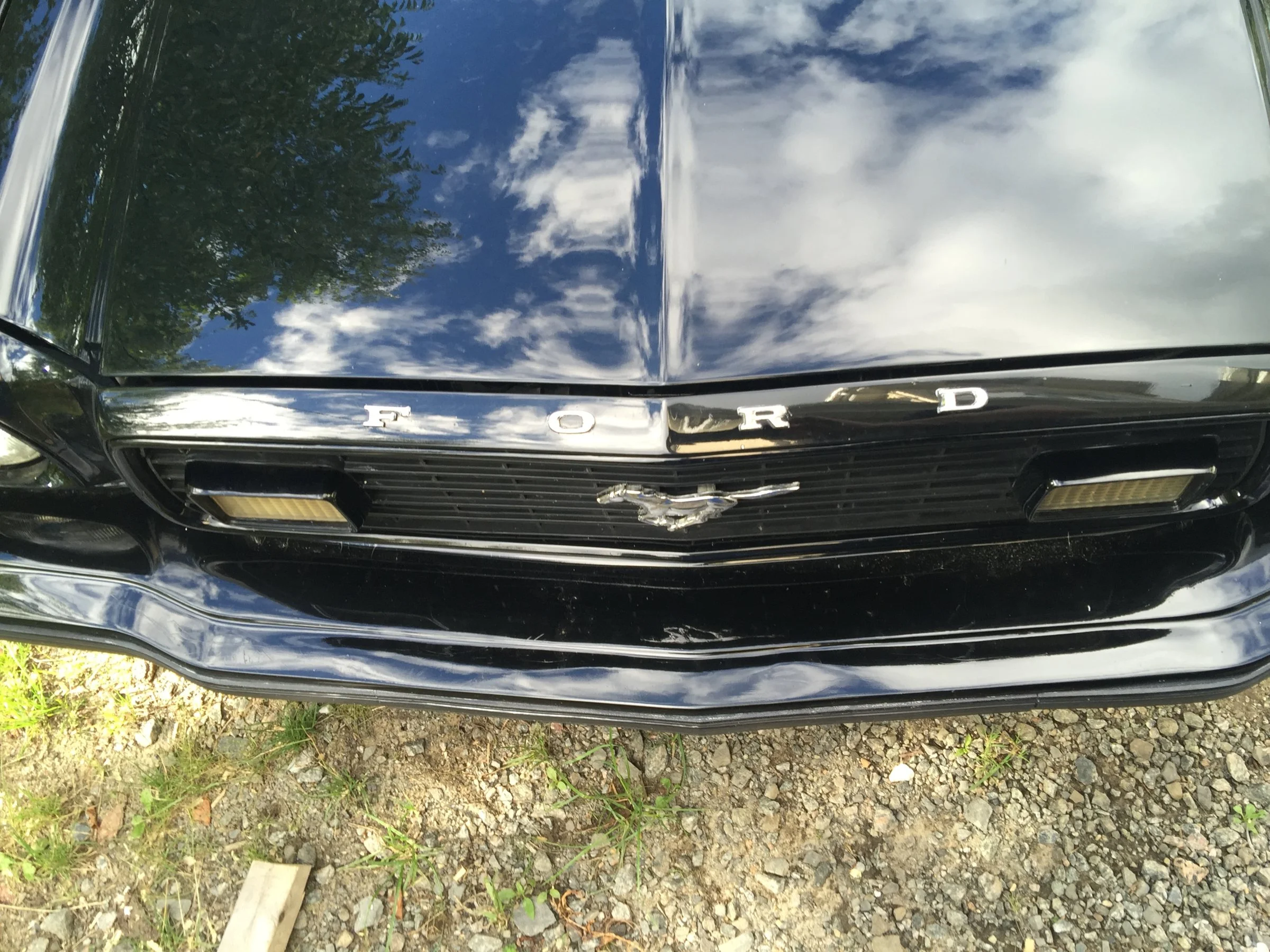

First time I see the gas pump...
Again, showing off, I think you guys can relate.
BTW I payed 7k Canadian for this thing, does that sound like a fair price? (5400 US approx)

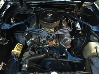

I need to replace the electric fan, the stock one was added temporarely.

That diff appears to be a 9" (unless I'm mistaken, 8" diffs didn't have the vertical ribs yours has, haven't looked at mine in awhile, though I will probably be under it this weekend), DEFINITELY, not an 8.8" in any way, shape form or fashion. The rear suspension you've got is stock.
At $5400US, that's a clean II.
Yeah, it's an 8", probably stock to the car although the gearing may have been changed. They are supposed to have a tag attached at one of the nuts holding the carrier into the housing. If it's missing, it's a good indication that it has been tampered with. By what you have said, my guess is someone probably put a spool in it. It's a cheap way to have both wheels spin while doing a burnout and helps with traction at a drag strip, but really makes the car undriveable under normal circumstances. You can get a rough idea of what gears it has by jacking the rear of the car into the air, marking the driveshaft, turn the wheels one revolution and count the revolutions of the driveshaft. Then you will at least have a good idea what ratio you have.
As for the Detroit rear staying locked while parked, I am pretty sure it is but I could be wrong. The way you describe your car doesn't sound like my Locker rear though. When my car turns, sometimes it will give a loud distinctive clunk when it disengages. That is where the Lockers aren't necessarily friendly on the street - many don't like that clunk. It doesn't sound like your car releases at all which is why I think someone installed a spool. If that is the case, and you don't mind the gear ratio, it really isn't that hard to put an open differential - or even a locker - into your housing. Your pinion depth is the big deal to set and that is already done. As for installing the ring gear, the hardest part is getting the contact patch right when testing your gear engagement. The good thing about 8"/9" rears is that can all be done on the bench. All you would really need is some spotting ink. There are a whole lot of installation write-ups out there to help you along. Here's one from mustangandfords.com, you can pick and choose where to begin and end.

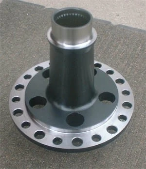

Just a couple of pics for reference.....
A spool:
A limited slip style differential, this one is a Ford Trac-Loc:

I did find out my carb was a holley 4780 with its choke tower grinded off.
4 to 1 style Exhaust headers have long 1 inch runners and couple to a 2 1/2 inch exhaust on each side. This feels appropriate for 350whp doesn't it?
My intake manifold is a Edelbrock performer 289. Not sure this will push the engin to 350rwhp?

My wheels are American Racing 15 x 7, 4 bolt wheels.
Front tires are 205/50R15 and there is litterally no room to grow.
Rear wheels are 225/60R15 and looks like they could be an inch wider. I keep reading that this size should rub, but look at the picture.
