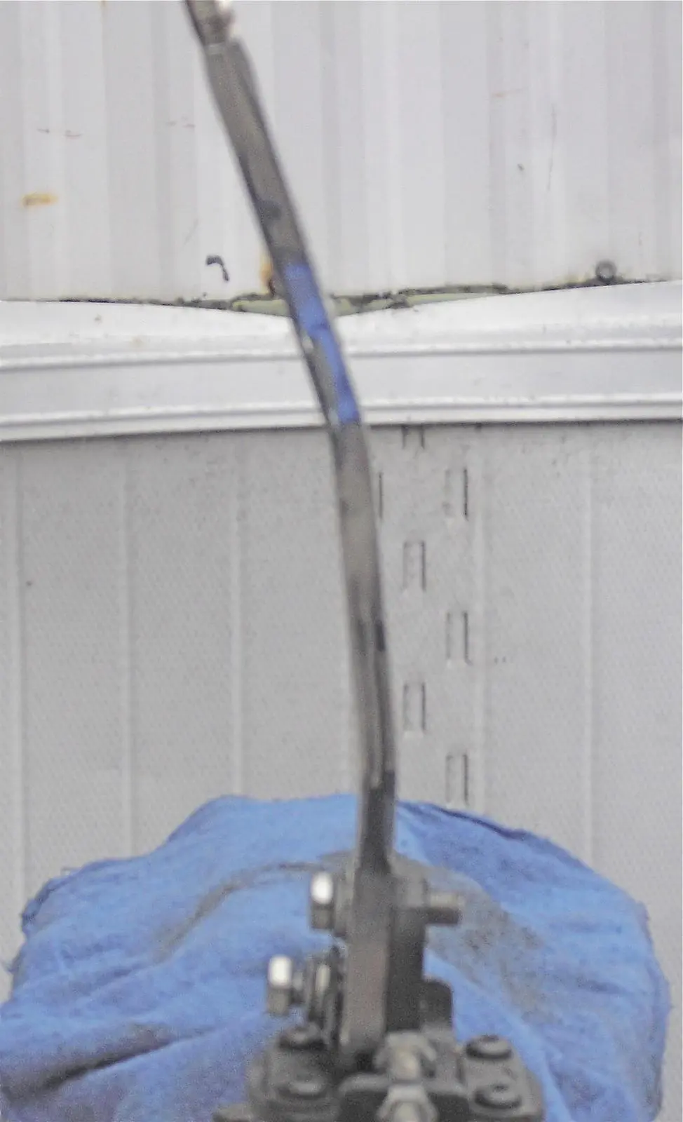

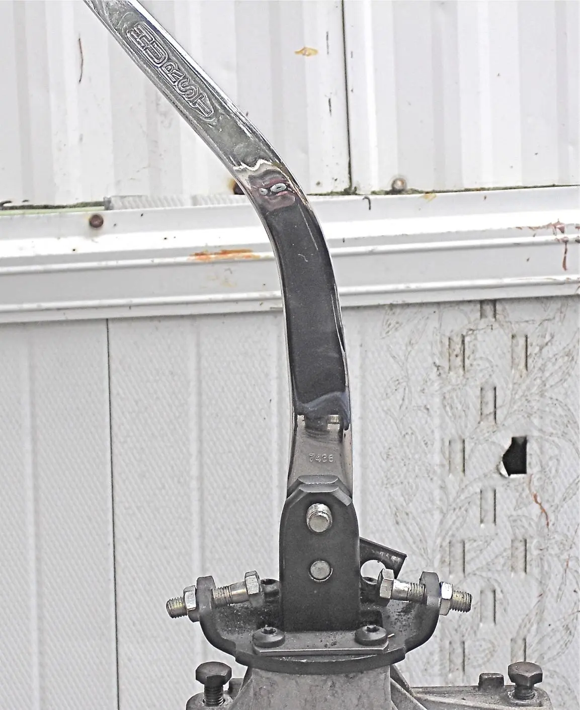

I just mocked up the new and old handles to see how it might work. I'll let you decide.
