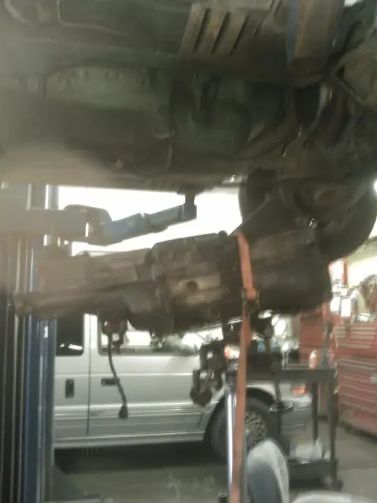

My automatic transmission just went out, again. This one I put 15,000 miles on before it went out...Im tired of buying automatic transmissions so I figured I would swap it over to a t5!
I Landed myself a 93 off craigslist for only $300 and started tearing off parts!

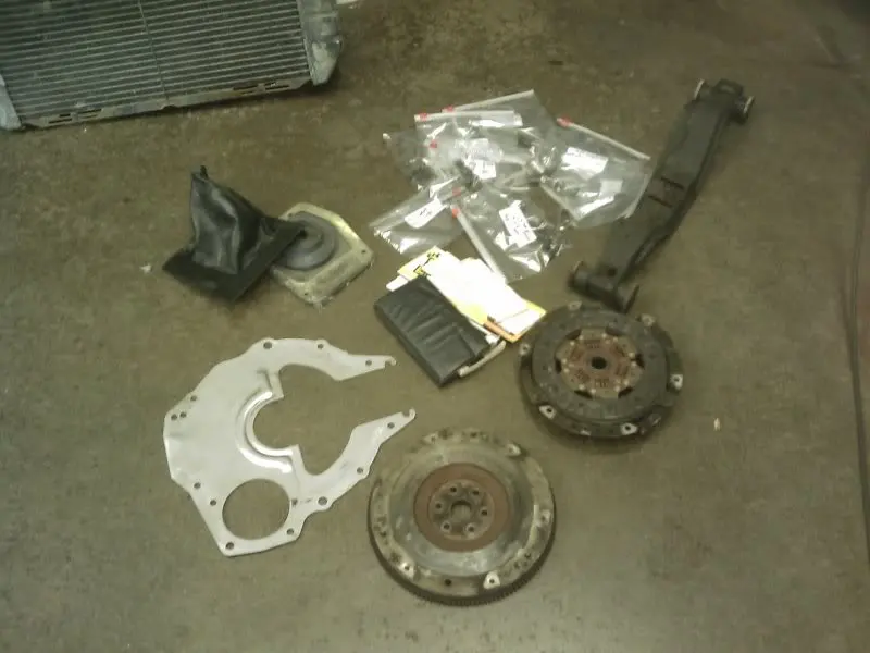

I'm using this as a guide to do the swap! Have everything minus the clutch pedal assembly that I'm waiting for on ebay!

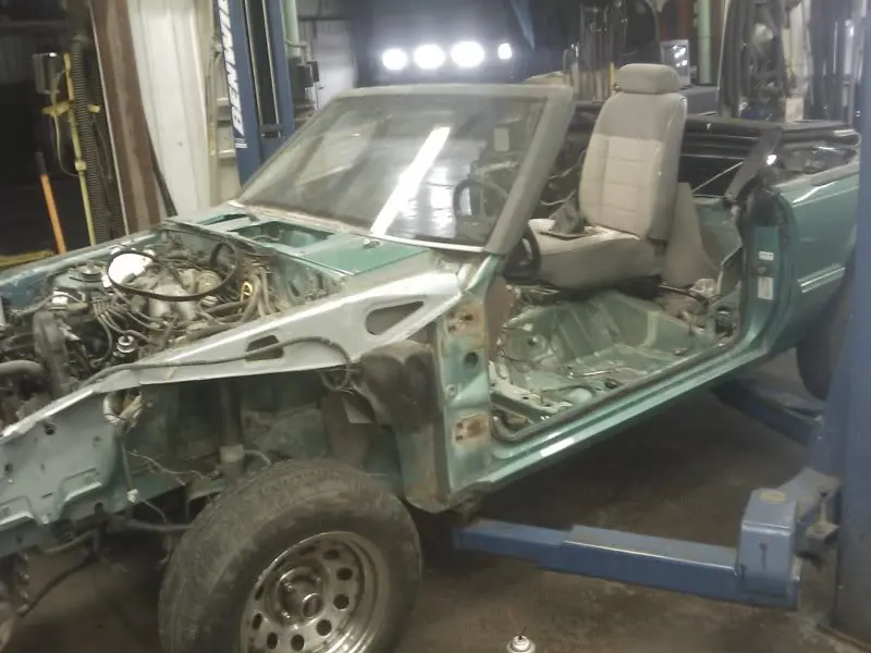

My donor car I snagged:

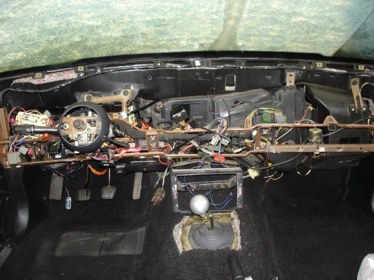

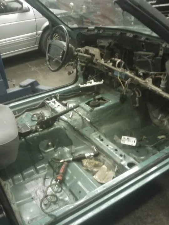

But trying to get the pedal assembly out of the car is proving to be much more difficult than the guide showed....
And this is with the dash and everything stripped out of the vehicle...
Not sure how im going to pull it off on MY car with all that still in.
Any tips?
When i swapped my pedals in, i took the dash off, dropped the column out and installed the pedals in from the TOP.
Also, when you unbolt the booster, pull it forward a little so the studs are out of the way.
Pedals were the toughest part, and taking the seat and dash off made it a little easier for me. Also makes hooking the clutch cable up, running the speedo through the new hole and finding the clutch NSS plugs in the corner much easier.
After the pedals and cable go in...everything else is peice of cake.

When I do this on my car do I have to take the entire dash out, passanger and driver side? Or does just the drivers side come out by itself?
Im at the shop right now and lowered the steering column to the floor on the junk car and pulled it out the top, after bending all kinds of crap out of the way...hopefully I learned from this and going in will be easier. :nonono:
to take the dash out of a Fox, you gotta take the center console out first, then the gauge pod and gauges. Then the entire dash comes out in 1 peice with a million screws.
If you remove the seat, and drop (or remove) the steering column, you should be able to get the pedals out. Remove the lower dash trim near the driver's knees. You'll also need extensions and universals.
I'm familiar with removing dashes in the Fox, so for me it was an hour of work to get the dash off...then the fun stuff.

Alrighty. So dash, seat, and steering column.
I shouldnt have to mess with the frame and stuff under the dash?
I feel confident I can take the dash out and get it back in, But if I have to start taking the metal frame and stuff out under the dash and unclipping wiring harnesses from it and moving stuff around I'm going to start to panic that im not going to get it all back the way it was!
Doing the swap soon here too. I have the pedals in, not too hard once you get the crap out of your way. Just pull the steering colum out, then take the nuts out that connect the brake booster to the body of the car, then a few more obvious ones and out you come! I need to re-route the speedo cable too, probally swap it for the one from my doner car. I can't wait, just a big task to do on your back.
Well I got it all apart and put back in there, I managed to wiggle it all apart only taking the bottom part of the dashboard apart. Didn't have to take it completely apart!
Well, actually I have the pedal assembly all bolted in and hooked up, I still have to assemble the bottom of the dash, but the hardest part is over!
