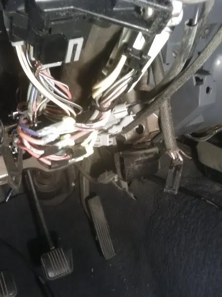

So I'm almost done putting it back togeather, and...I cant for the life of me figure out where this plug goes!
Im about to just turn the car on and see what doesnt work. *sigh*
That plug to the far right hagging is not what he is talking about. from that picture, you cant see them
I know thats not the one he is talking about, but I still cant for the life of me, figure out what that plug hanging down is suppose to go to...I think I disconnected it when I took the steering wheel out...dont think it was just loose in there before...
So anywher, I just tried to start my car...I assumed that since I had the clutch pedal in the car, I would have to push it in to start the car because of the saftly switch....
But my car still starts with the clutch not depressed.
There was only one saftly switch on the clutch pedal assembley right?
The one with the little plunger on it?
If your talking about the grey connector hanging by the gas pedal. It looks like the one for the Cruise control shutoff when the clutch pedal is pushed down.
Two plugs for the Clutch saftey switch. Black one is for the starter relay trigger. White or Grey plug will be for the In Gear or In Nuetral signal to the EEC. If the black one has the jumper in it. It will start with out the clutch down.

I was talking about the black connector hanging down on the right side of that picture. I figured out where it went, it went on the top of the steering column, right next to the cable that stops you from taking it out of gear with the key not in the ignition.
So...thats solved.

The actual CPS is right above the clutch pedal.
Just put a jumper in the White plug also. Till you get it sorted out. This will make the EEC think its in neutral all the time, and won't cause any idle issues.
What happens If I just leave the jumper in there? Why does it matter if the EEC knows its in neutral?
Will it harm the car to drive it that way for a while? This is the car I drive daily to college and work.
Posted via Mobile Device
Won't harm the car at all to install a jumper in the white plug. The ECM has different Timing and fuel requirements for when the car is in gear. So when you are at idle, and the ECM thinks the car is in gear, it will cause idle problems, mostly surging. Thus the reason why its better to force a permanent"In Neutral" state, to eliminate that.
If you need a jumper, a blade fuse fits in there perfectly. A small band of electrical tape and it's not going anywhere.
That's how i have mine setup now because my clutch safety switch is bad and I can't for the life of me figure out how to remove it from the pedal to replace it :(
Awesome! Thanks! A fuse with duck tape is what I will do! Good to know it wont cause problems!

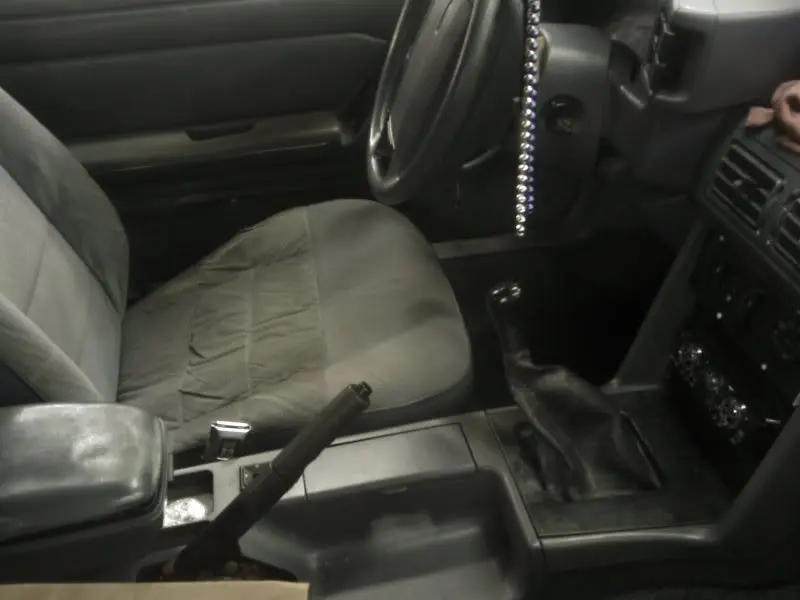

One week later and I am FINISHED!!!
:nice:
I had to do a little fabricating and cutting, and use a little RTV to get the weather boot to seal down around the shifter...but, its all sealed off, and you can even tell with all the trim back in place!!
Works like a charm!
