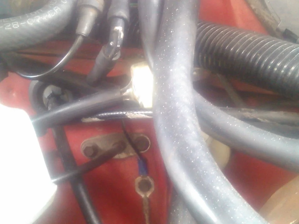

I have a 91 LX auto and I have a complete t5 swap kit coming soon. I read that the speedo cable has to be re routed out of the normal clutch cable hole. I see no other firewall holes to route my speedo and amp wire through. Should I just drill a new 1" hole in the firewall? Its not exactly an easy place to drill a hole that big without removing all the vacuum lines attached to the FW.
I did a swap in a 95 about 12 years ago and don't remember this problem. I've googled everywhere and see no pics of a re route location. Anyone have a picture to post of a swap location of that speedo cable re route?
There is a rubber plug to the left of the cable, if viewed from the engine compartment. That is where you move the speedometer cable to. I converted mine to T5, the second car that I have done.
Yep, its kind of a PITA as you have to do it from under the dash. You need to remove the rubber plug/grommet from the hole that is inboard of the speedo cable. That is where the speed cable will go. Then the clutch cable goes through the old speedo cable hole. Make sure you fasten the clutch cable to the inner frame to keep it from touching the headers and to decrease binding.
You will have an interesting time feeding the cable through the hole. I recommend that you use some sort of flexible cable inserted from the engine compartment for a fish cable. Watch/feel for the end as it comes through the firewall. If you have an old bicycle handbrake cable, that would be my first choice. Once the fish cable is in hand, tie or tape the speedo cable to the end of the fish cable in the engine compartment and pull it through.
