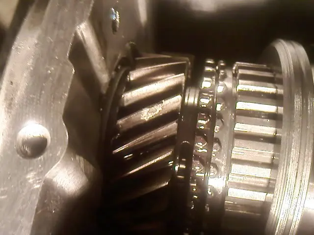

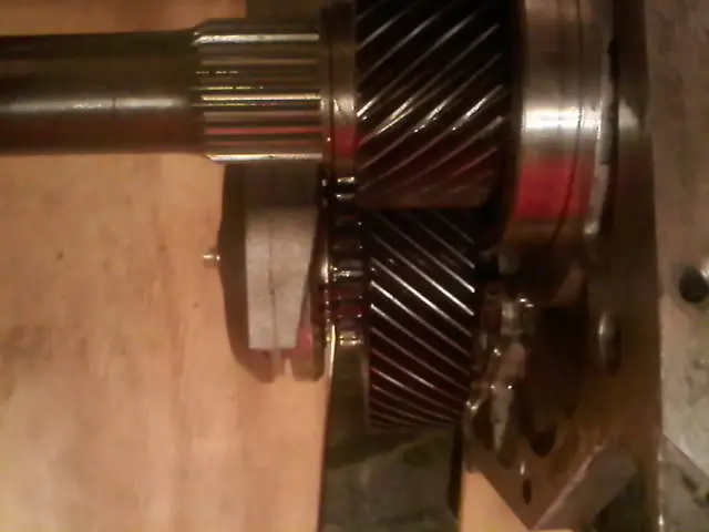

Alright so for the last two or more hours me and two buddy's tried putting this damn tail shaft on. The thing sticks up about an inch from the bottom and won't go any further. We all believe its hitting the rod that i took a picture of. i'm pretty sure its 5th gear but not certain. It doesn't look like the rod itself is centered in the hole that it comes out of. If anyone knows what i'm doing wrong i would appreciate the insight.
thanks, here are the pics of the rod and the part that its suppose to sit in.
Oh and i dabbed the rod with grease to see if it was aligning up and it does not.

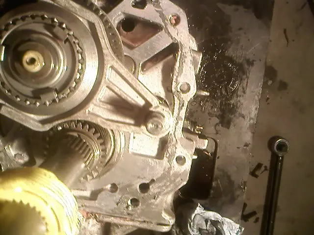

i swear i'm the only one that runs into these types of problems. i search throughout the internet and haven't found anyone that had this problem. The last time i took the tailshaft off, it popped right back on. Now i've struggle with it for mutiple hours.
Anyone that knows T5's or has taken one apart; i need to know if that rod can move side to side, not up and down when you set the trans facing down with the input shaft facing the floor?

haha, this happened to me on one of my first trannies that I did, and it took me hours and hours of cursing and screaming. In fact, the first time it happened, I started wacking it with a ****ing sledge (I just didn't care at that point.) I dropped the trans on the floor and walked away for an entire year.
So what is happening is that it's going on, but stops with about an inch left...
what is happening, is that when you are shoving the tail on, you're hitting fifth, and bumping it, causing the gear to slide inwards slightly toward the front of the trans.
5th has to be in the exact position, or it won't go on right.
grab fifth gear and pull out on it, out towards the back of the trans. It should pop out and click..regardless it needs to come out further in it's travel just slightly. Once you do this, the tail will slide all the way on with ease.

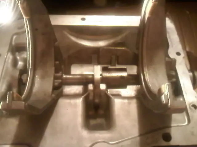

the lid needs to go on first.
put the plates in the neutral position on the lid...so that the bar on the plates is between the spaces in the fork plate fingers, if that makes sense. Then, make sure the hole is on top, and slide the lid on from an angle. Then you're good to go on the tail

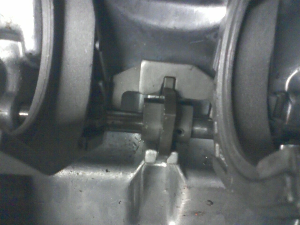

this is where i'm at

Your plates are all wrong. For lack of def, I'll use laymens terms. I'll call the thing in the middle the horse shoe. I forget what the thing with the bar is called that is on the rod, but what you need to do is to slip that deal with the bar into the horse shoe so that the bar points up, and it's base slips neatly between the horse shoe. then you need that bar to point up, and center it between the gaps in both interlock plates. Does this make sense?? I can see if I can take a pic later on.
as for neutral, the slider will be in the center position of it's travel. the input shaft will spin indepently of the output shaft. you can grab the input and output and spin each the opposite way

like this right?
do the syncros look like there in neutral?
i saw this too. my trans never grind at all, and shift smoothly so i'm def not ready to start tearing into it.
so i should be able to line it up the way it is and leave the pin hole facing up and it should be good?
i'm mock it up and try cuz i think i did and the bolt holes wouldn't line up and in order to line them up the rod had to shift forward or something.

Here is a shot how you need to set up your lid
Here is a shot of a rebuild job I did less than 2k on it, with nitrous and powershifts on several sticky tire launches..lol. Told the dude no powershifting
this is how it looks with the sliders in neutral

i think i did it with your help. third feels a little weird going in and coming out but i hope its fine.
time to rtv it and play some COD. Man you just made my night. i can rest easily now.

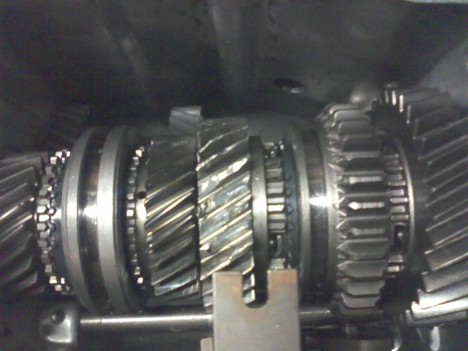

looks like the 3/4 slider on the left needs to come over to the right a tad if I see right.
that chipped tooth won't effect gears grinding...If I was rebuilding a trans, I would replace that, but its up to you. that is attached to the input shaft, so it's easy to replace, just pull the bearing retainer off and slide it out.
worst case scenario, it could chew up the cluster shaft on the bottom too. You may be ok for a while though, it's hard to tell by your picture

You can tell if third is working, just slide the slider over, and it should lock third into place...and the input and output shaft will be locked.
