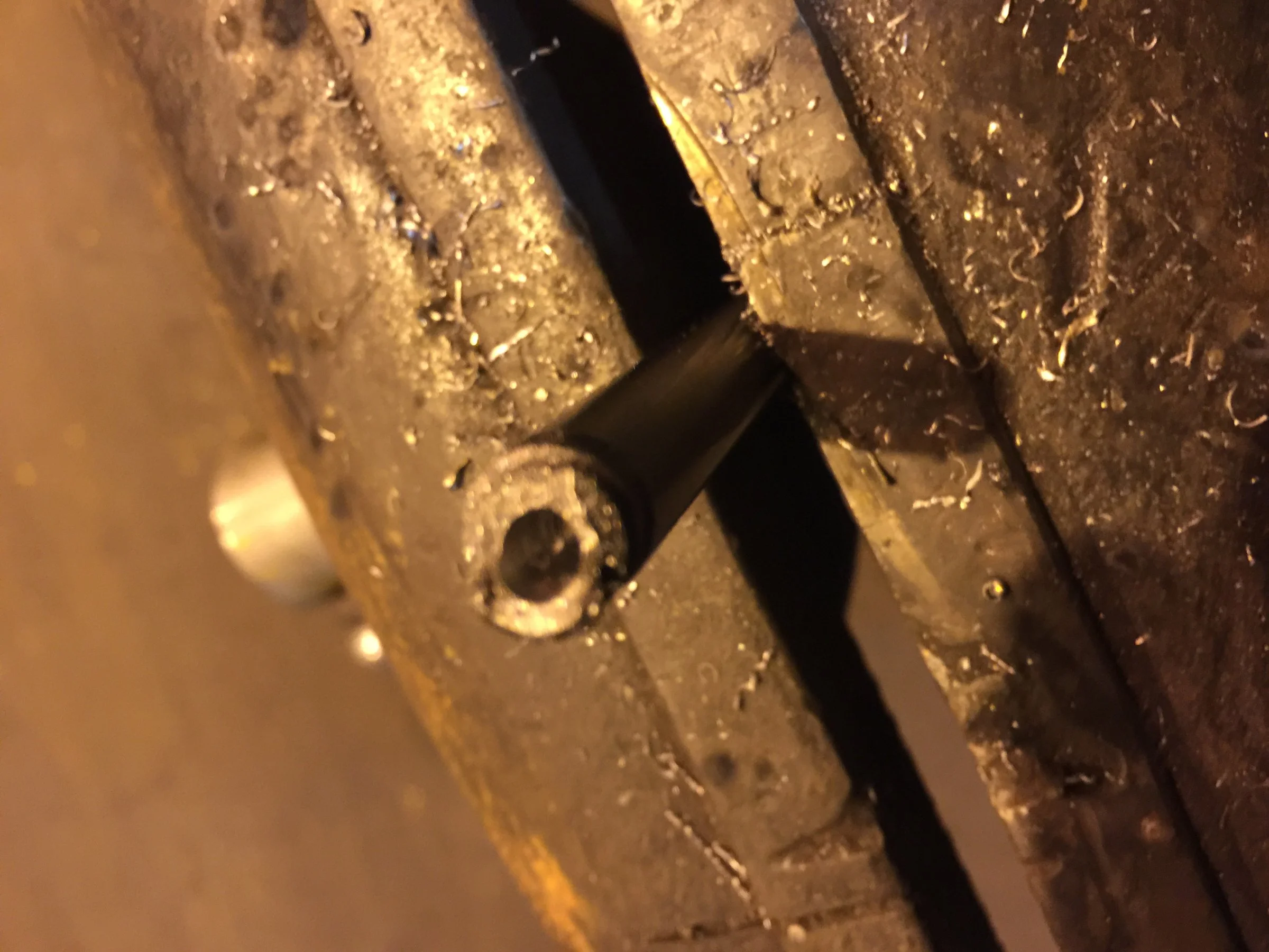

Ooooohhh...
That's the part that screws into the block. Did you get the other part out? or is it still tight?
Can you just imagine the sht fit I'd be having if that happened to me?
That would leave me wondering about the torque wrench......or The fact that you could never get those to reach 80 lbs,..probably means that they were stretching.
Chinee?

It should come right out as there's nothing putting force on them now. We will see in a couple hours. I've been using the same torque wrench forever, but I've got a new one in the box I bought about a month ago. Think I'll break it out just to eliminate that.
Who knows what ARP will say
It does not.

tannerc91gt said:
It does not.
Yeah,..I kinda figured that would happen,..I'd imagine that there is still some twisting that is occurring when you are torqueing that stud, making it tighter in the thread boss
If the same thing had happened to me, I'd be screwed,..as I had to thread seal at least 4 of them, and all of them were tightened into the bores w/ the allen wrench socket head that is in the top of the stud.
Would have hoped that would have relieved when the bolt broke. It's about 1.5" down in the block now. I was able to twist it out a bit but it locked up. The top of the stud is a little mangled and it was starting to dig into the bore. I'll grab an ez-out and try again in a few days. Almost makes me regret not going Chinese to begin with!
How will you be able to drill a 180,000 p.s.i hardened head stud to use an EZ out?
I've already drilled a small hole in it. With the right bit it isn't a big deal apparently (it should be though). Snapped a standard bit though. Now if I break off the EZ out, then you've got the whole creek no paddle situation

RaggedGT said:
Could you weld a nut on it?
No sir, too far down in the block. I've got an exhaust bolt to do that with next though

Well it's drillable. Got some left handed bits to try out when I get off work on the morning. I'm not optimistic though, it feels like its bound up pretty good. Open to suggestions short of tearing it down to the block and taking it somewhere.

Boosted92LX said:
Hey man.. I've removed a lot of broken bolts. Can you get me some pics of the culprit? Maybe I could help.
Absolutely. Itll be a couple days before I'm
Able to make another attempt but I've got a couple LH drill bits I'm going to try. I'll get a picture
