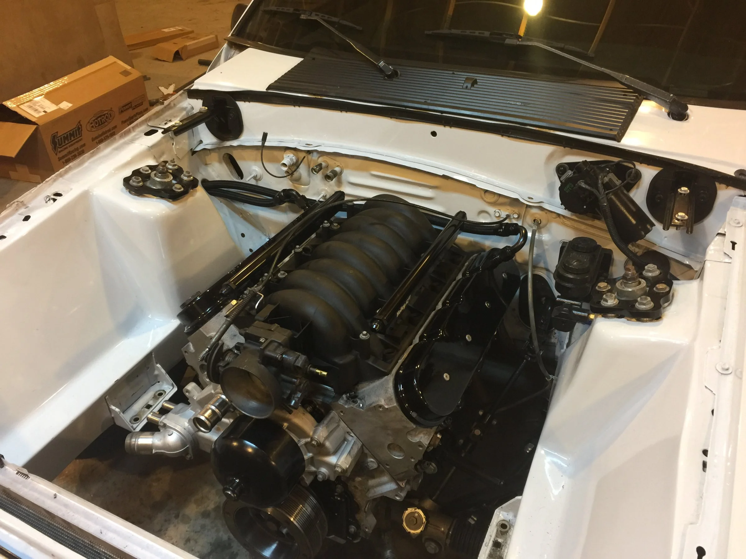

I painted the stock timing cover, reinstalled the balancer and it's finally ready to be set in the car "for good". I'll have to pull the pan and put a drain fitting in but I can procrastinate that a while.
If I can ever get around to putting the rear end together I'll be able to put the wheels back on it and move it out of the way.

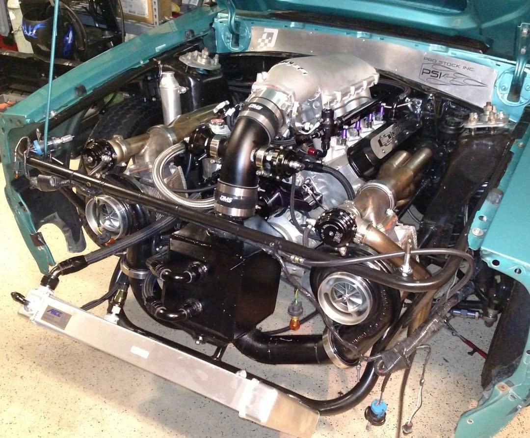

So a buddy of mine has a blazer with a build very very similar to what I'm doing. In fact, it's partly the inspiration behind the combo. It's an L33 with twin s366s, th400. Went 8.53 in a 3600lb blazer. Bad as can be.
Made 1159 today on the dyno. Legit a tock bottom end. China studs, LS9 gaskets, slightly smaller camshaft etc.
Unfortunately after the dyno he took a guy out for a joy ride and now you can see the rods through the side of the block lol.

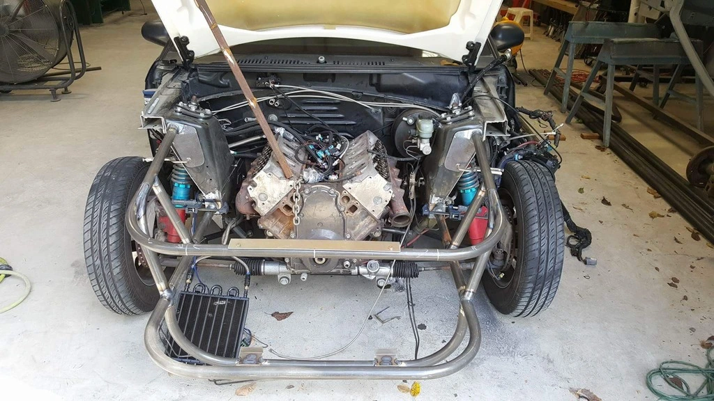

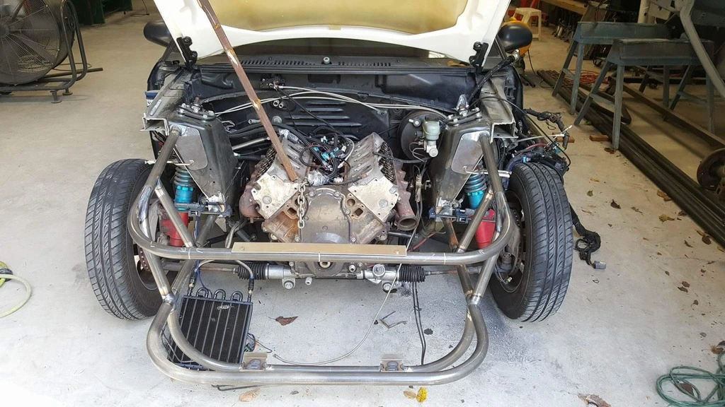

There's a dude in TX making these nice tube front ends now....

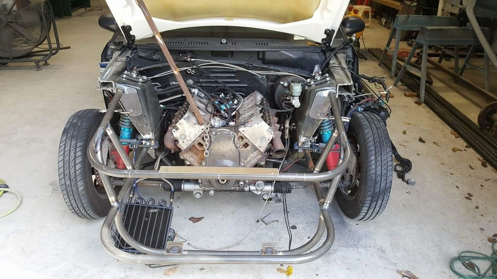

Rock solid Motorsports makes a really nice kit as well. I won't need the tube front end for what I'm building, though it would be nice. If I didn't have a clean smoothed bay I would absolutely be doing it, but at least as of now, I can't bring myself to cut it up.
I hate that they cut off the frame rails too, that was a mistake I made on my last car.

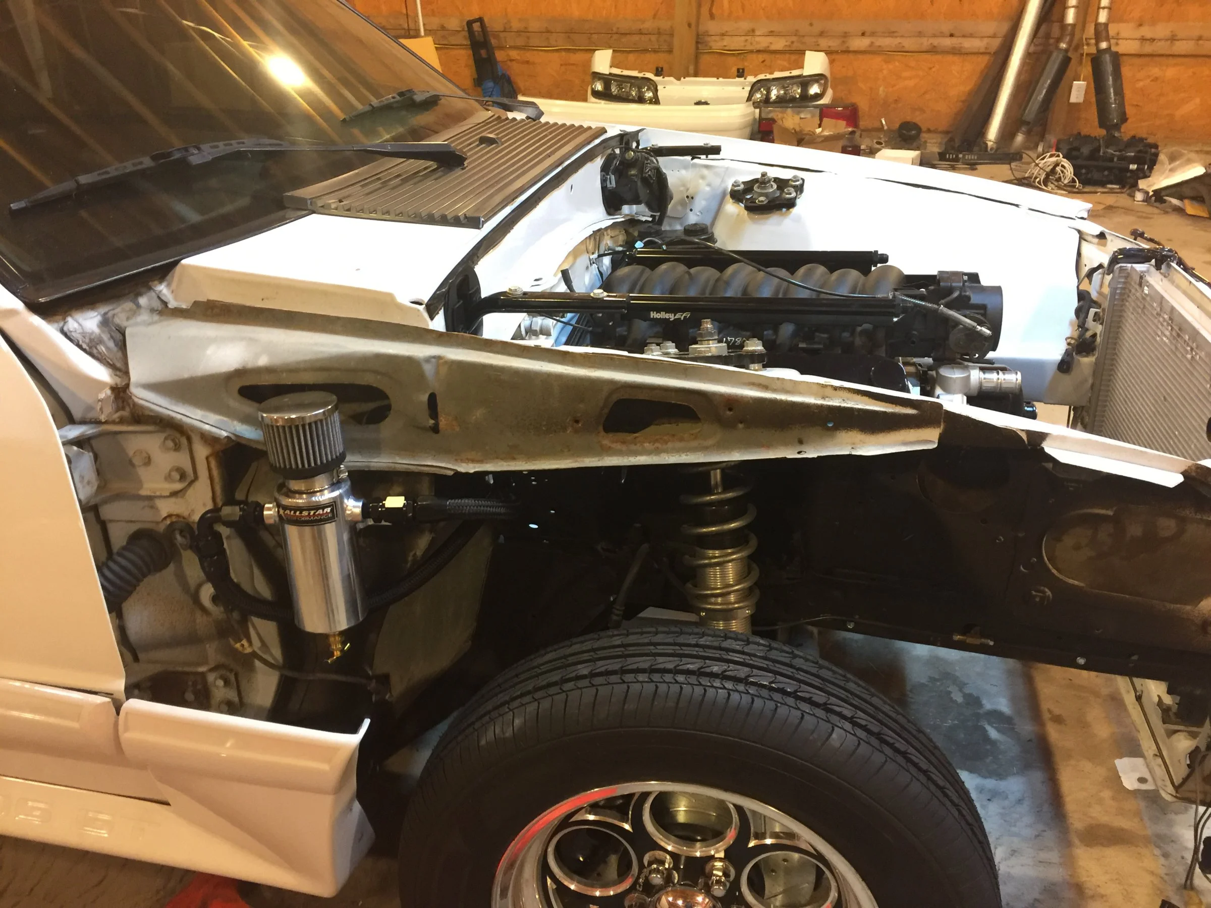

Got the lines ran for the catch can setup tonight. Going to fab up a little mounting bracket to secure the can better but I'm happy with it. Anything I can keep out of the engine bay is a plus
