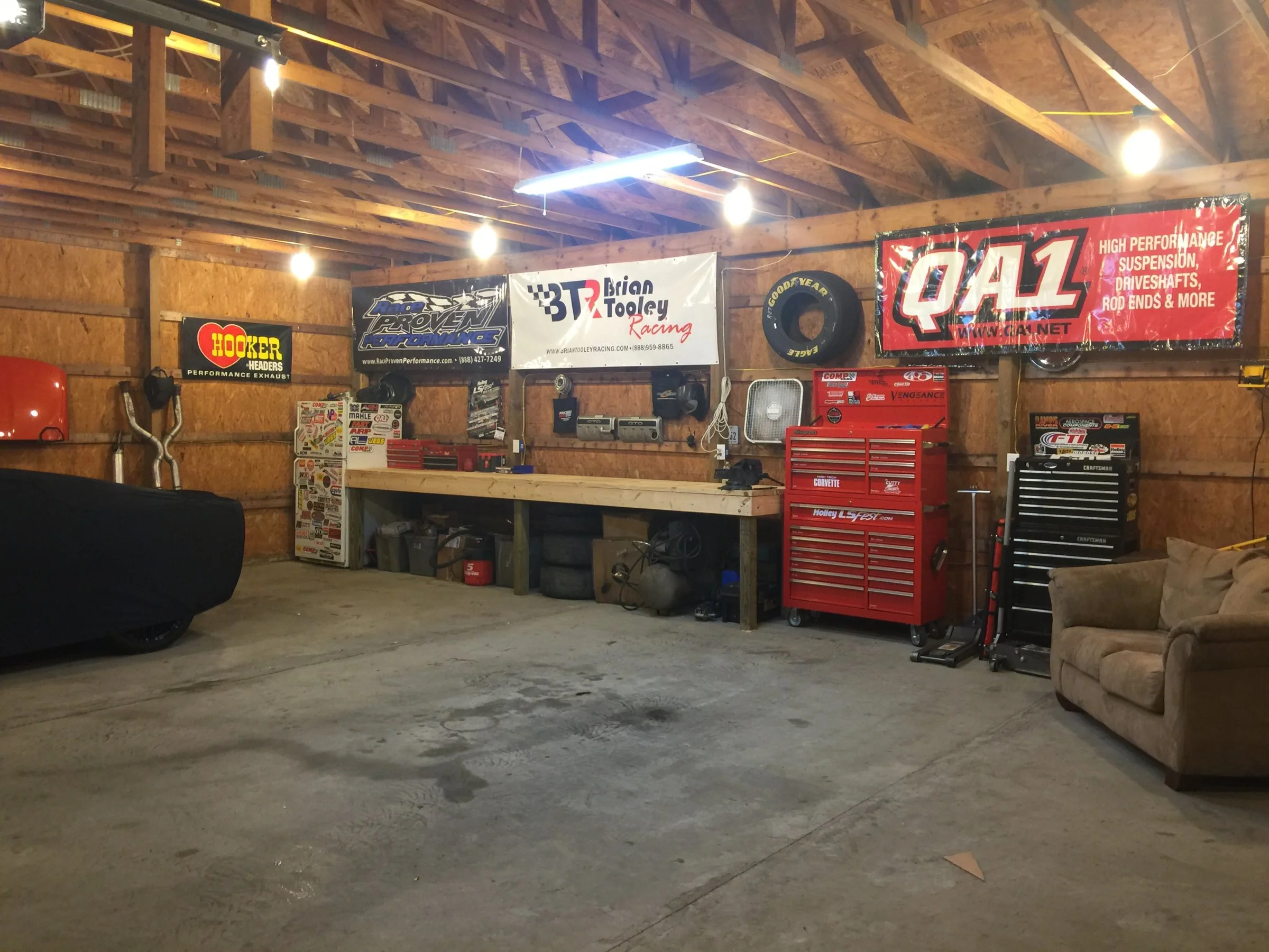

That garage rocks
Sent from my big ass iPhone 6 using Tapatalk
I feel bad complaining about it sometimes but it's far and beyond what I used to have. Wish it was insulated, especially this time of year.
But I put a tv in a couple months ago and a couch so I've got a nice place to hang out when it's not 100* at least :shrug:

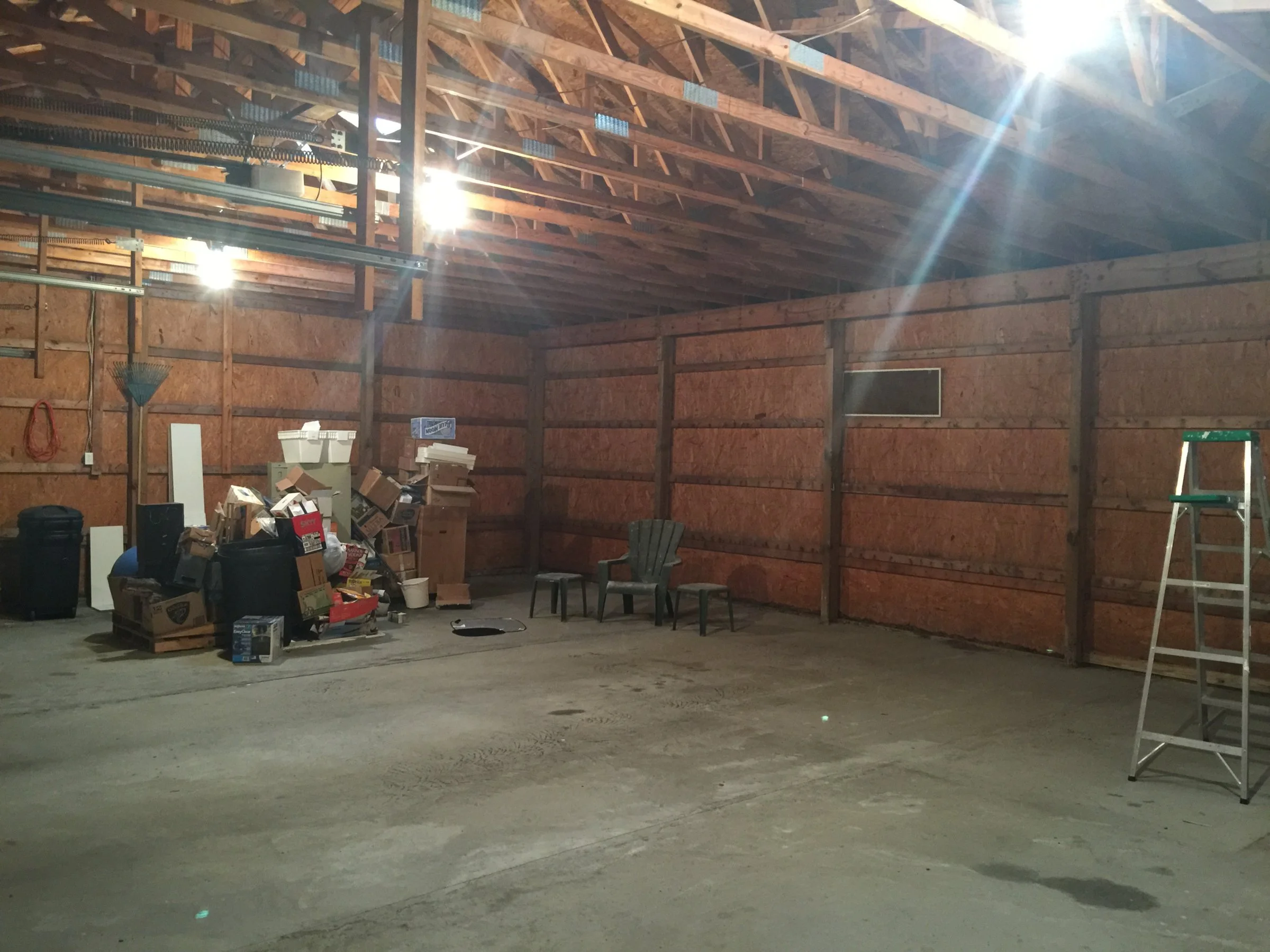

It had 2 outlets, and 3 light bulbs when we bought our house. People kept some boxes in it otherwise wasted the whole area

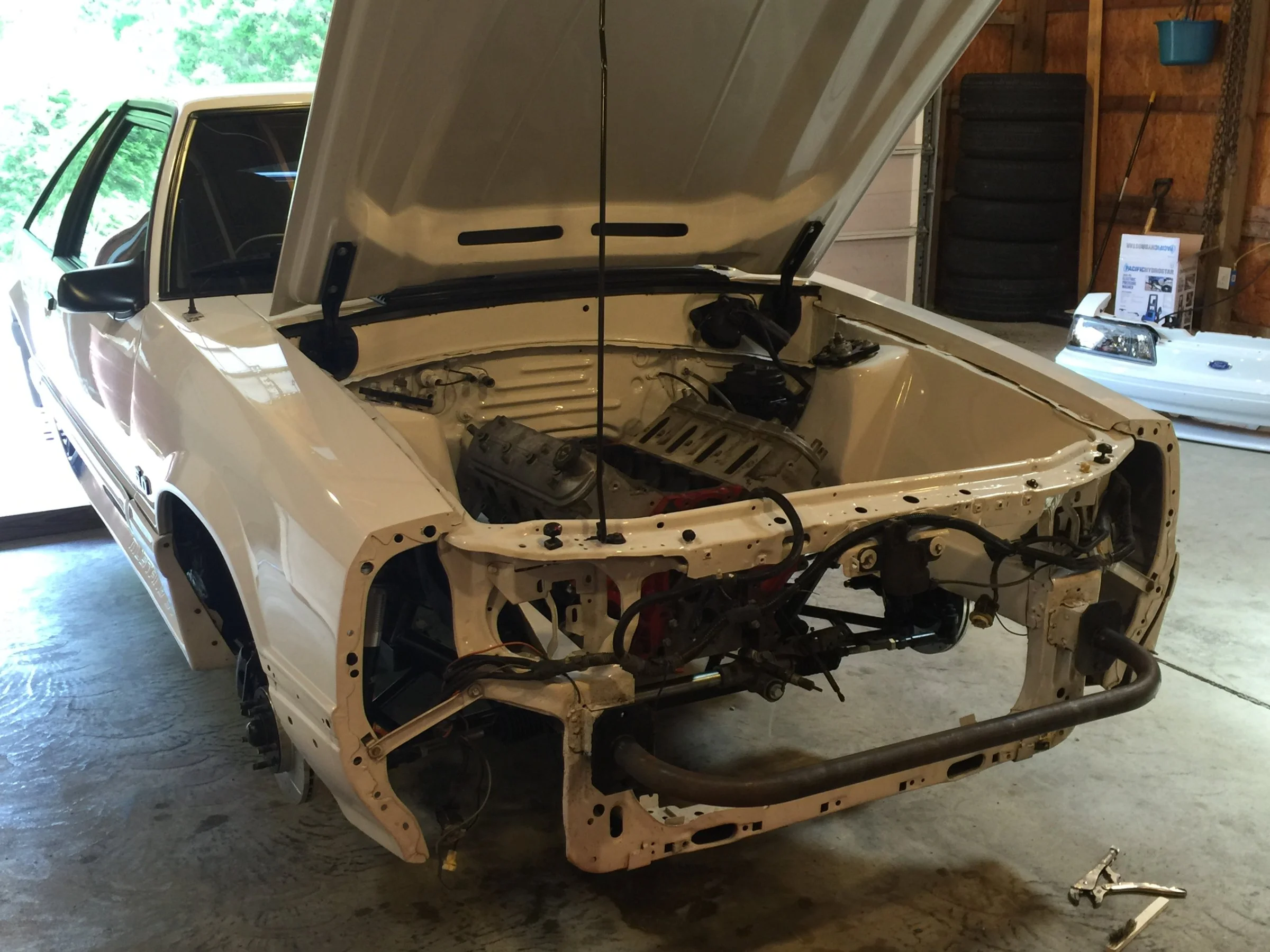

Got the chromoly front bumper support welded in today. Wanting to do the rad support but it has to wait on me to choose a radiator.
I've got the rear support yet to do.
I'm still waiting on the turbo kit with absolutely no ETA. So I'm guessing that means not soon. Everything else kind of hinges on that.

All the trouble to use tubular bracing? Plan on crashing, or does it save a bunch of weight?
It's a significant weight off the nose of the car. The core support helps free up some space and Helps mount different radiators and intercoolers as well.
Also most bumpers need the support so they don't cave in at higher speeds so just removing the stock isn't the best choice. Not sure it'll be an issue for me.
The rear I'm thinking about changing simply because I've got it to use. I'm changing the bumpers and ground effects anyways, so at least they're off now I guess

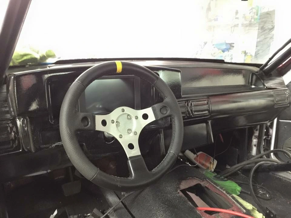

See I was looking at getting this since its local to me,
http://rover.ebay.com/rover/1/711-5...0001&campid=5335821607&icep_item=261219762089
But I like your set up better
Yeah that's Blake Holcombs setup he sells. I considered it also, but wanted to retain the key and what not. Thought it might look a little weird with the stock dash stuff.
Only guy I know personally running it has a glass dash
You could use the Grant Hub and wheel on the stock shaft. They're on back order for a good while though.

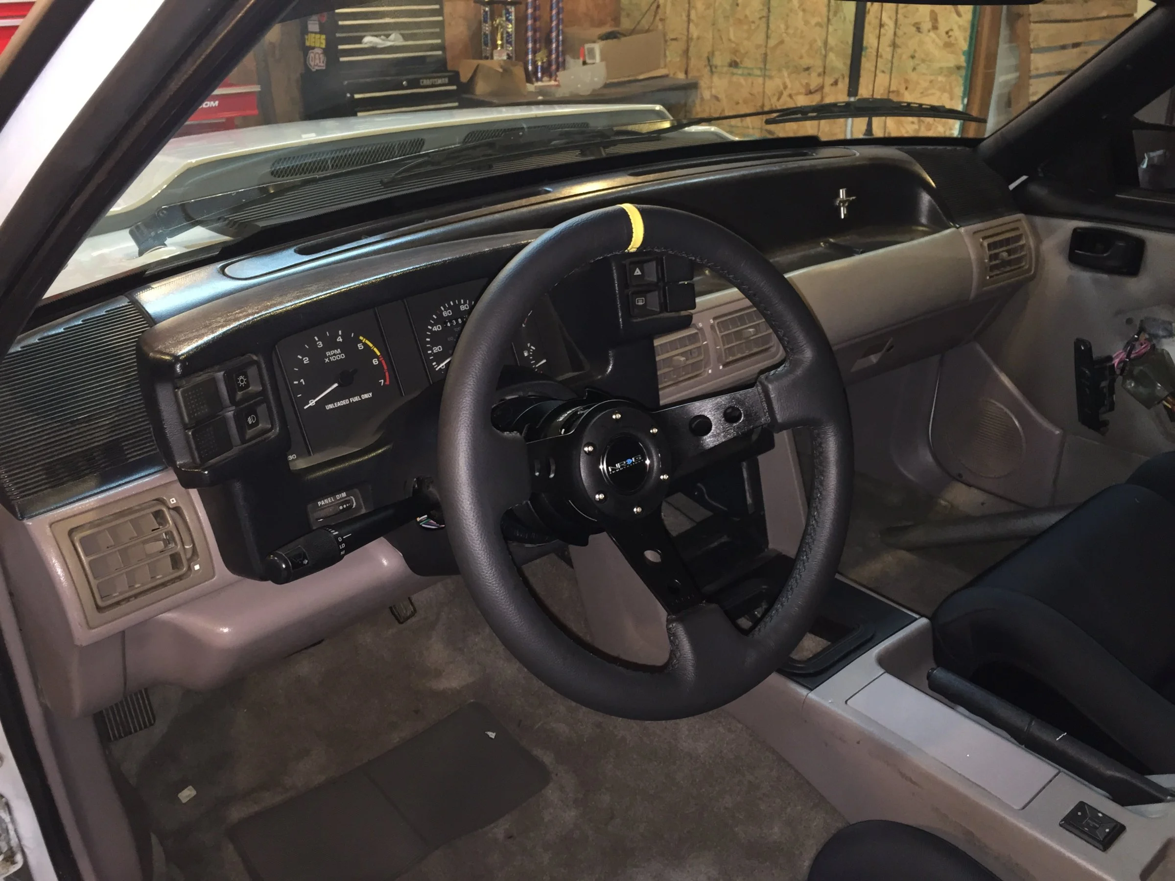

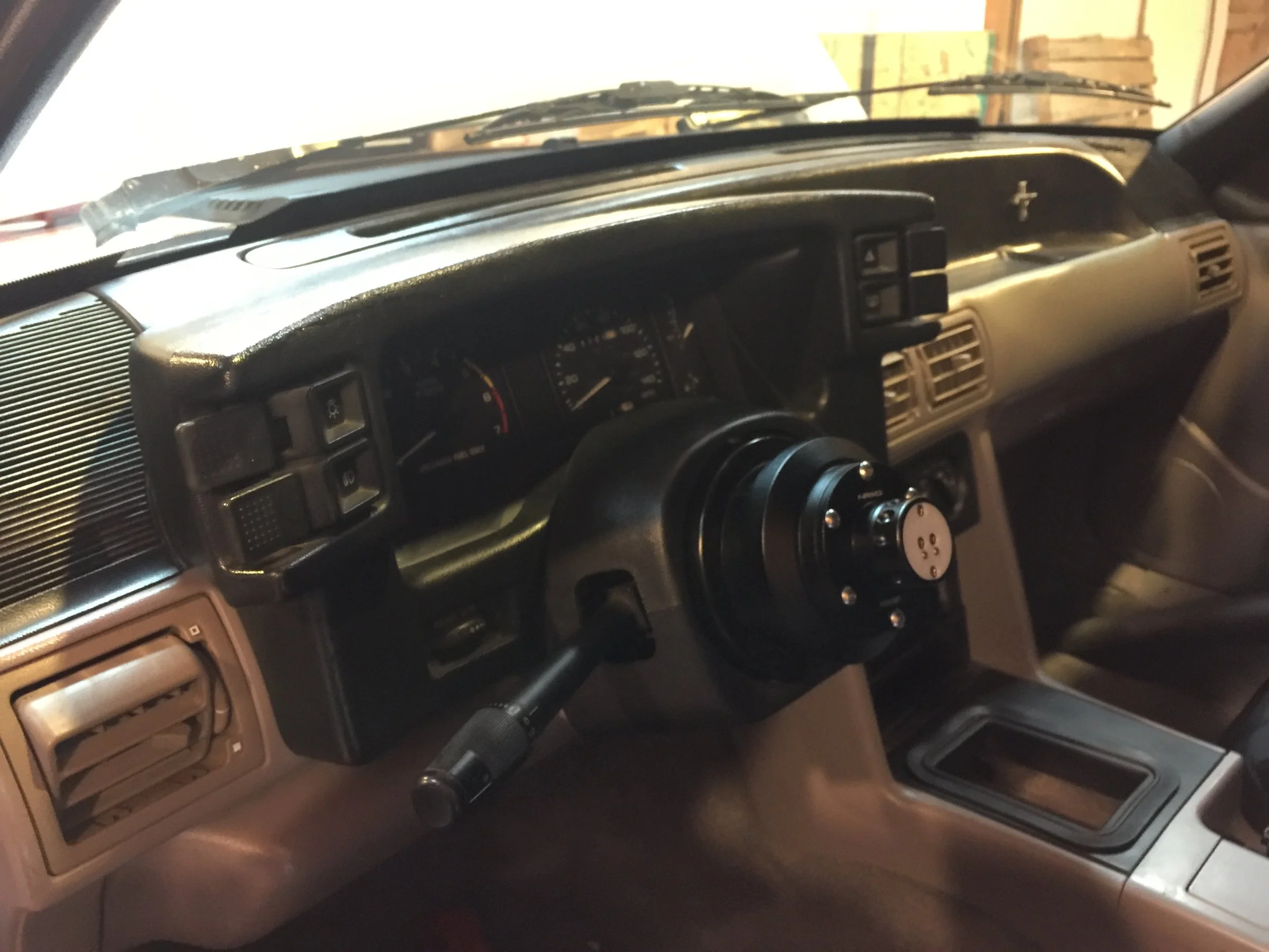

Pretty sure I reviewed the NRG QR on Amazon. I have it on my race car. I like that it centers itself, which a lot don't. But it gets sticky and difficult to remove after a while. The little button you have to push that sort of wants to pinch your finger as you pull the release just gets worse. It's hard to see in full helmet and hard to find in gloves. Several parts have spit out of mine over the last couple years, springs and clips, but it still works.
I can see why you would pay for some of the better ones, but I think it's pretty good for the money. I want to say it's more of a street scene part than a hard core race part though.
That's probably a fair assessment. The 2.5 doesn't have to push that little button it seems. Well it does but I'm able to lock and unlock the wheel without pushing it directly. Since they've added the flanges on each side you can grab to release the wheel. I guess to combat exactly what you were talking about. I'm terms of long term reliability you'd know better than I. Hopefully it lasts a while.
I did see a lot of "street scene" type cars giving reviews online and it comes in some interesting color combos so you're probably correct there as well
