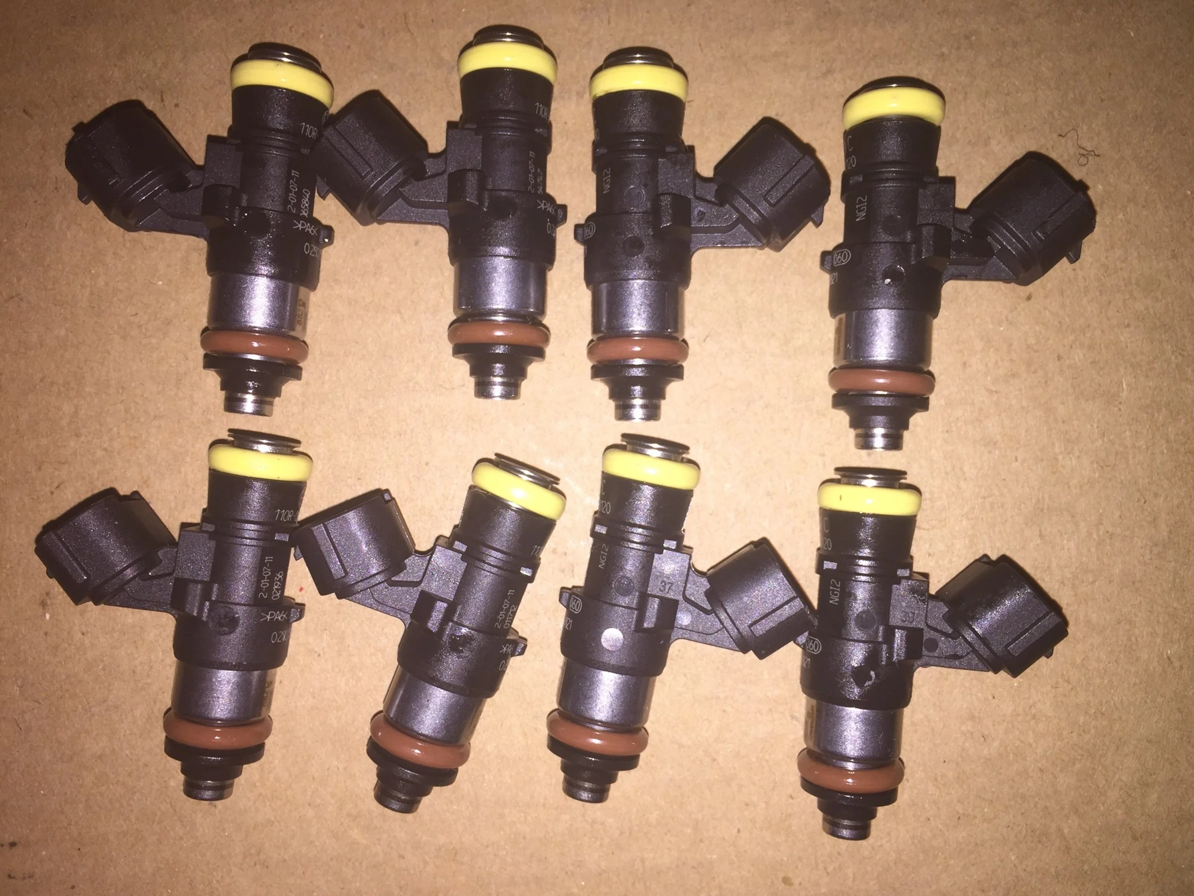

My injectors are on the way from Venezuela. Which is somewhere not in America I'm told.

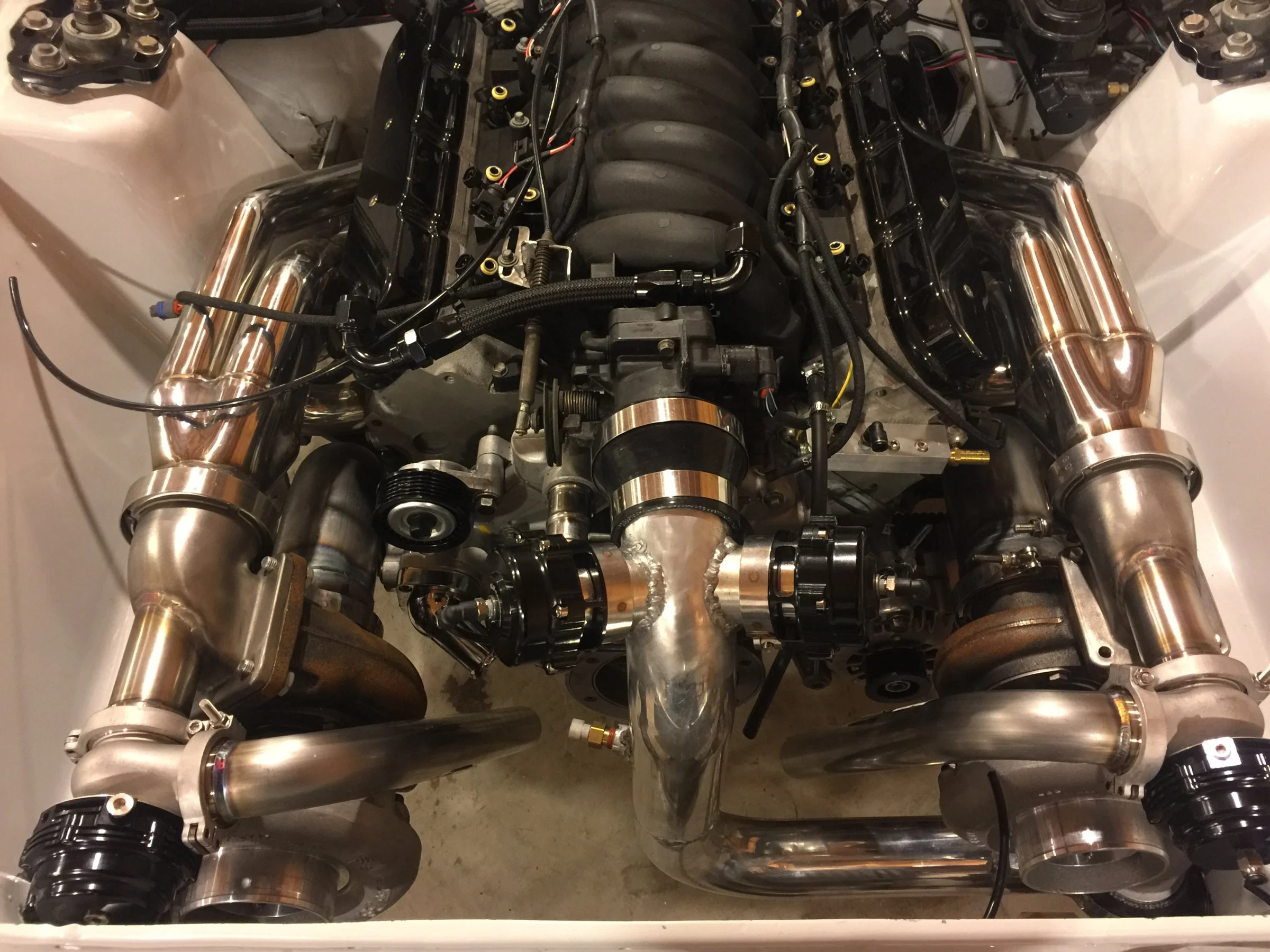

Only thing holding me up besides free time is wastegate dump tubes. Which I can't for the life of me decide where or how to route them.

Why on earth do your injectors have to come from Venezuela?
They're Bosch injectors but there's a slew of 3rd world countries they ship from :shrug:
I thought Bosch injectors were made in Germany and China.
It's an LS engine......surely there are domestic suppliers that have that junk sitting on a shelf in poughkeepsie or sheboygan, somewhere that doesn't have a donkey and a cart in part of the tracking history.
I mean,...I have an Australian head. It HAD to come from Adelaide Australia because of that. But I also have Bosch injectors,...and they came from Summit. In Dayton,.......Ohio.

Don't know of any domestic suppliers for the size I bought. Wanted to avoid the 160lb injectors which are plagued with so many problems. I was recommended this supplier so I went with it. I shop Summit pretty requently, have 3 packages coming right now actually (could have saved some shipping there no doubt but Im a poor planner). They pretty much next day deliver to me, and now that they're building a warehouse in TX some of you guys will get to know that wonderful life

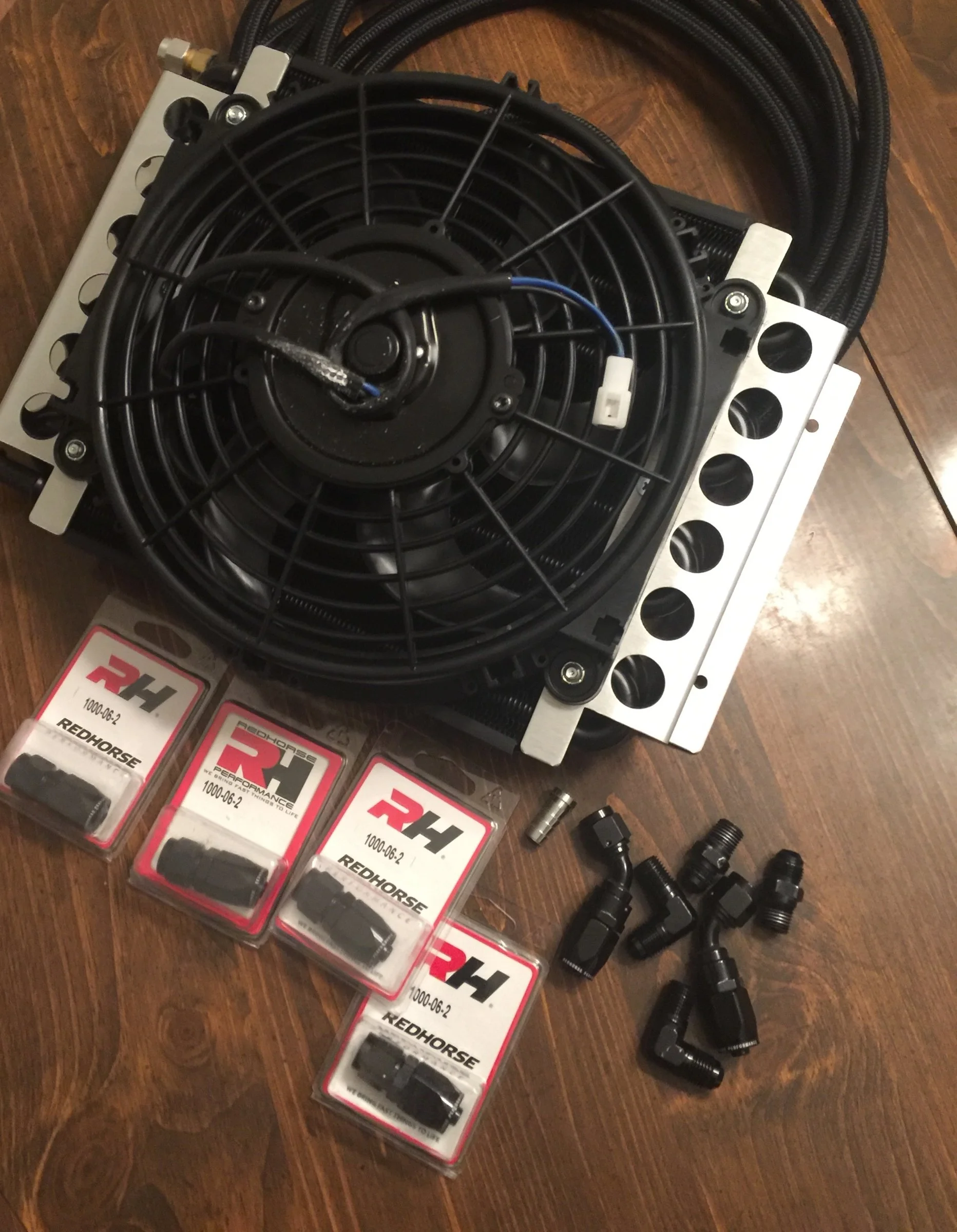

More AN fittings....yay

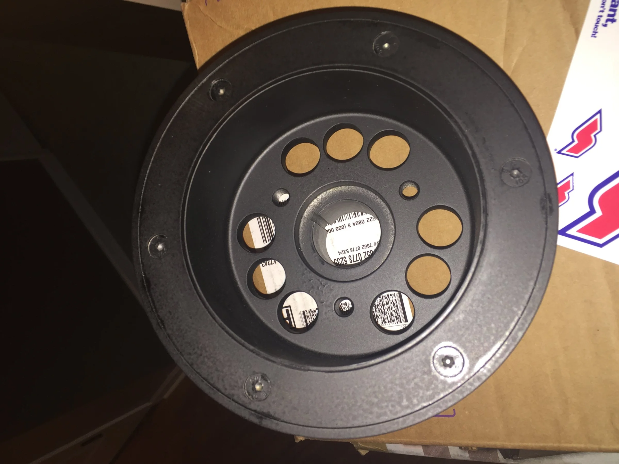

New Trick Flow balancer came in also. Looks, weighs and feels exactly like one I have other than the paint. Guess that answers who makes the Summit Brand balancer.
My injectors on the other hand are being held by US customs at the moment. So there's that.
Guess they didn't find any heroin in my injectors box so these fine units showed up today. DHL asked me where I wanted them delivered so I instructed they be left under the bench on my back deck out of the weather and out of sight.

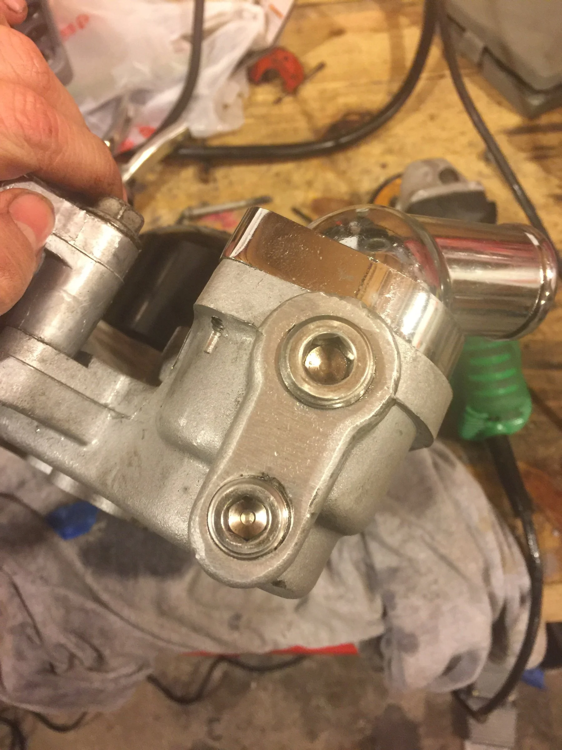

Also finally tapped and plugged the water pump. Nice to have that off my list.
and finally I got dump tubes for my waste gates. It's not 100% ideal but I can't have come this far to cut into the fender aprons now.
Had to order ev1 to ev14 adaptors for these injectors and tomorrow I've gotta "borrow" a different set of fuel rail brackets to drop the rails down for these super short bodies.

I swapped out the corvette balancer in favor of a correctly spaced Fbody unit. Hopefully get a little money back out of the old one.

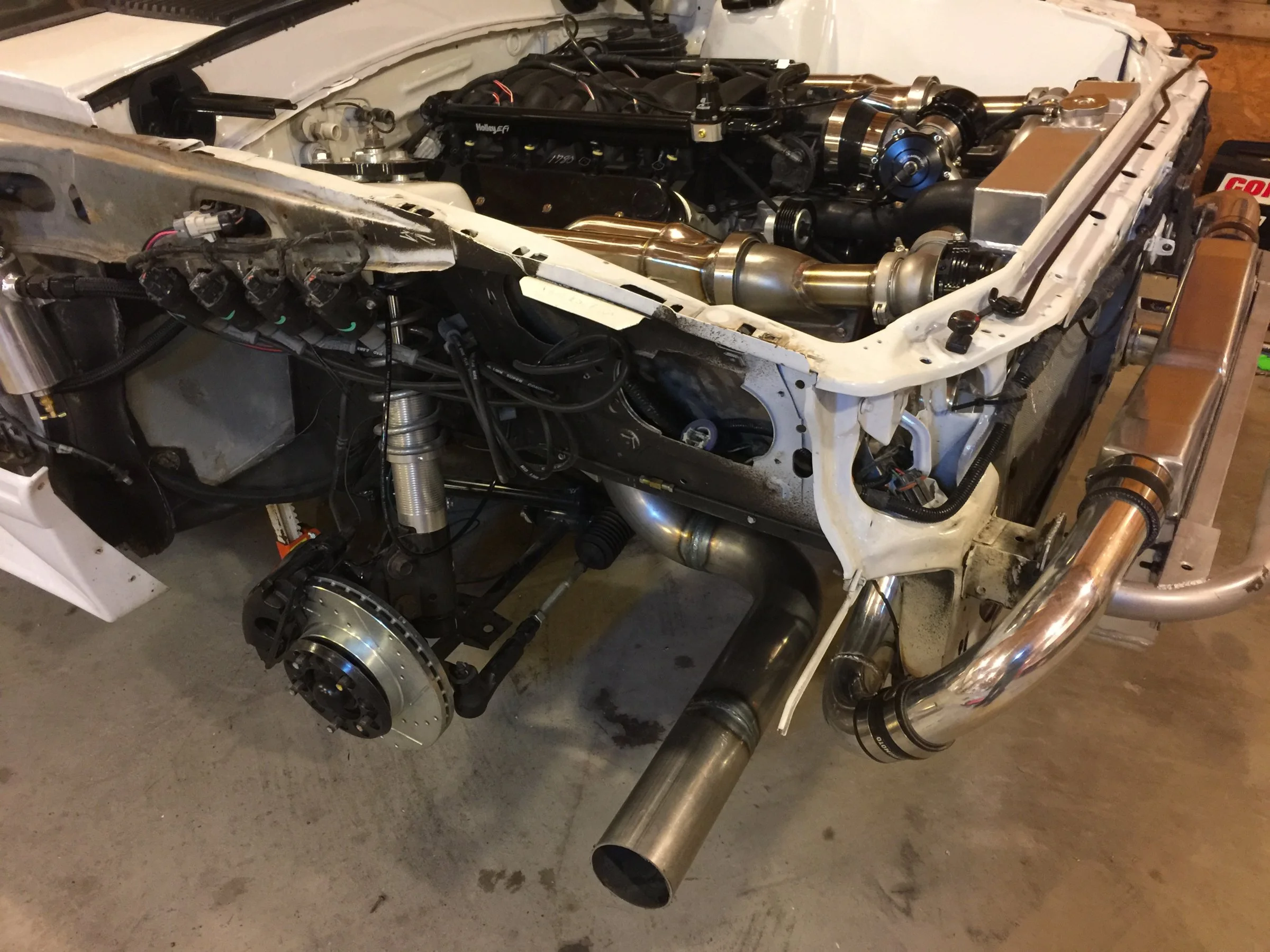

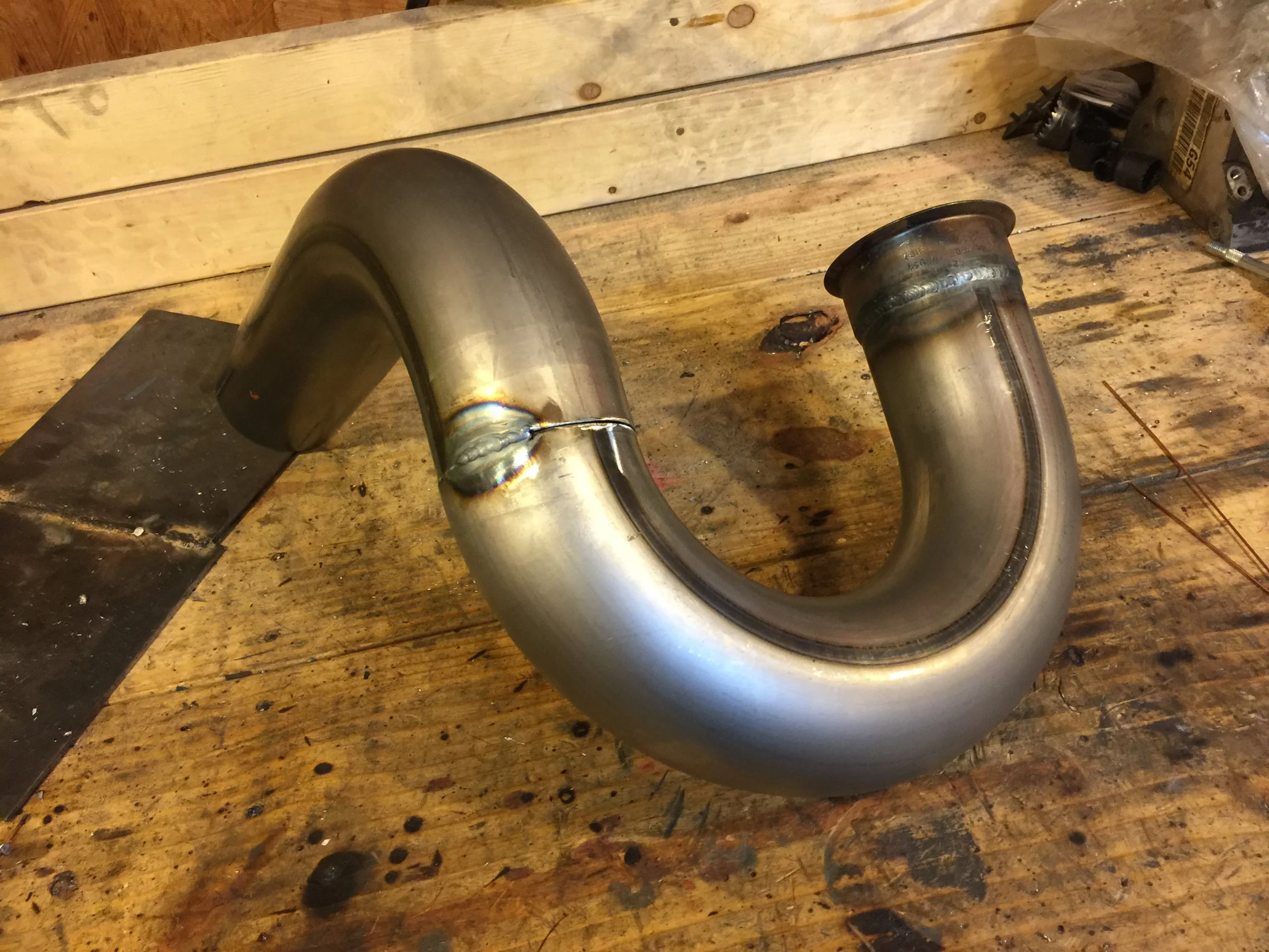

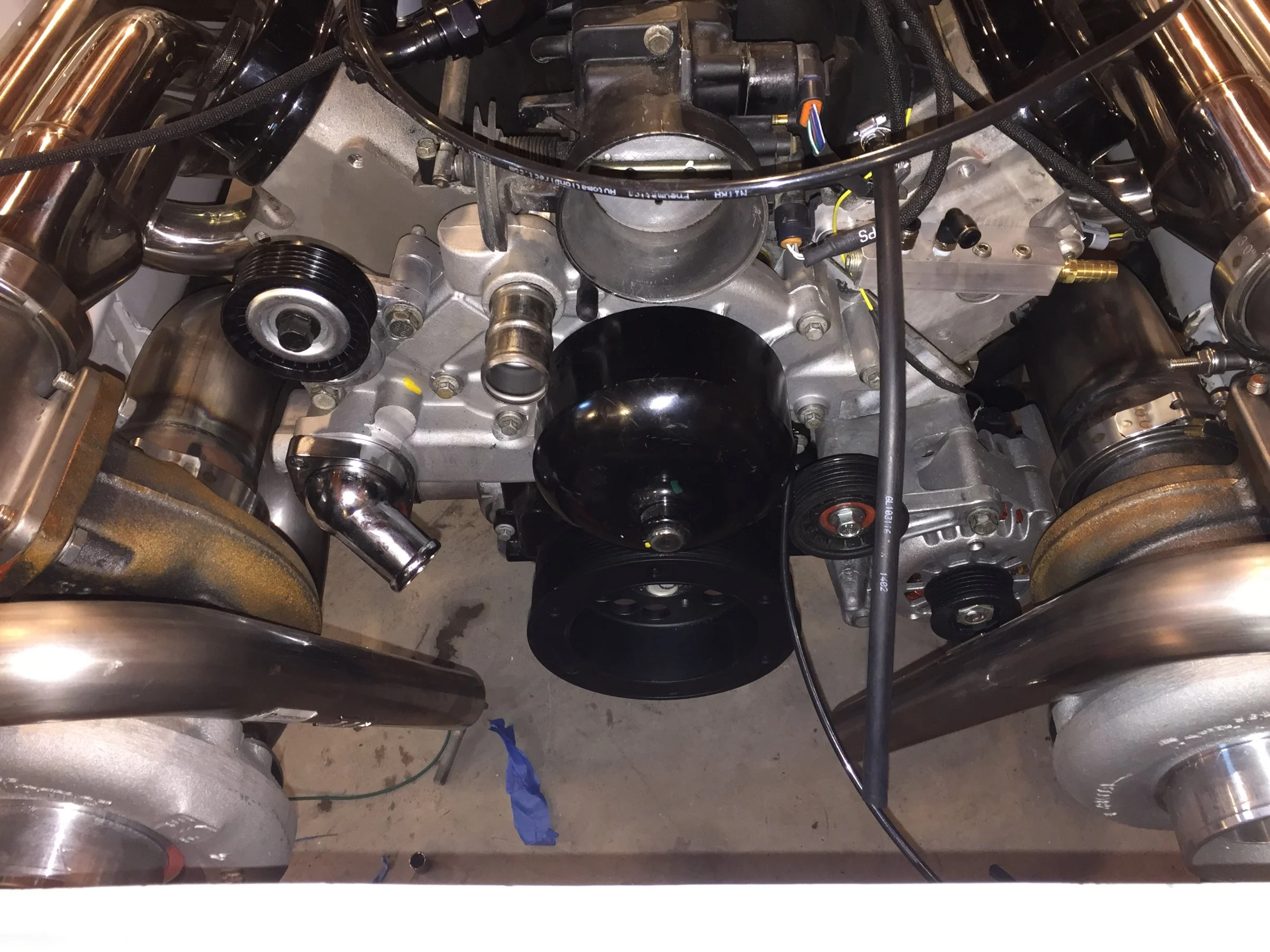

Also I finished building the downpipes. I'll have to cut them down to size when I get the bumper on but they came out pretty good.
Then I spent a couple hours with the turbos. Pulled them out and sealed the exhaust flanges, installed the feed and drain fittings, reinstalled the turbos. Wrestling them back in never fails to bring the top shelf curse words out. But at least I can hook up even more hoses in the engine bay now.

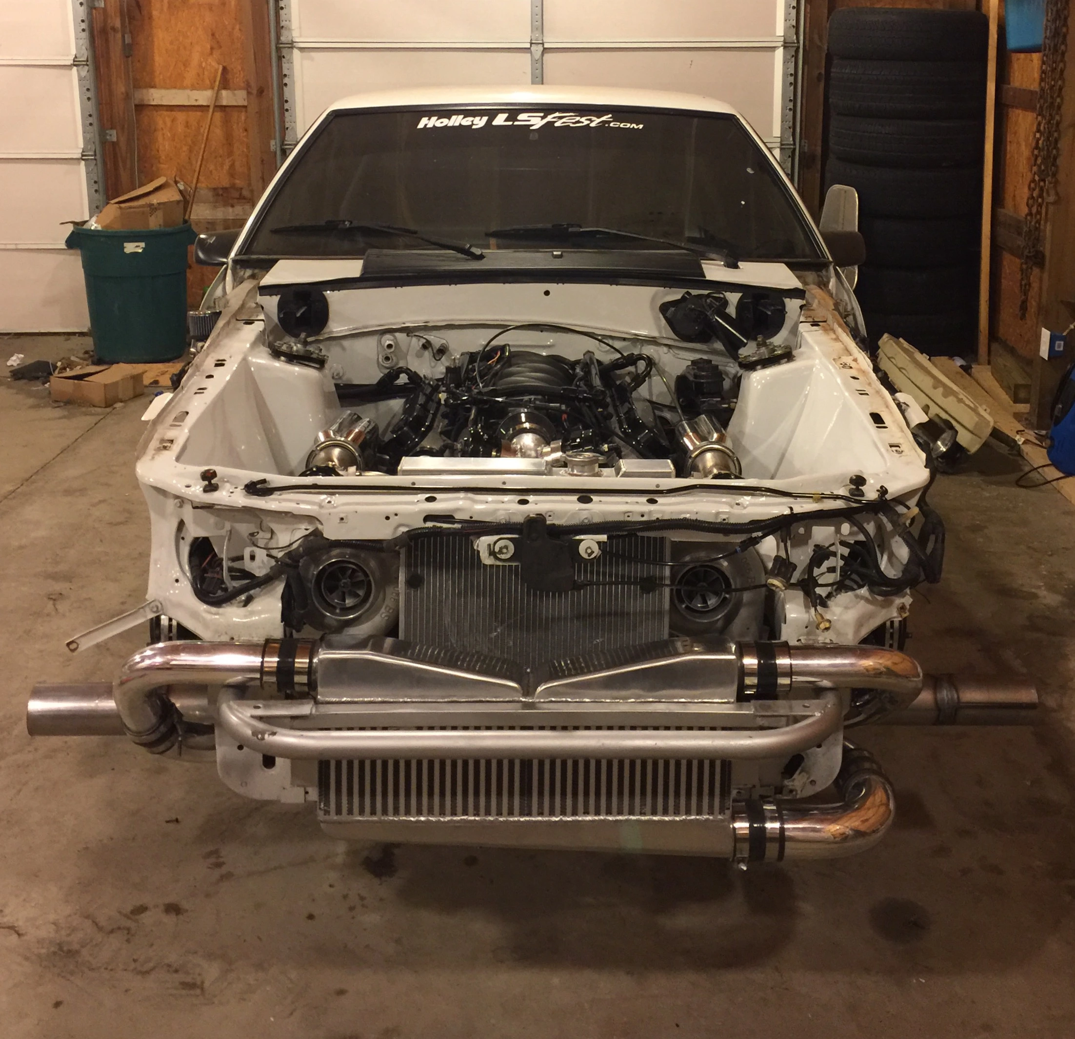

Got the engine bay mostly back together. Put the missing T-bolt clamps on the cold side, got clamps for the radiator hoses and went to Oreillys to pick up oil and coolant.
I need to get the fuel tank back in the car so I can mount the fuel pump and run the return line. Then all that will be left is wiring up the engine management.
