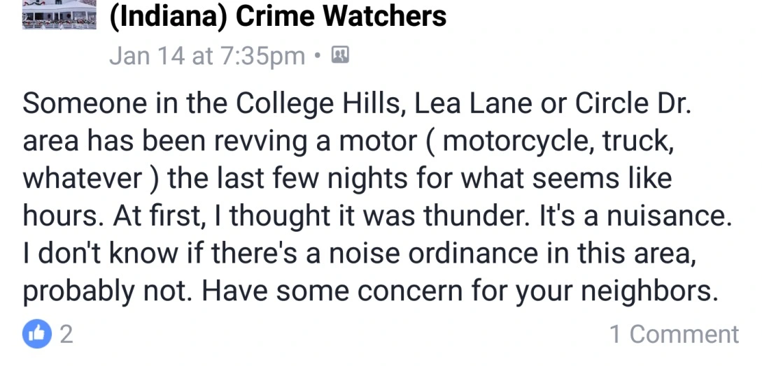

Well my neighbors aren't as happy that it's running as I am....we need to live further out of town
That butt clown should be grateful he/she doesn't end up in one of your graveyard images.
TannerResponse:
Oh yeah? Well I don't bookface so I'll never read your stupider message! *middlefingersmiley*
They think that's bad- wait until your leaving off the two step in the middle of the street lol

hoopty5.0 said:
Did you reply to the message or are you going to let it ride?
Just letting it be. I always shut my compressor off and stop using power tools by 10pm and I haven't started the car up after that either. That's all the courtesy you'll get from me lol.
There will be plenty more "revving" to be done in the next couple weeks
Some of my friends on the other hand have found the crime watcher post. That I can't control

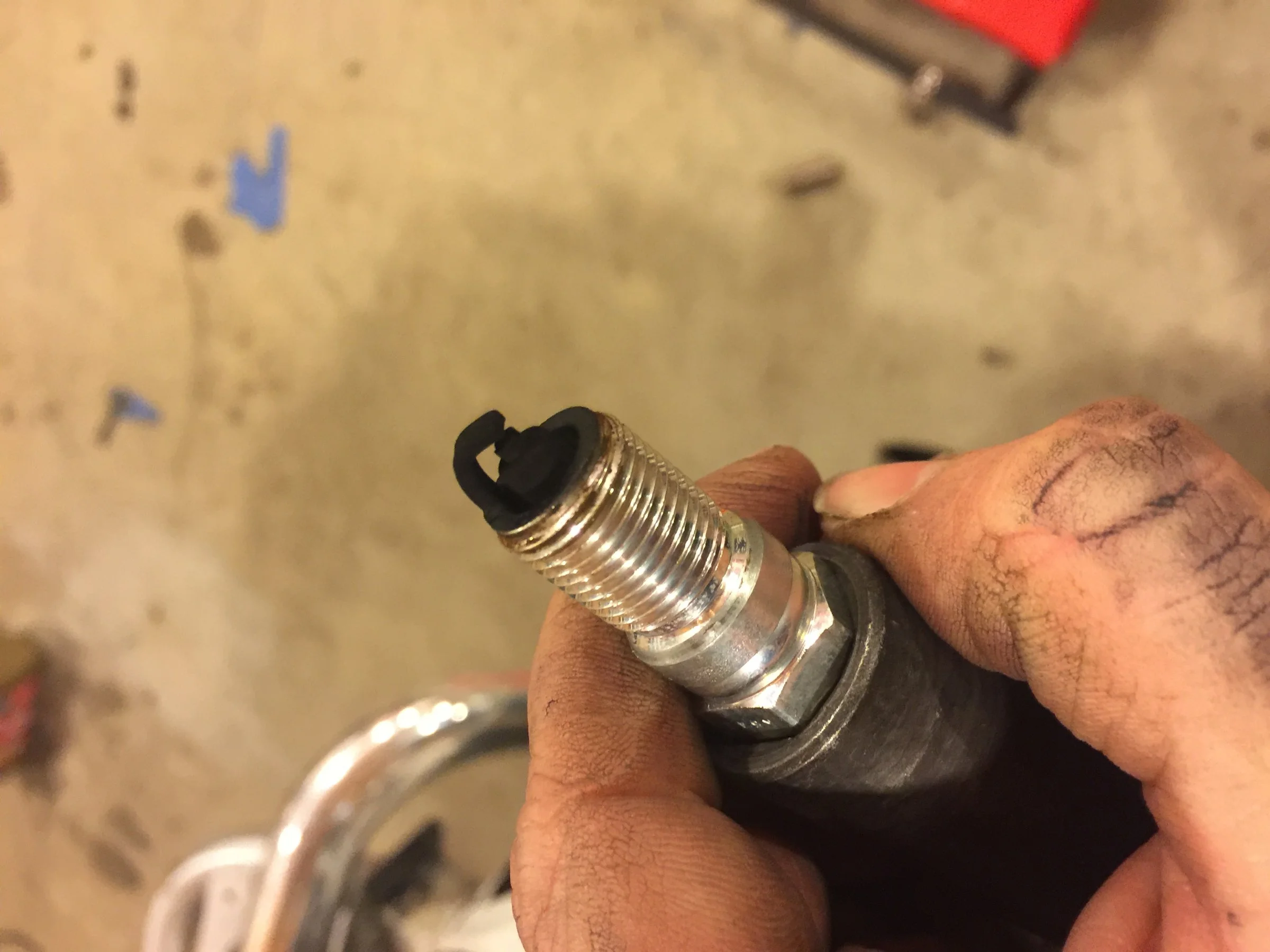

View: https://youtu.be/_3JrNJNn0XM
Fixed the fuel leak a couple days ago. Developed another 2" over but should be an easy fix.
Realized the coil harness extensions were side specific so I swapped those. Changed the plugs (passenger side were all solid black). Swapped in the big injectors since my new adapters showed up and let it idle a little bit.
Passenger side still gets MUCH hotter than the drivers side. Which to me would indicate a lean condition, though the old plugs showed otherwise.
I swapped the passenger side coil bank out for another one to hopefully eliminate the possibility of a dead coil(s).
Between different coils, plugs and injectors I had hoped it would have worked itself out. But it did not. Still scratching my head a bit.
Also showing 7.3 psi oil pressure but the number was static so I think I've just got it configured wrong. Otherwise I'll be pulling a motor again...
On the "upside" I ordered my converter today as well a really nice PPP shifter I'm excited about. That's the last of the large purchases (assuming I don't need a shortblock) so that's a relief.
Will be a week or 2 before I can spend any real time with it again.
Could you please post a copy of the tune you are using. I have seen cases where there are 2 separate fuel ve tables for each injector bank, or a separate trim table.
Definitely not lean.
I'll try to post one tonight or tomorrow, your insight would be appreciated. I think maybe I'll scrap the tune I borrowed. Like buying a half finished car there are just too many variable to rely on being correct.
It was an e85 tune, I'm on pump gas. I turned off the flex fuel stuff, input my injector size and tried to dial down the fuel table but there are so many hidden things it's more trouble than good at this point.
