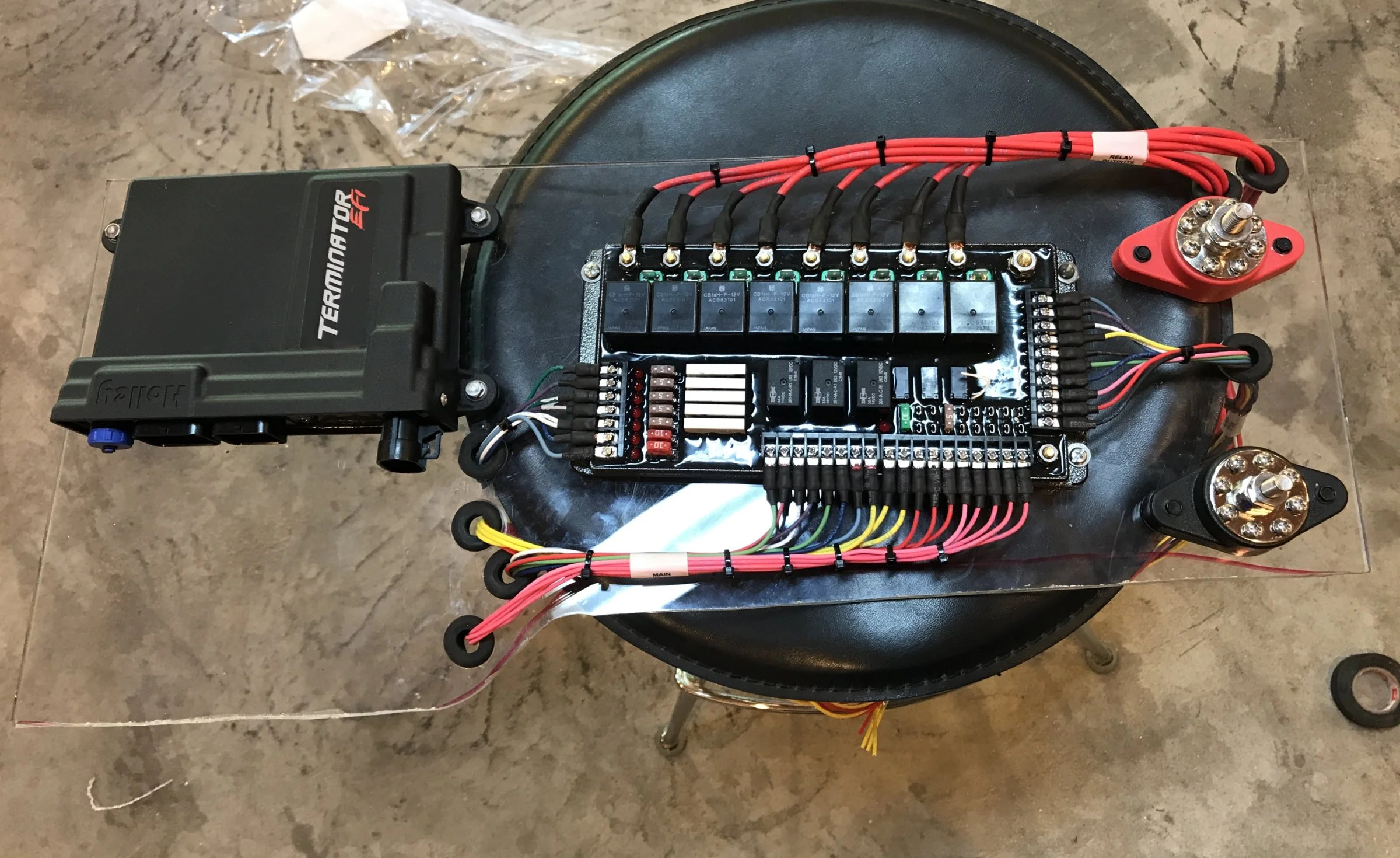

The relay coils for plug in automotive type relays can all run on a single 5 amp fuse.
While you are in the fabrication mode, plan to make a plastic cover for your circuit board to protect it from accidents like dropping a washer on it or from liquid spills due to rain or clumsy people riding with you.

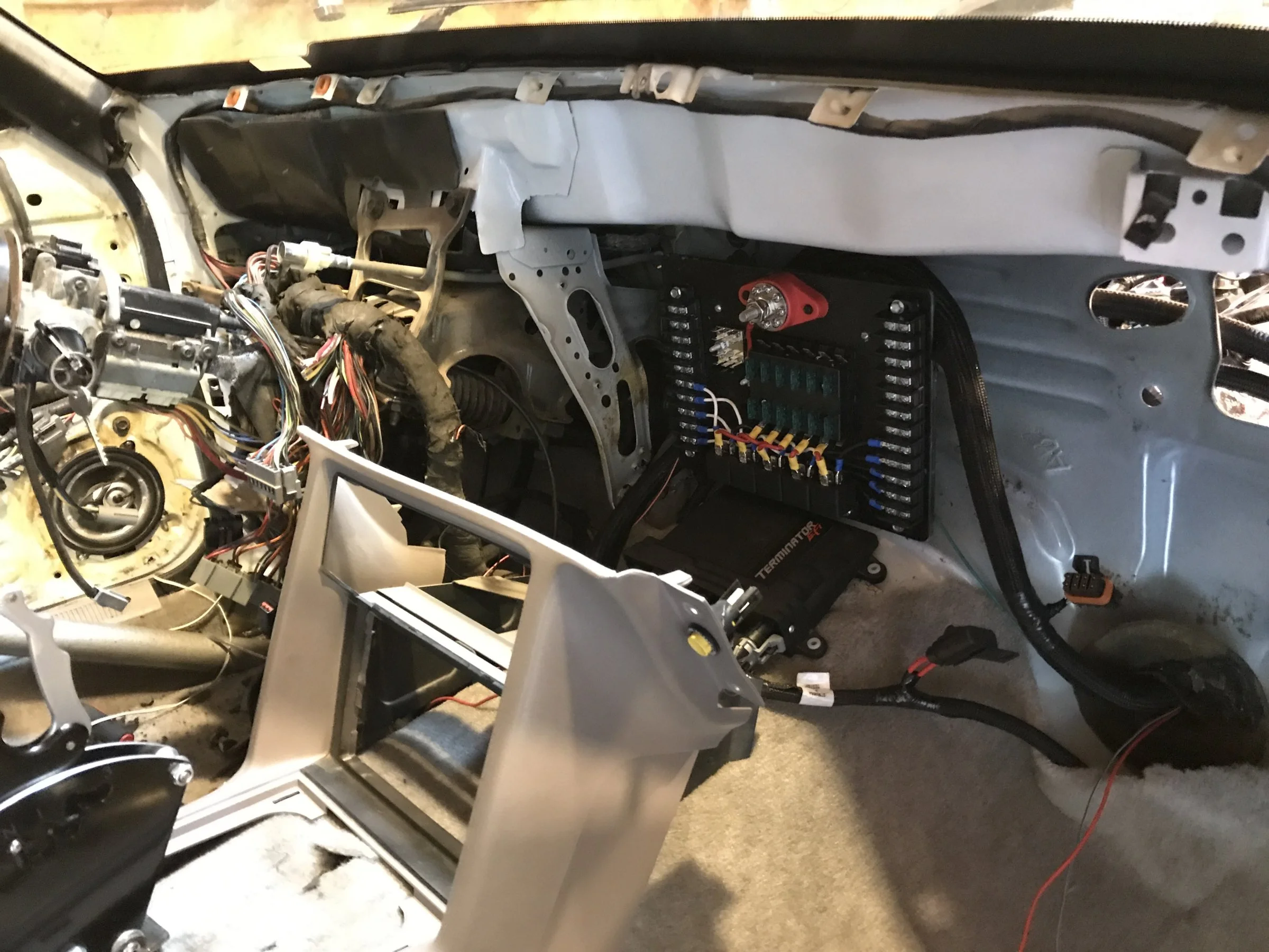

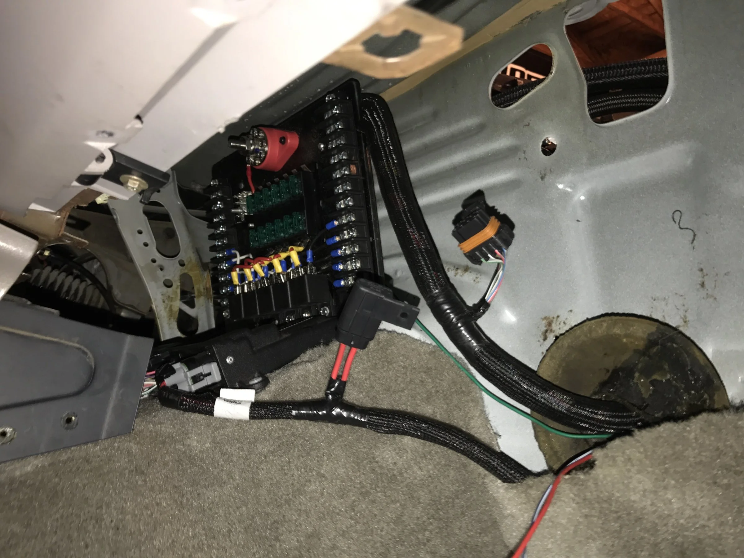

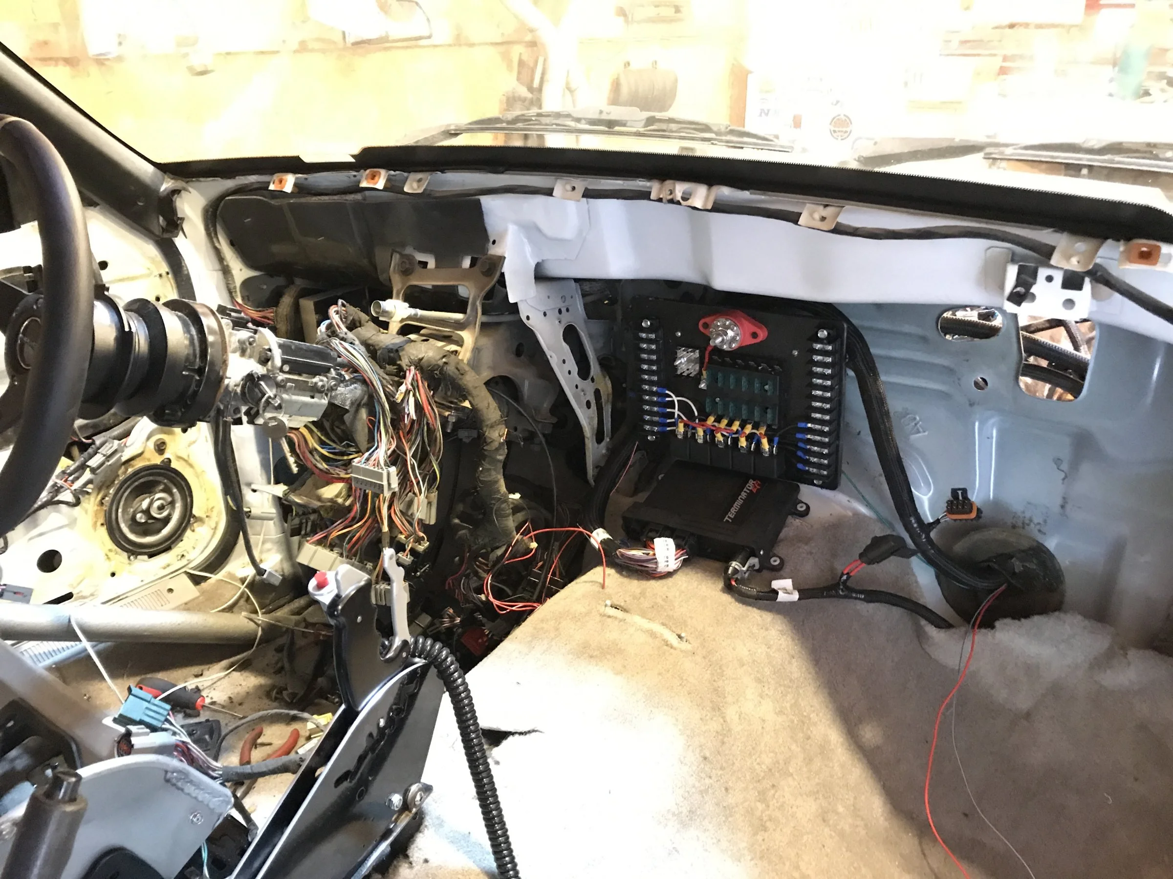

I think I settled on a home for it.
The ECU isn't mounted and the harness wiring needs moved around a bit but I think this will keep it away from stray feet and other dangers.
As @jrichker said, I'll have to build some kind of cover for it as well.
Surprisingly there's a ton of room under the dash once you remove all the nonsense. Center console fits right up against it.
And it won't be entirely unreachable with the dash installed should I need to get to it. Or put a fire extinguisher on it lol.
Going to try and make the dash a little more "quick removal" friendly like I did with the SN95 car. Made life a lot easier.

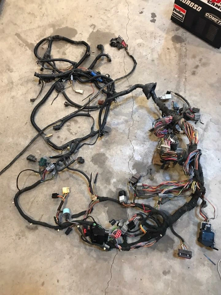

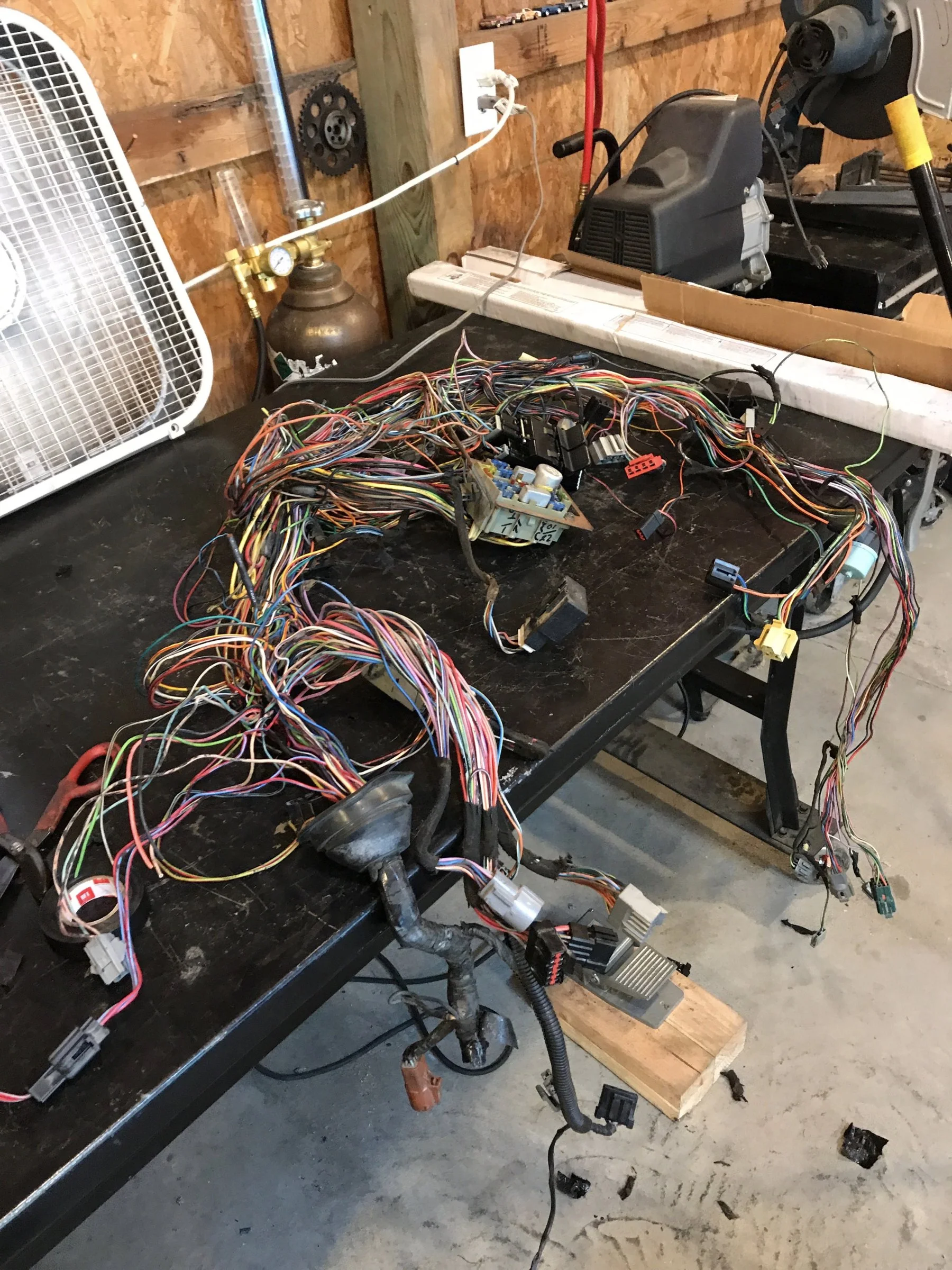

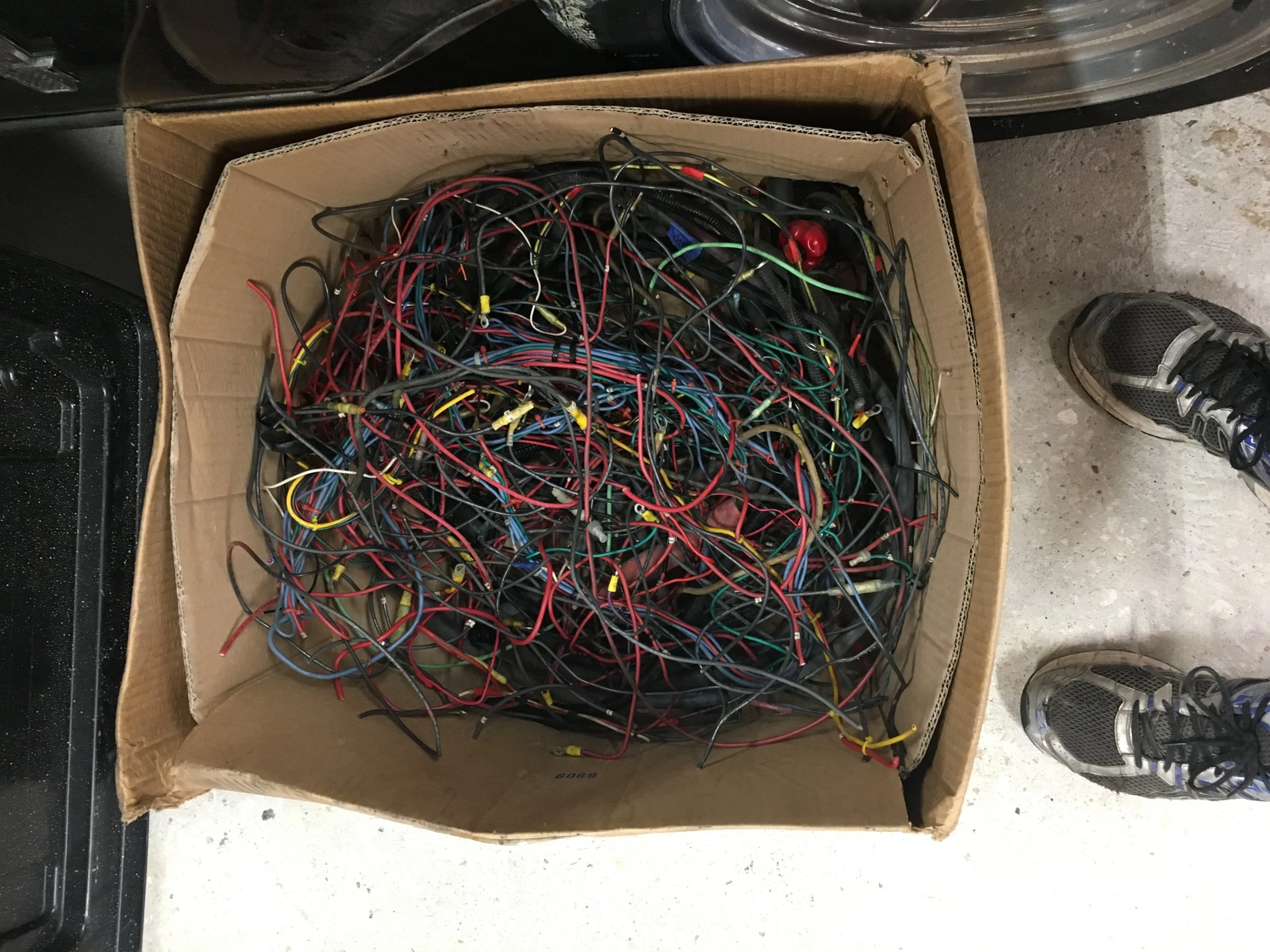

Work is a little slow tonight. Suppose I'll update this thread.
Moved on to wiring project 2.0 in the last couple weeks.

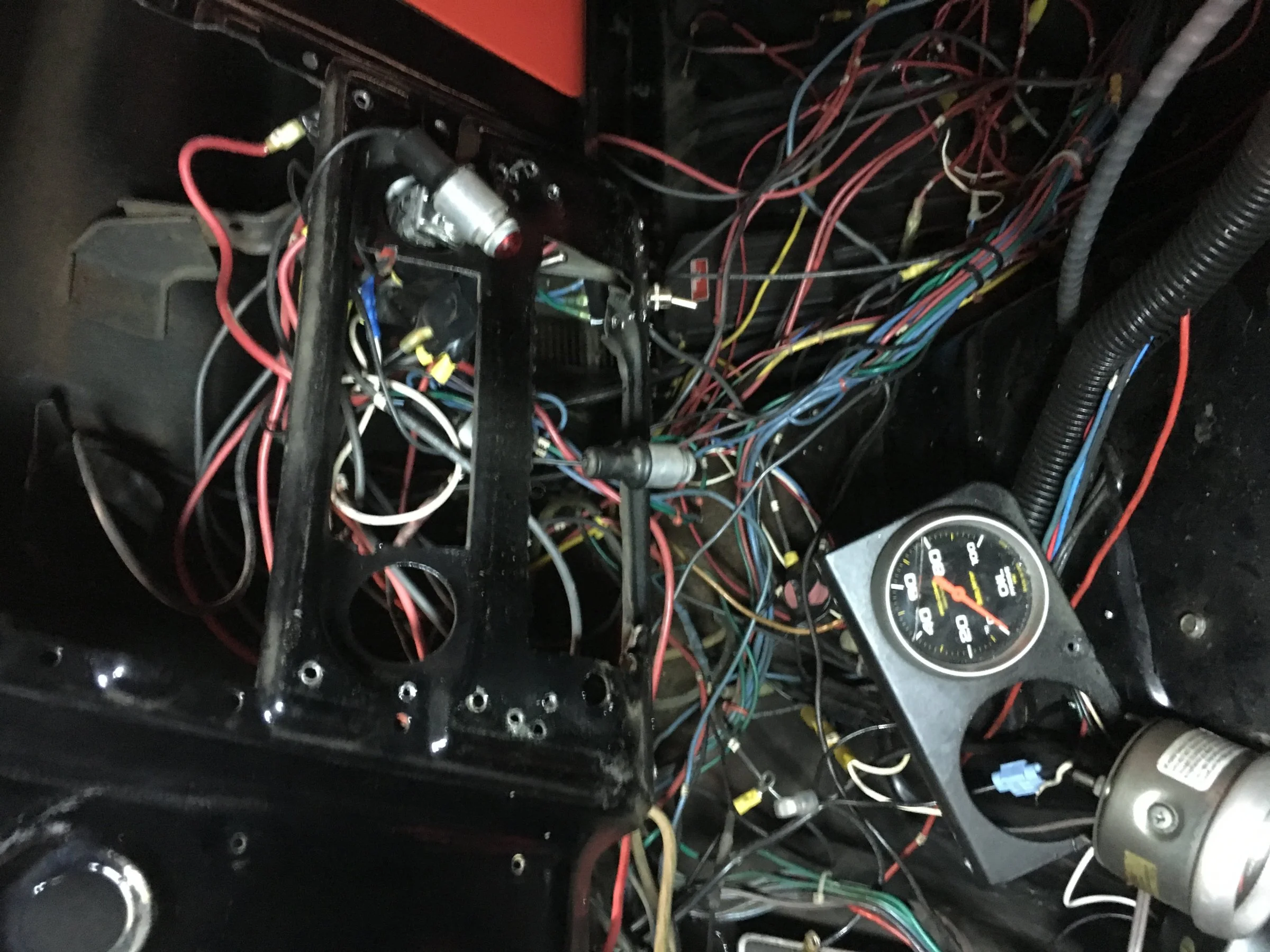

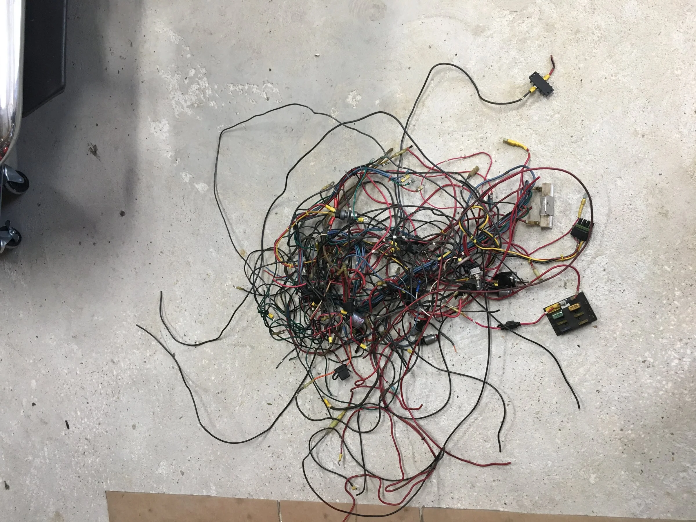

Got tired of fighting it and cut out every wire under the dash
At first I thought I'd pick through it and simplify what was there so I removed all the loom and gathered up some diagrams.
As you can tell, that was a disaster in itself. Ford liked to backtrack wiring a lot it seems and there was just way more there than what was worth trying to tackle.

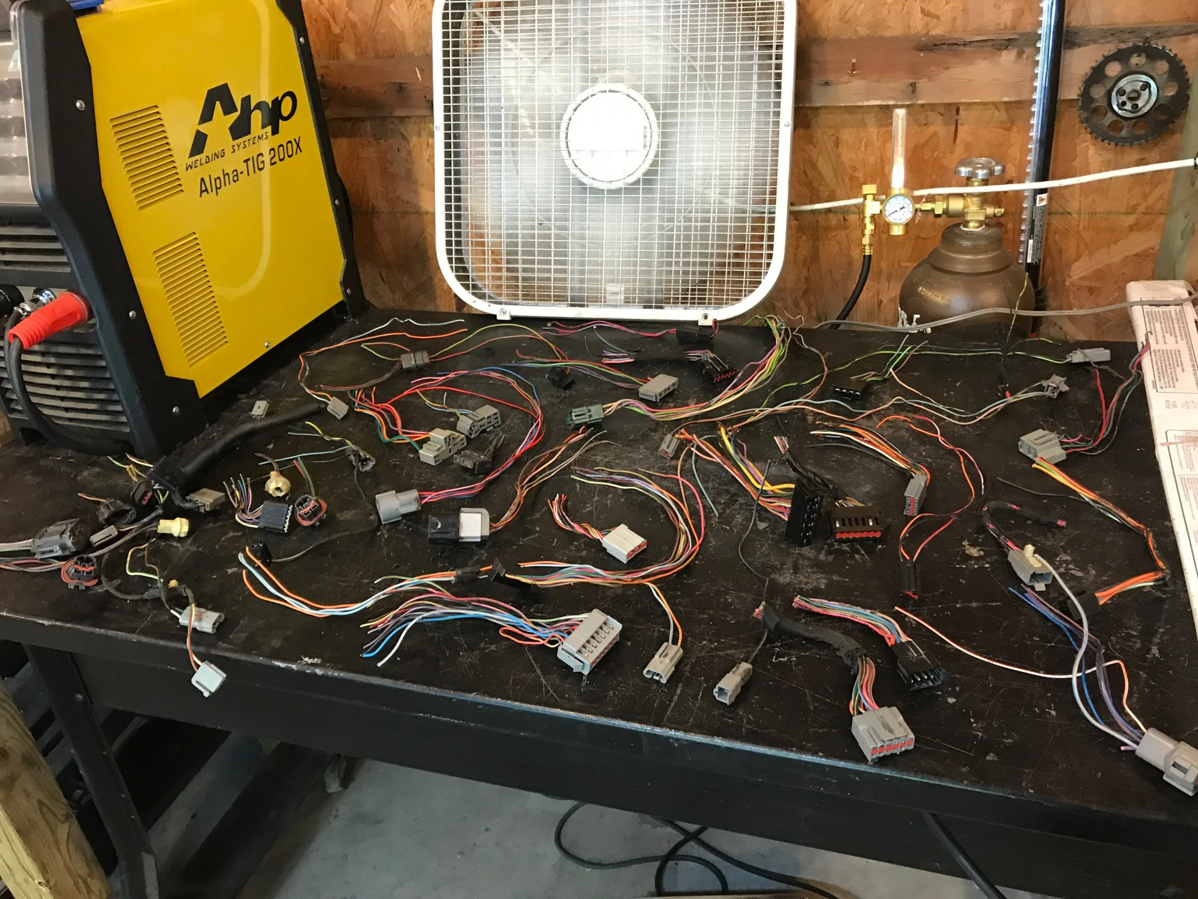

Salvaged all the factory plugs as I'm sure many of them will come in handy.

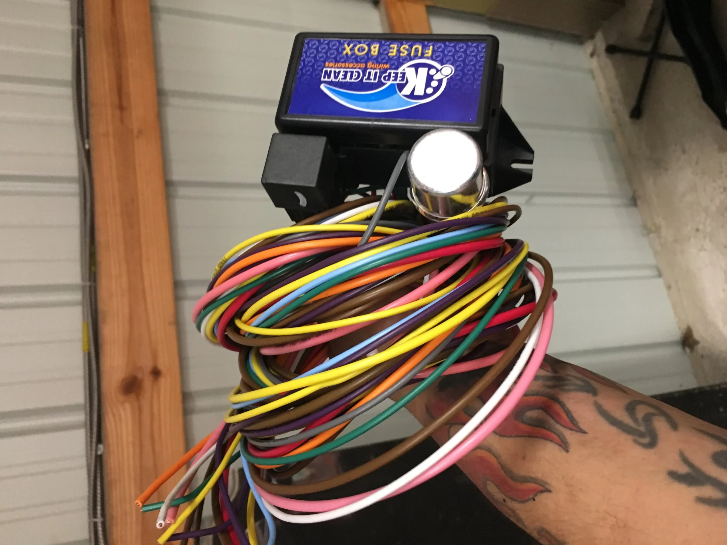

Also ditched the cutting board relay panel. It will partly be repurposed in the rear of the car but has mostly been dismantled.

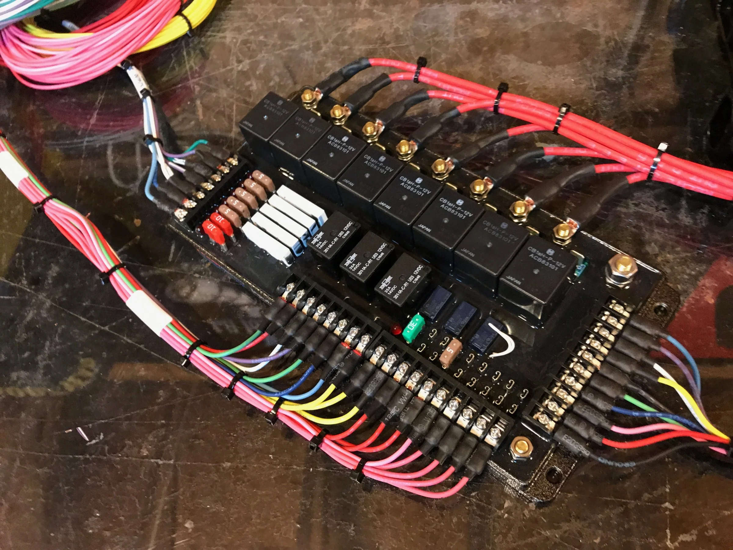

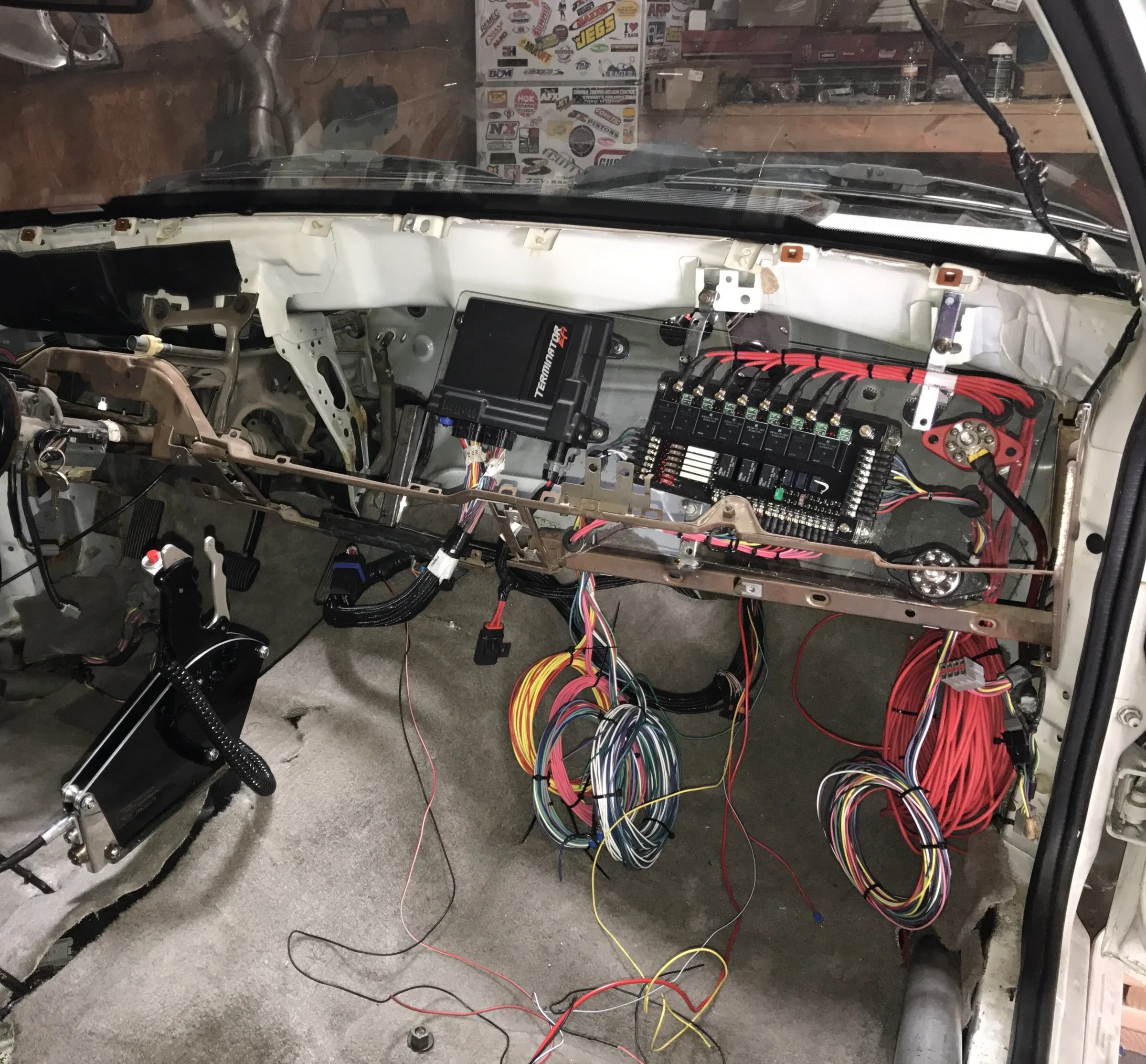

Here's what I'm working with now. Company called Leash makes some really trick relay boards and other various electronics.
This will run the lights, signals, fans, transbrake, etc.
I think I'll separate the fuel pump(s) wiring out back to run less wire through the car. Otherwise this is the new home for most everything.
Mounted it all to a thick sheet of lexan. This picture is before I cleaned up the edges and all that, so just pretend it's pretty. The grommets through the lexan came out pretty good.
Here's where I'm at as of now. I've got some other terminals to add likely to the left of the ECU but it all hides behind the dash nicely and I die a little less inside looking at this.
I'm sure running all this wire will prove to be a blast as well.

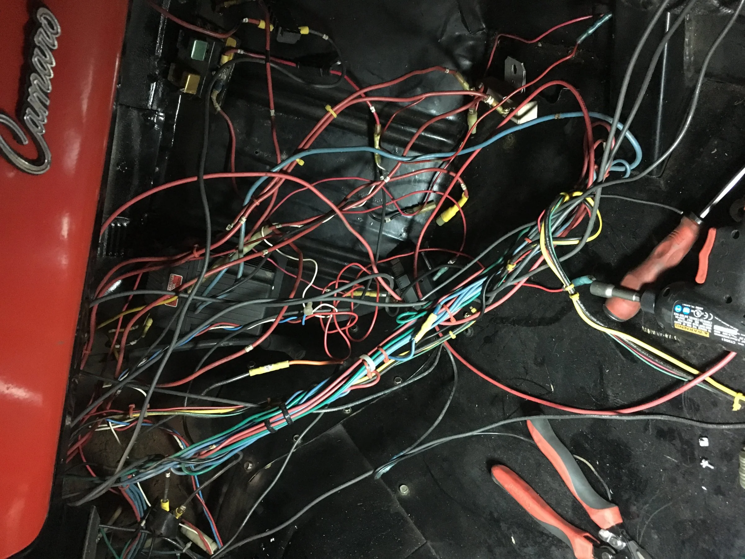

Tanner, I feel your pain with electrical. A friend of mine brought his "Pro Street" 68 Camaro to me because the ignition was breaking up. He bought the car from someone, asked if I could take a look. Here's a few pics of what I found as I removed covers, and what I did with it.
$80 on Ebay got me this "starter kit" to which I used only about half of the circuits available to properly wire up the car. It's actually a bada$$ deal for $80. It comes with 12 circuits, a relay, flasher, and every wire is labeled with its function every 8 to 12 inches. Makes wiring very easy.
