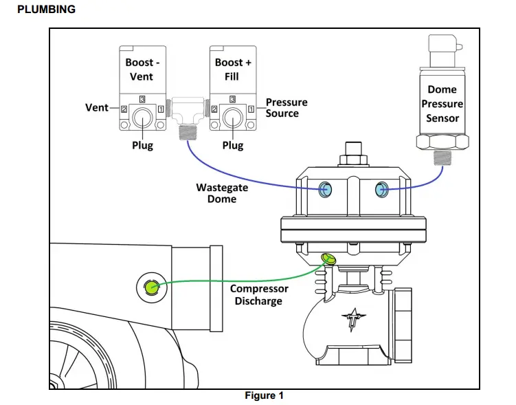

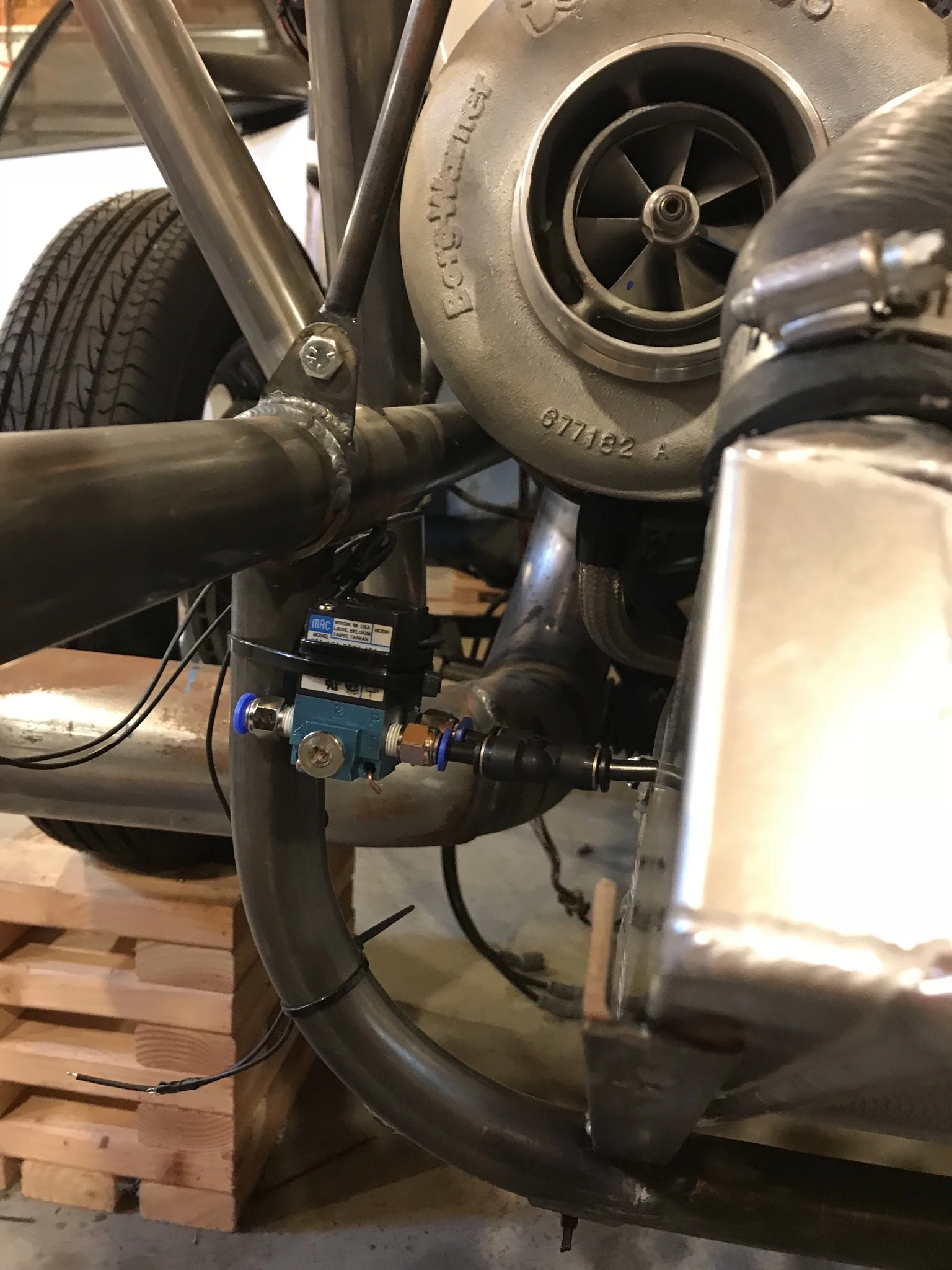

I hit a roadblock of sorts today regarding my wiring.
I didn’t account for my ECU needing a transbrake signal when I wired it up to operate independent of everything else. Just activated by the shifter button. The ECU signal would be used for 2step activation, launch control and other things I can’t think of at the moment. I’ve got a wire I can run specifically for that purpose but without knowing if the transbrake wiring is isolated well enough (or at all), I’m at a stand still until I can call Leash. If it’s not, flyback voltage has been known to melt an ECU or two apparently

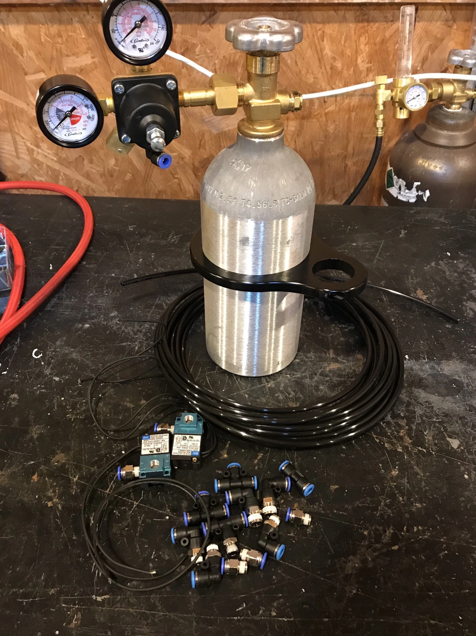

Got my c02 setup dropped off today as well. Bought a couple Mac valves to handle the boost control. Also bought another 30 feet of pushlock tubing and he threw in some fittings. I’m finding you can’t have too many of them.
It appears I’ll have to use up 2 PWM- outputs to run the solenoids, as well as a 5v input to read the dome pressure sensor. (I should have bought a dominator ECU, but that extra $1,000 was hard to come off of)
Once I figure out where to mount the dang solenoids I can start plumbing the c02 lines.
I’ve been told that the closer you can get the solenoids to the gates, the better the control is. Now to what degree it is “better”, I’ve not got a clue. Hopefully it’s substantial enough to make mounting them out in the bay somewhere worth it. You’ll have to excuse my zipties and tape for the moment. I’m a visual learner. Thinking I might build a bracket and maybe a little heat shield and stick them out here. They would be very close to the gates and easy to access.
Other than in a fender, I’ve not come up with many other ideas. Water exposure may be a concern too, though I don’t anticipate running into much rain.

Awesome progress man. I can’t speak for there placement being wrong or right-but it sure looks good

Maybe I missed something..... what is the co2 for again? Why are you burning up 2 pwm outs?(can both of them be configured properly for the application).
tannerc91gt
This last 25% is foreign territory at this point
4,392
2,967
Indiana
Oct 19, 2017
#1,104
  • Oct 19, 2017
  • #1,104
C02 is applied to the gate in place of manifold pressure. A good amount of people run a regulated on-board air compressor, which I think is the better option. But going to use c02 for now.
One solenoid is to fill, one is to dump.
This is the only way I’ve seen c02/air setup and the way Holley recommends even with manifold pressure.

I run two BOV in my application. Use a 2 1/2 lb CO2 bottle. Works great.

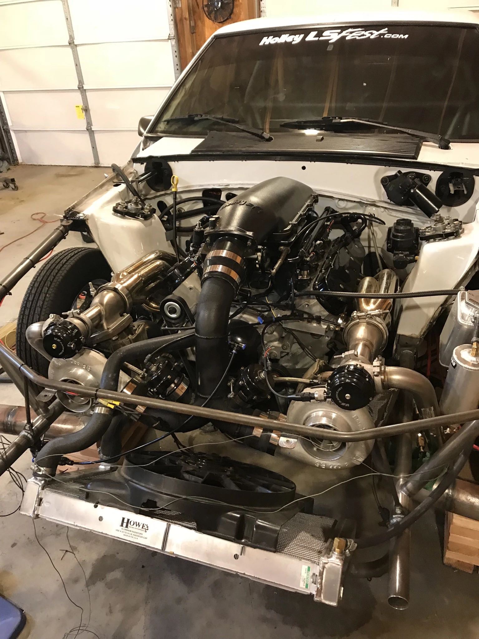

On this weeks episode of “I break everything I touch”. Managed to break off a chunk of AN fitting in my regulator. Took it apart to make sure I hadn’t busted the diaphragm. With it apart, I was able to see I was using the wrong fitting. Should have been obvious from the whole, breaking 2 fittings installing it part, but nevertheless. So I filed down the end of the AN fitting so it wouldn’t contact the body of the regulator. Hopefully it seals, we shall see. Should have thrown an extra fitting on my summit order...
Ordered a steam vent kit. The back ports are currently blocked off which has been proven to be detrimental to even cooling across the cylinder heads. Going to flip the center block and run a -4AN line out the back and around to my expansion tank.
That will let me finally solve the problem of that hideous rubber hose you can see hanging above the drivers side header.
Nevermind that it would have melted within the first mile and pissed coolant everywhere :/
Also bit the bullet and replaced the $110 return line that I managed to slash a chunk out of in the engine bay. That one hurt a little.

@tannerc91gt
That solenoid looks awful damned close to a lot of HOT stuff.

@tannerc91gt
Don’t think it would be a problem properly shielded. That said, it likely won’t end up being its home. Going to pull the intake and stuff off Tuesday for the coolant system and I’ll have a chance to reroute some plumbing then.

Finished wiring up the starter, popped some fuses in on the Leash board and tested it out. Everything seems to be functioning as it should.
Couldn’t stand the cockeyed regulator on the rail so I ordered the correct fitting to straighten it up. Luckily that means my makeshift straight cut fitting was short lived.
Replaced the damaged return line as well and was able route it the way I wished I had done the first time so there was a silver lining to my $100 whoopsie.
Working on a new start up tune tonight since I’ve changed a lot on the car, including the switch to ethanol. If the fitting shows up tomorrow, I will get to fire up the car for the first time (again).
If not, it will definitely happen on Thursday.
Getting to hear the engine run has always proven to be the best motivation for me.
My Amish gas station worked great also. Little heavy on the manual labor for my liking but the harbor freight pump even threaded into my barrel. Pay no attention to the entire foxbody interior stacked up on my couch and half the front end laying on the floor.
