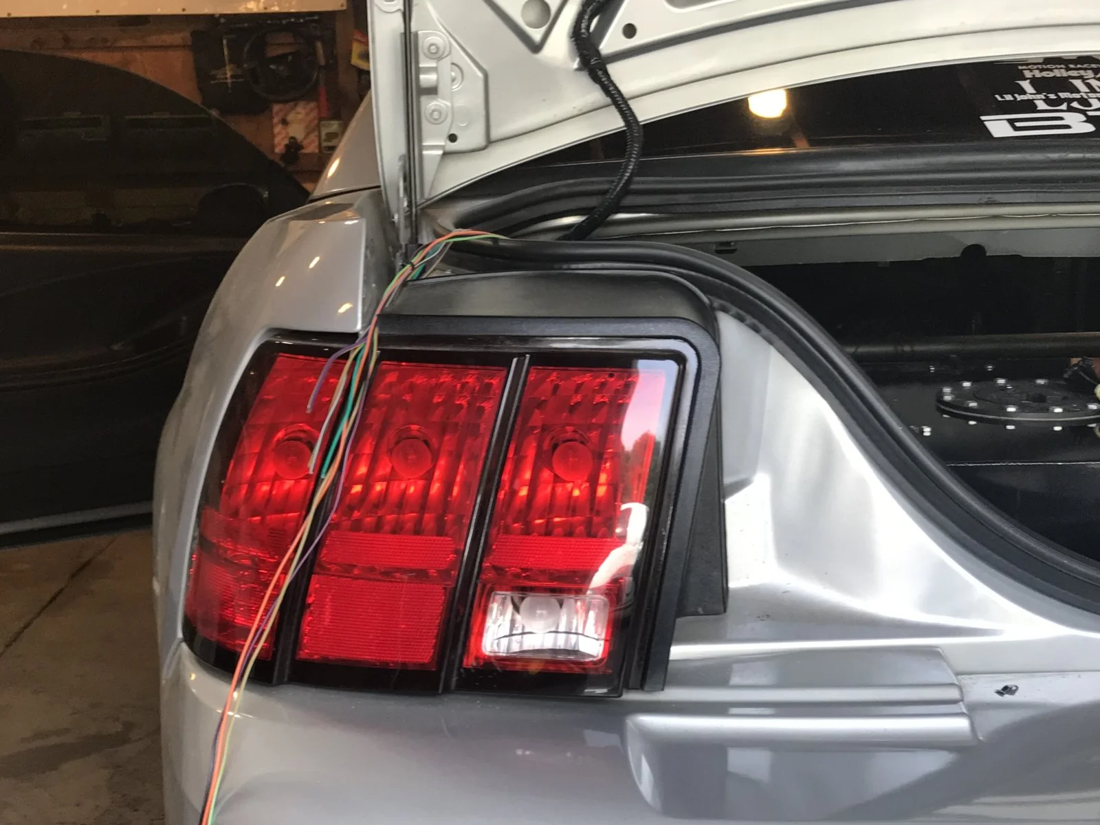

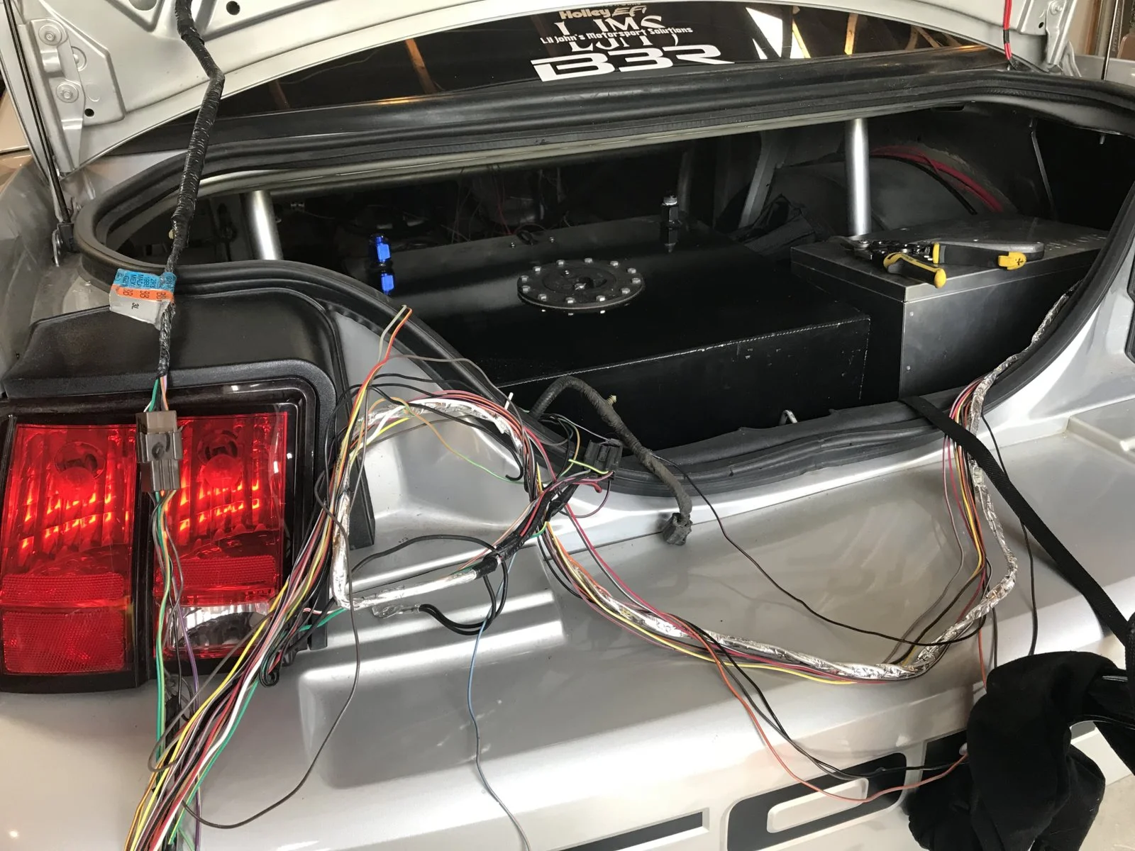

Tore into the rear light wiring today.
Luckily I had a little help
Got it thinned out to what I’ll be able to reuse. Not sure how I’ll wire the reverse lights back in with this particular setup but otherwise the brake lights seemed to work.

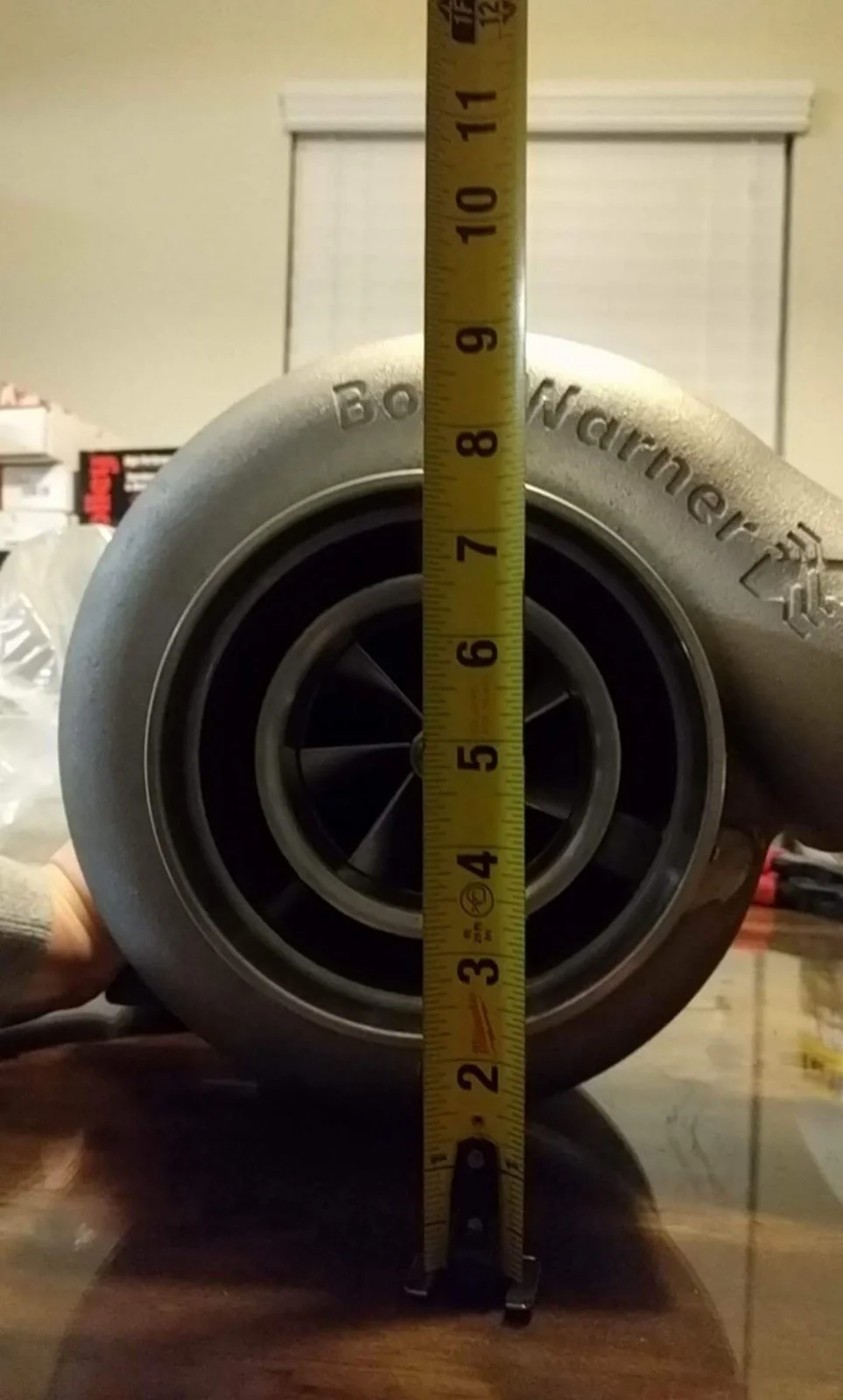

Sold the scavenge pump as well. And this evening I bought a single billet 85. Excited about the project again.

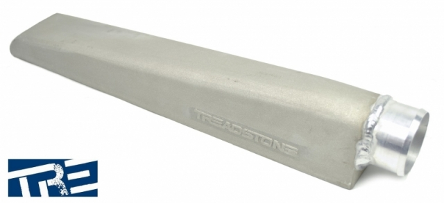

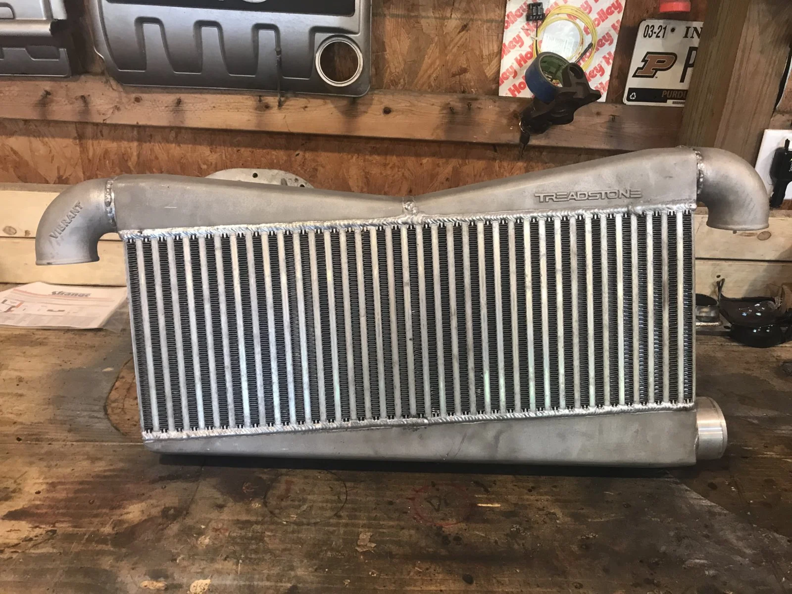

Going to cut off the twin 2.5” inlets and weld on a new end tank on the IC I already have.

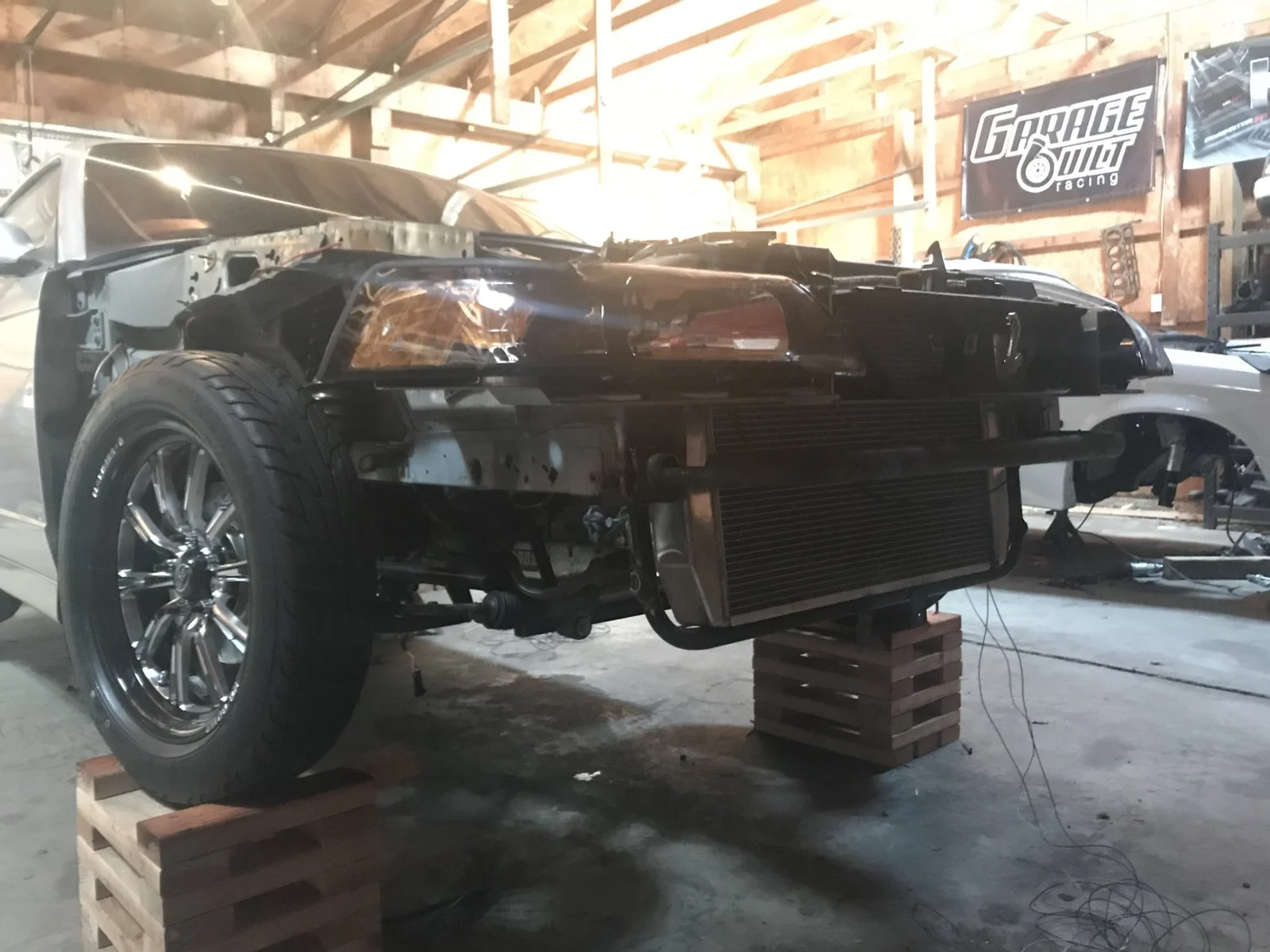

Preparing to cut the bumper support off and build better Ic mounts as well.

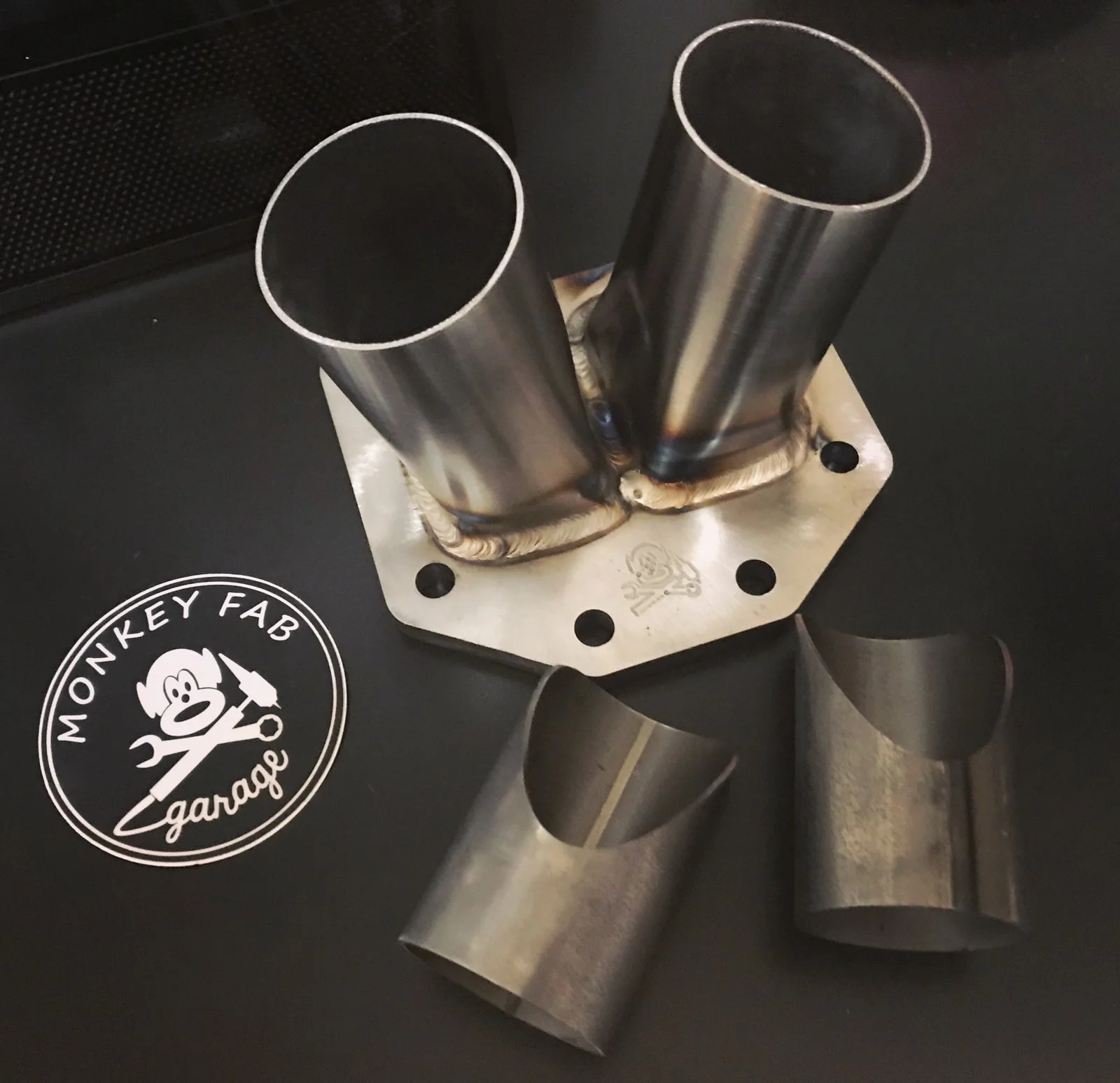

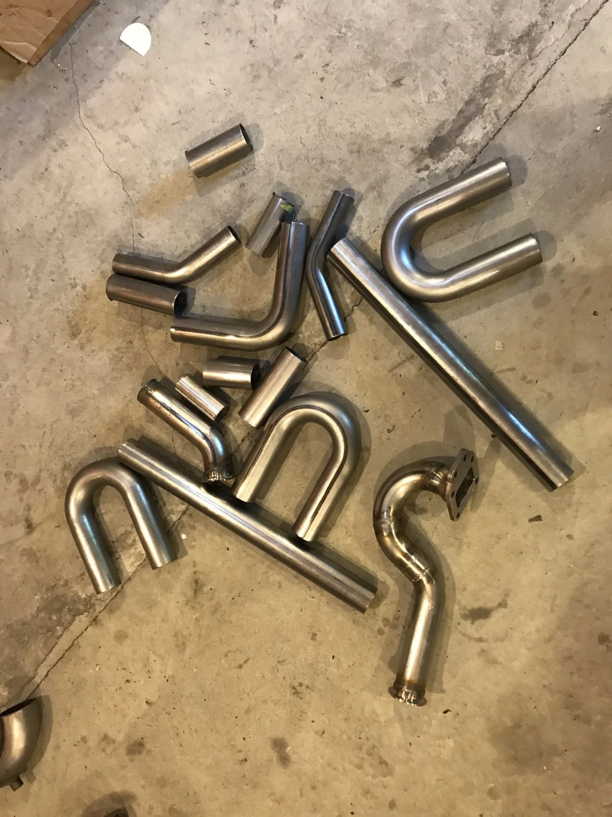

If my turbo ships tomorrow I’ll start building the new hotside this weekend.
Luckily had enough unused bends to build what I’m wanting.
The downpipe will be interesting, stay tuned for that.

Awesome man. Congrats on the new job. Glad to hear your motivation is back. Are you going to just cap off one of the inlets on your ic?
No sir, the 2.5” is too small for a single inlet IMO. Cutting off that end tank entirely and welding on a new one with a single inlet.
$60 investment over taking a bath on the IC sale and buying a new one.
Ha-I actually have experience here-first time I can actually be somewhat helpful in your thread.. Re tanking IC’s is a pain in the a$$ lol. Clean material is key,and lots of heat.pre heat everything

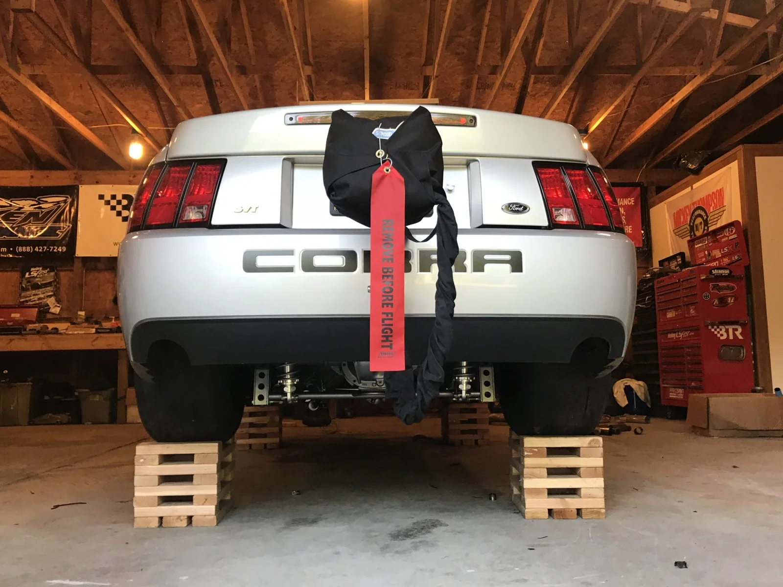

So, to make a long story short, the upper control arm bolts were a bigger diameter than the new bushings I had to order. Old ones were stuck in old housing.
Through a series of bad decisions I basically destroyed a $150 set of bushings. They were in pieces and one of the threads was trashed.
Stubbornness and a lot of quality time with a file prevailed and I managed to put them back together.
So having the rear end squared up and back on the “ground” is a victory for idiots everywhere.
The bad news for the day is that Treadstone must have sunk their only boat from China because that end tank is 8+ weeks backordered. I have no plan b.

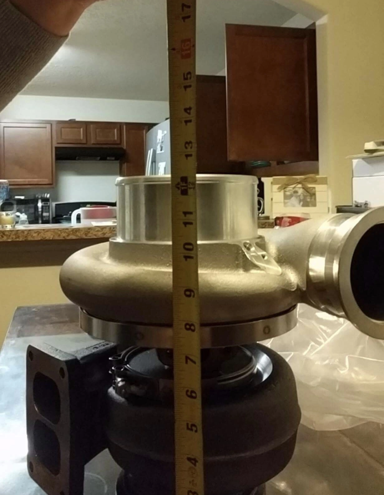

I do have a couple not-that-great teaser shots of the new turbo. Should be shipping out tomorrow so maybe by the weekend I’ll have some better ones.
You go boy! Personally, there would be no way on Earth I'd attempt Aluminum TIG welding on an intercooler considering how many of those cooling fins I'd probably melt through.
