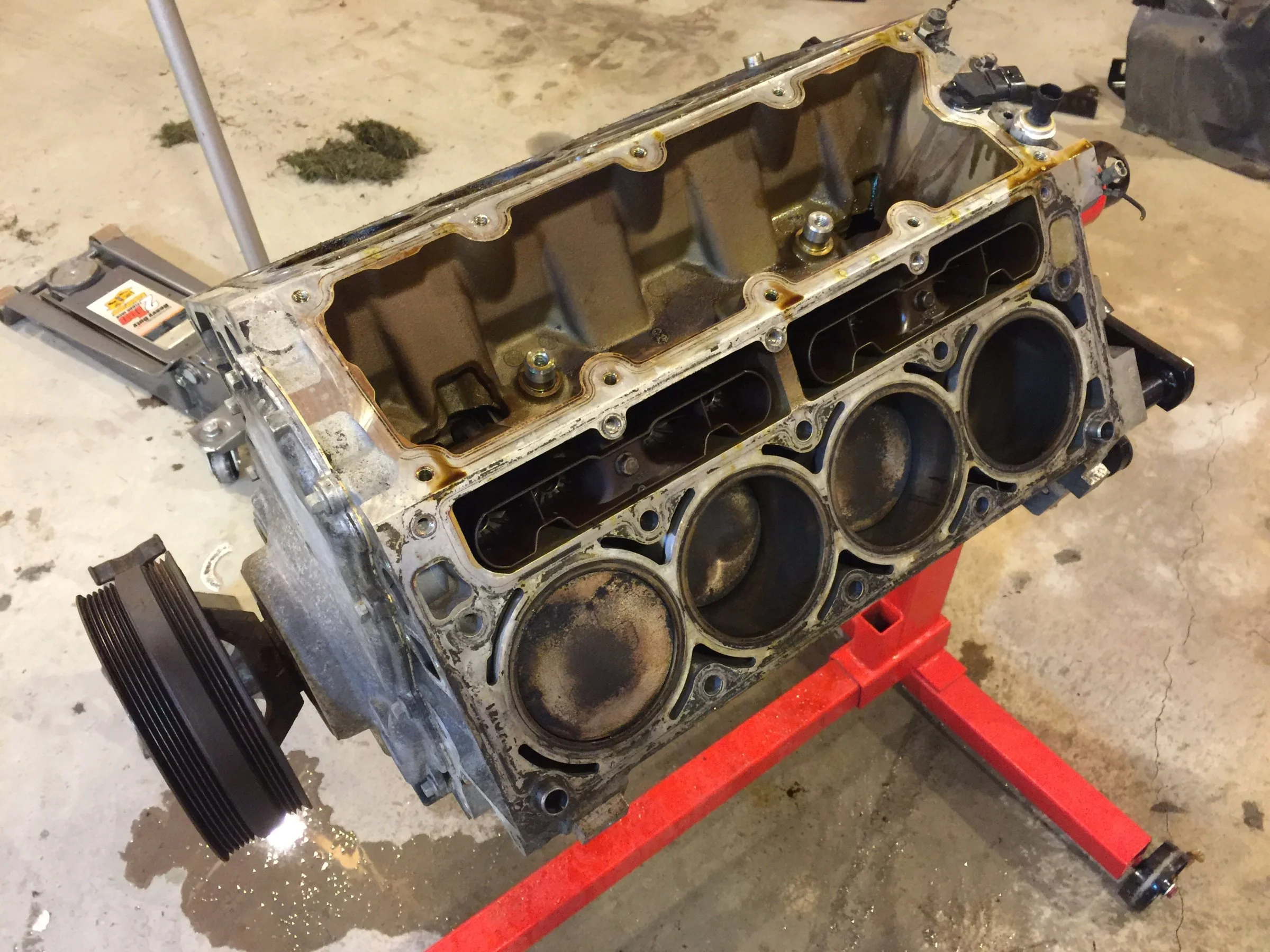

The truck manifold is actually better through most of the power band, it just falls on its face about 5500 rpm. The ls1/Ls2 manifolds aren't all that great at all. Mostly irrelevant on a turbo car like this one though.
Car intake is just cleaner looking and fits under the hood better.
I've got a bare 6.0 block in there now with a set of LS1 heads I had on my work bench. Just for mock up purposes. The block isn't "junk" but it's .040 over and that's completely useless to anyone.

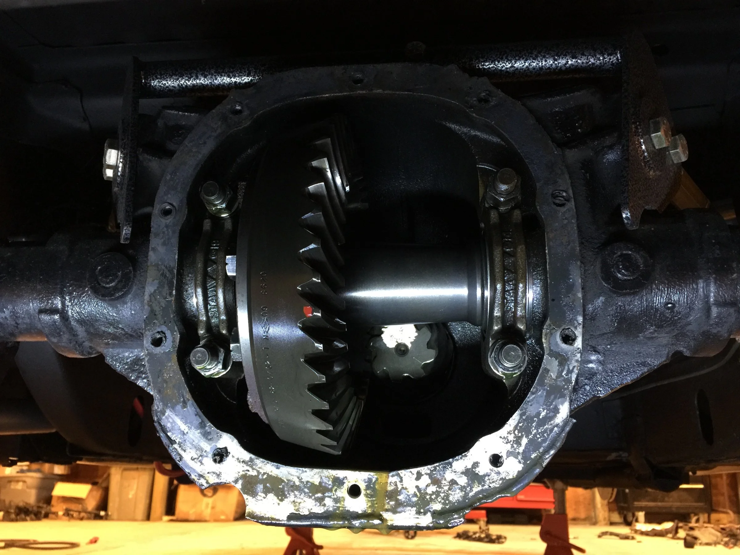

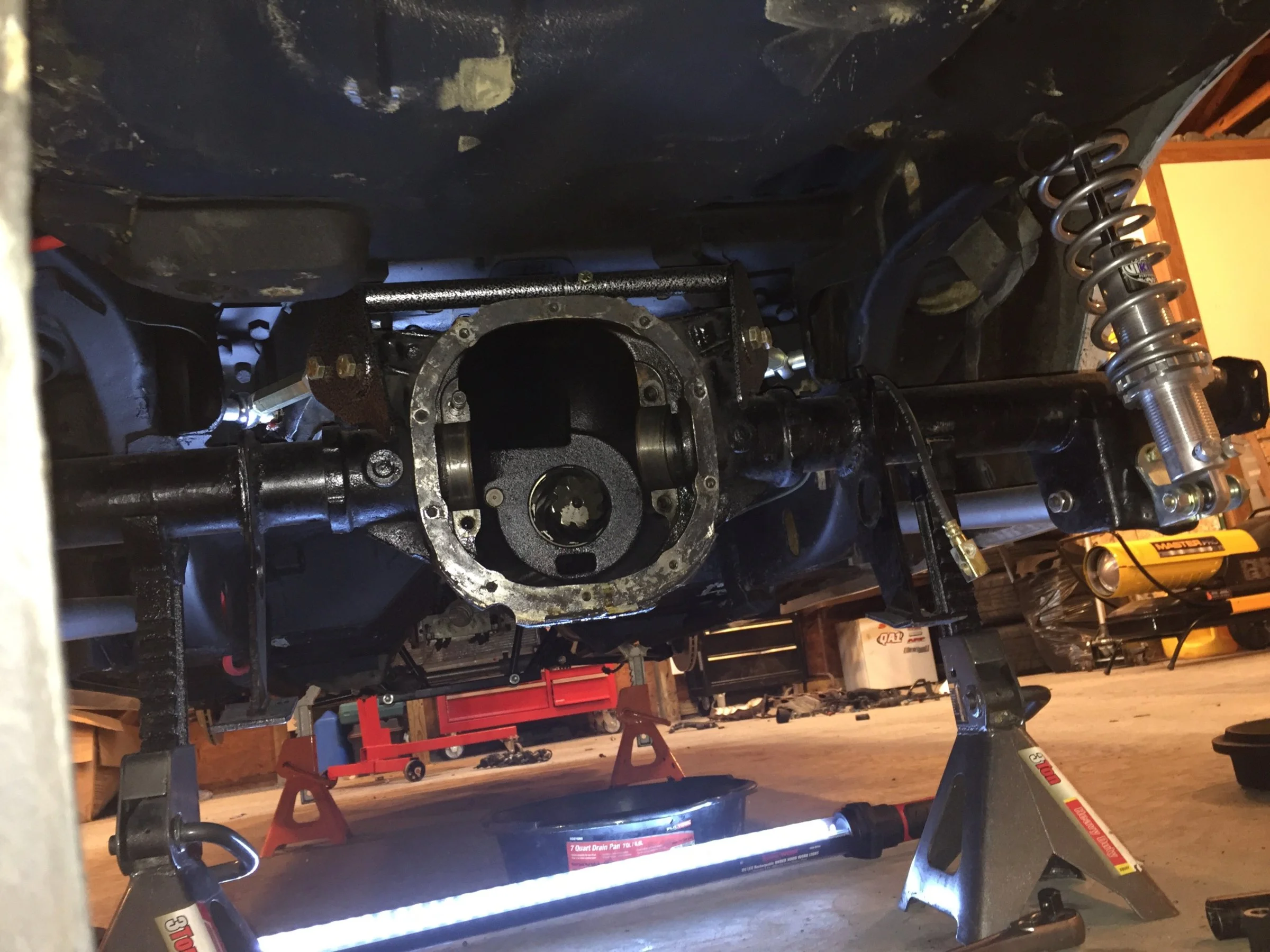

Pulled the cover off my 8.8 tonight. Previous owner didn't know what rear gears it had. 4.88s is the answer. Makes me curious what the old combo was.
Also, potentially the thickest ring gear I've ever seen

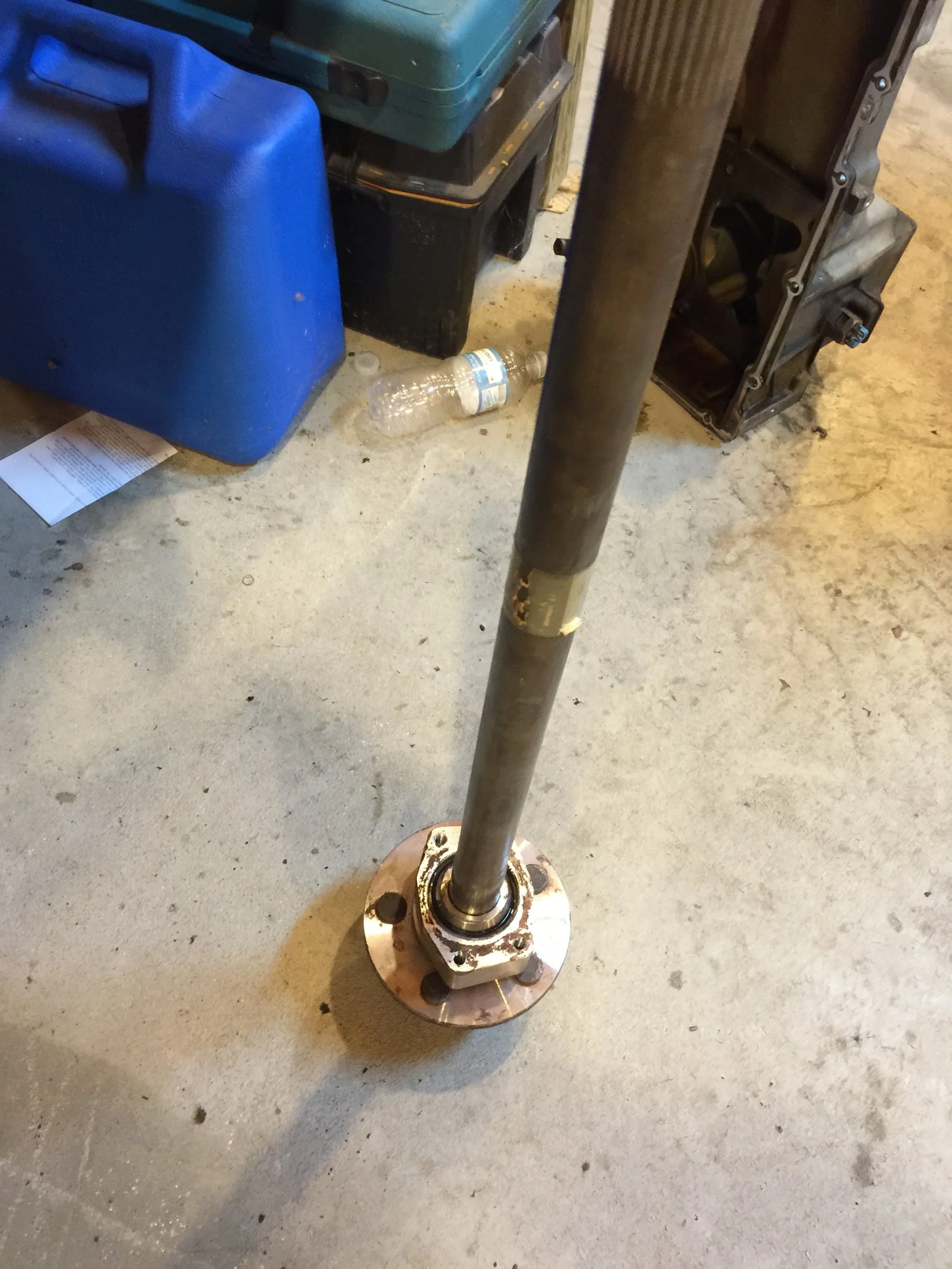

31 spline mosers with eliminators.
Car has drums on the rear, I want to switch to discs but I think there's something to do with the eliminators and wheel spacing from drums to discs and I'm having trouble remembering what the catch was. Maybe I'm making it up. :shrug:

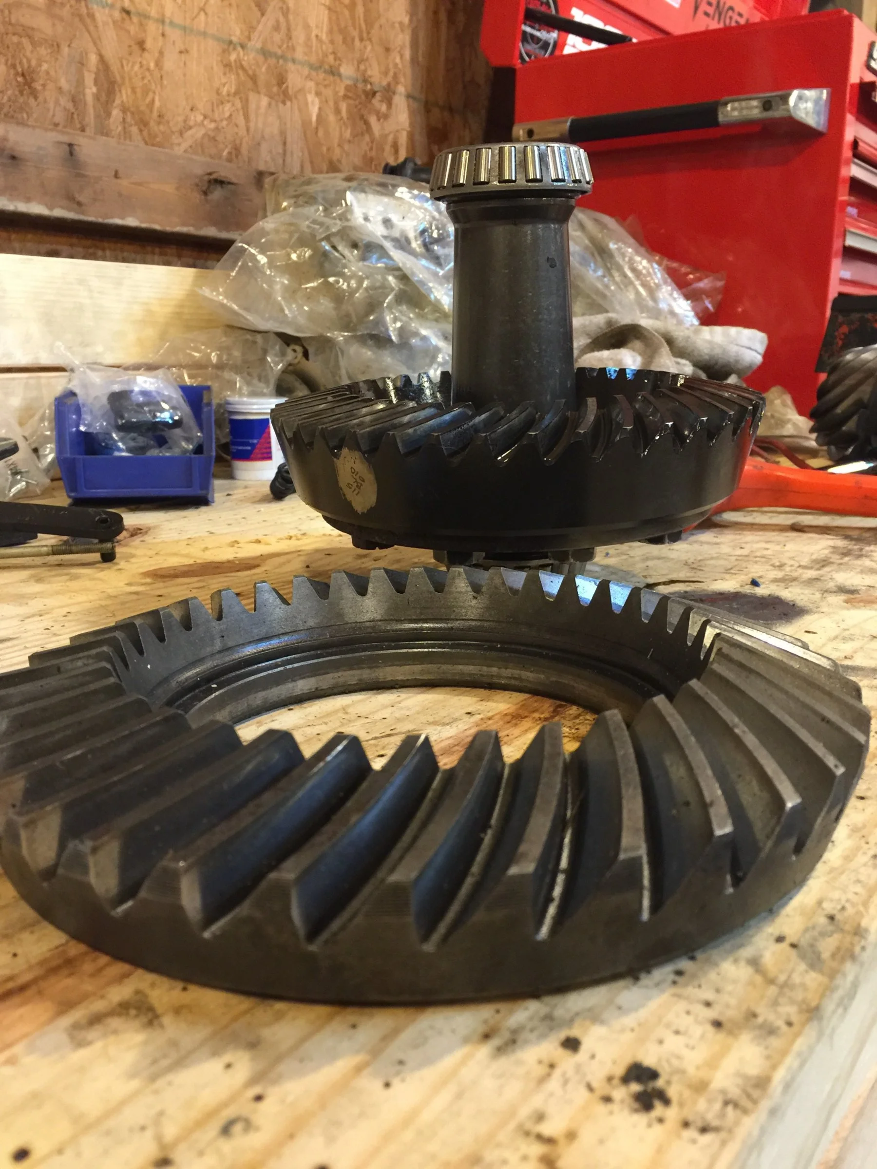

I've got a set of 3.27s on my shelf and a shim kit I guess I'll swap them this week.
Crazy the difference between the Richmond ring gear and the FRPP piece in the foreground

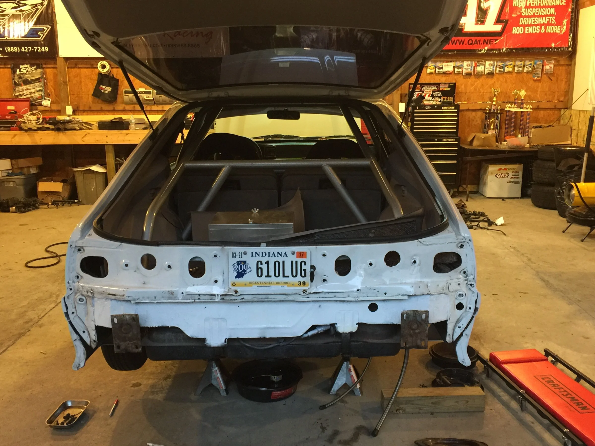

Also spray bombed the area normally covered by the rear bumper. It was off color and starting to think about rusting. You'll never see it but it bothered me so I "improved" it.
This was while I prepped to finally put the moly rear bumper support on. Which upon realizing id have to cut off the ends sticking out I had second thoughts as to future implications. I don't intend to put the old support back on as its heavy as hell but don't want to get ahead of myself and whoopsie something
Have to round up an air compressor to make any more progress but I haven't found any surprises yet.

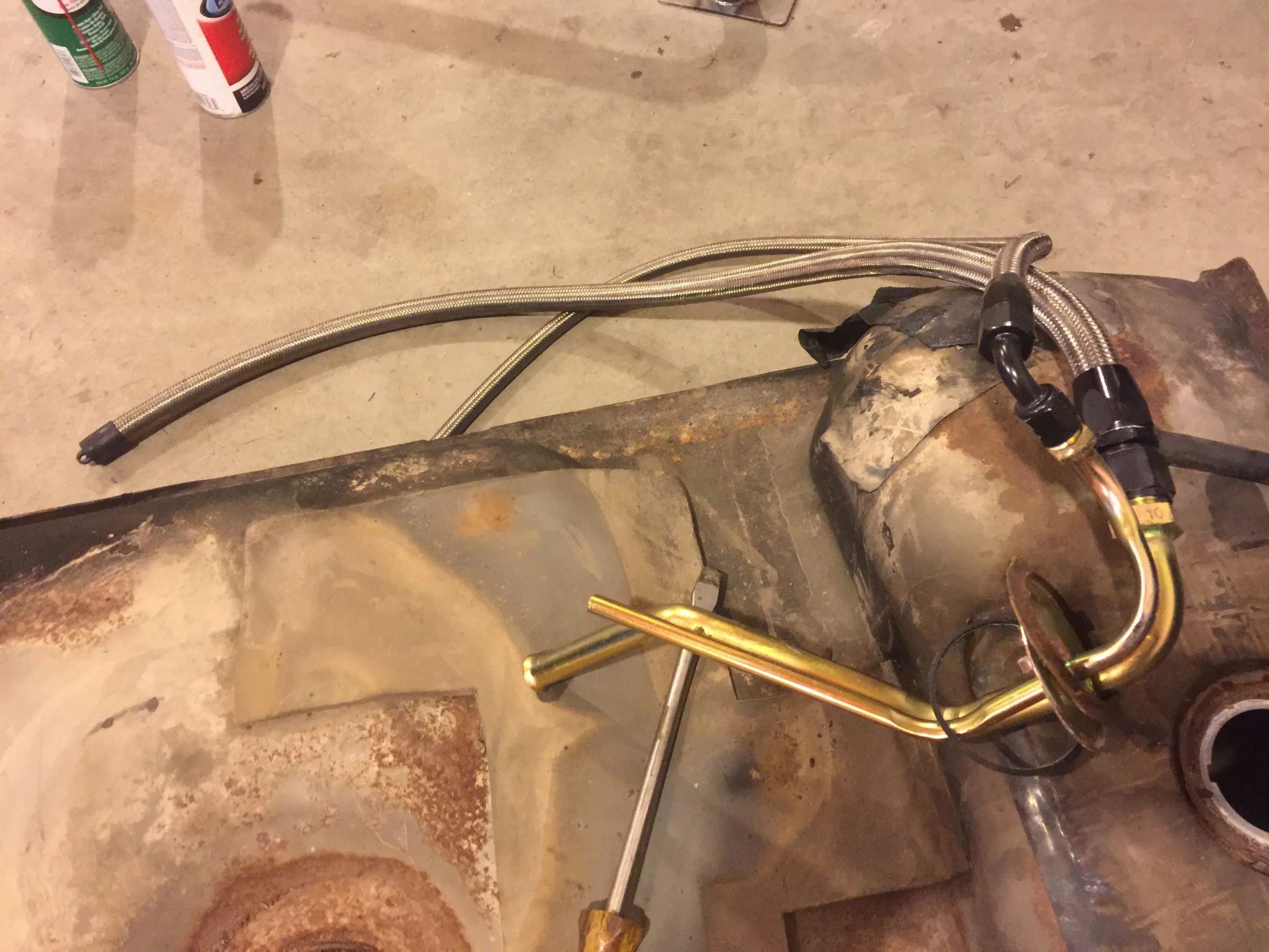

This stock location fuel pick up is pretty cool. I'll have to do some research as to its efficiency but looks like a -10 feed and a -6 return. Granatelli I think?

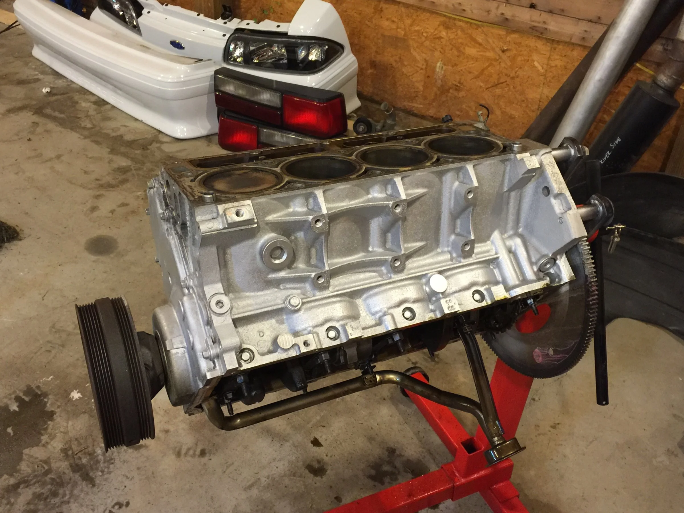

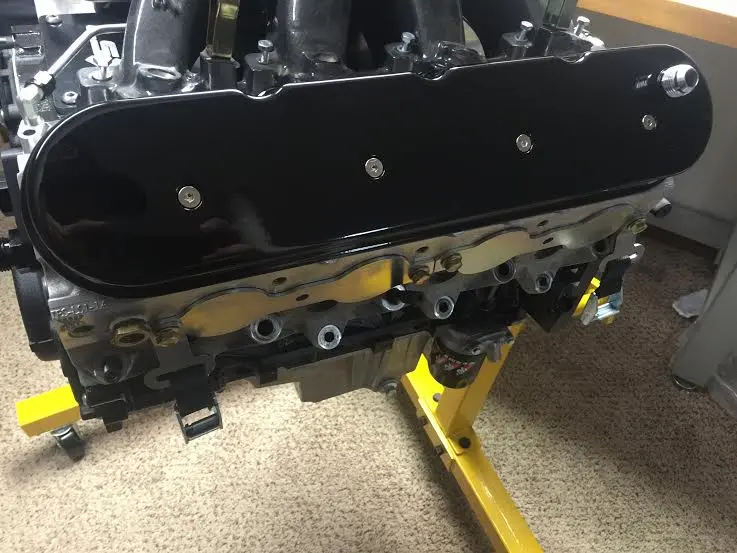

Pretty much all I got done today was a shortblock inspection and a fresh coat of paint.
Very clean and turns over like butter. On the fence about gapping the rings.
Borrowed a compressor and swapped the new ring gear over. Still having a tough time getting the pinion gear out and need to go buy a puller tomorrow. I think I've got one for the companion flange but need one for the crank pulley. They're weird.

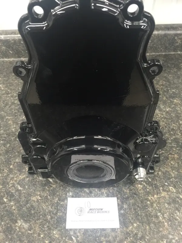

Picked up some stuff on a Labor Day "sale". Instead of having a set of stock covers welded up with AN fittings for a catch can, I grabbed a nice set of covers. Will have to relocate my coils but it'll look good. Got a timing cover as well for the oil drain lines. Wont have to mess with tapping an oil pan now.
