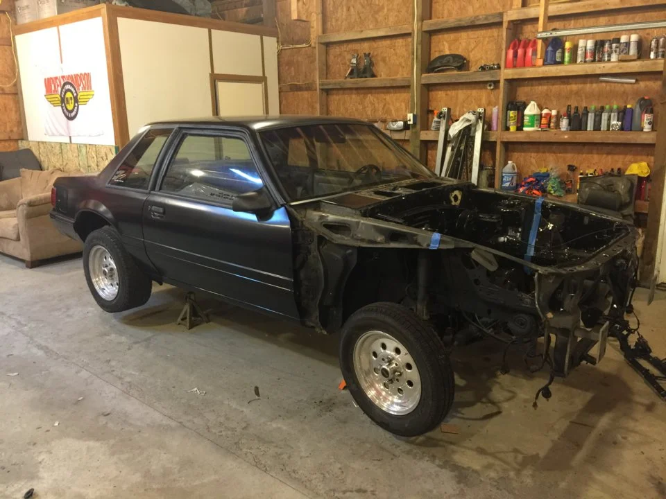

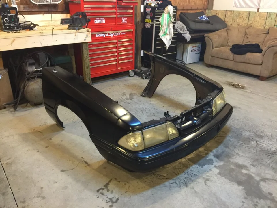

I agree, love the 85-86 nose. They swapped interiors also. Which is what you see before you

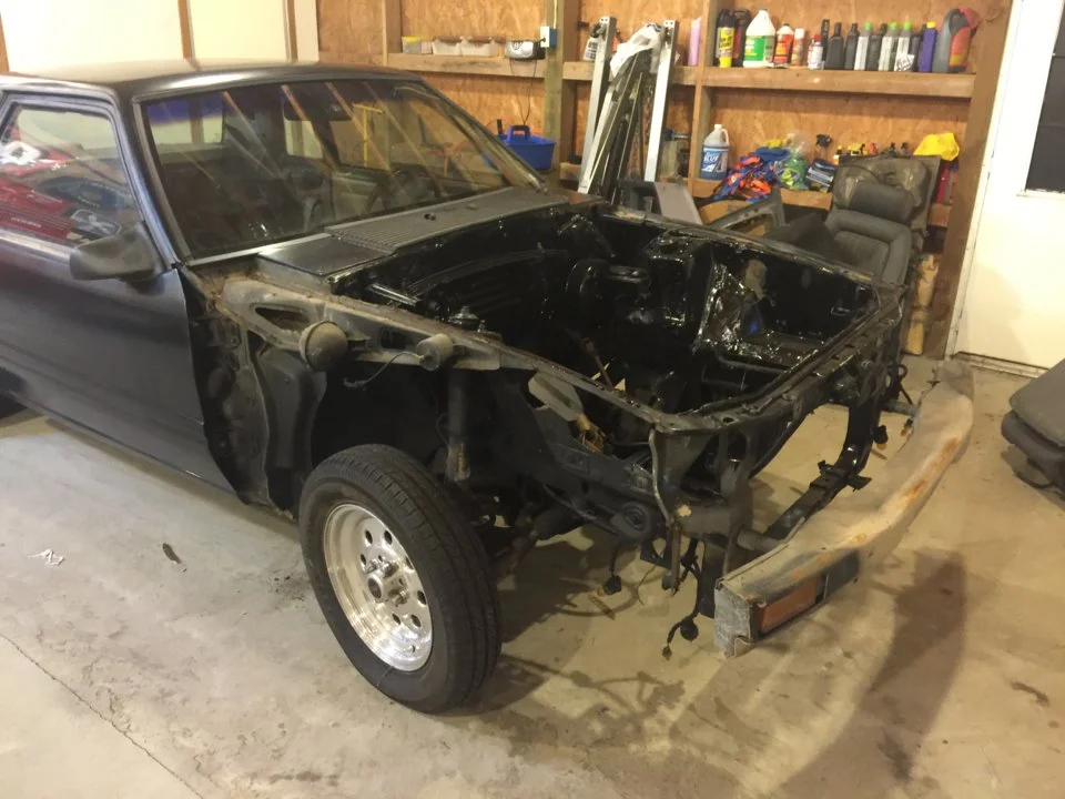

Time to get to work
Turn signals in the crash bumper are odd. Don't know much about 4 eyes cars though, sure doesn't seem factory to me?
Edit:they're factory
The more you know!
