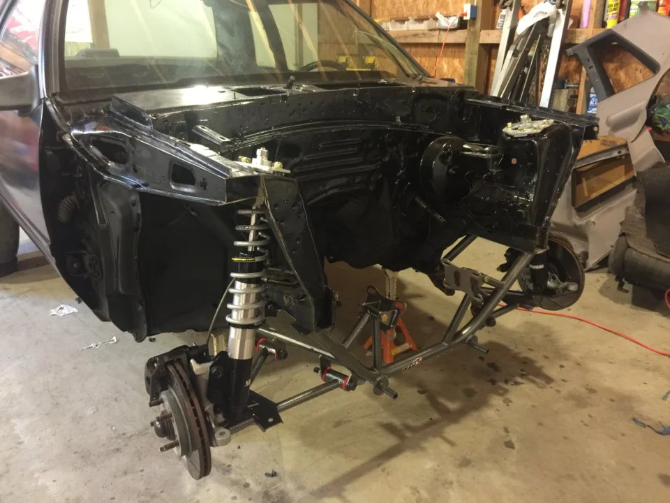

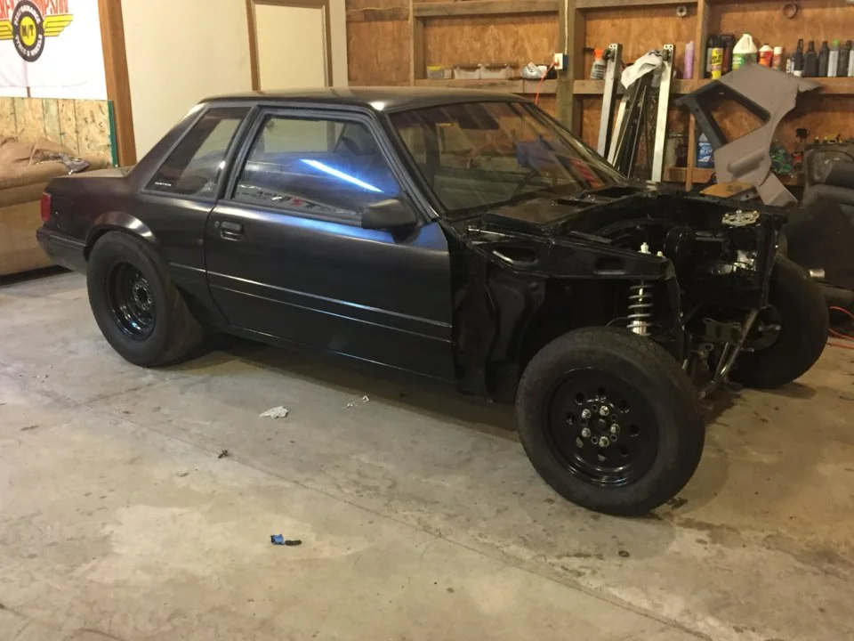

K member, CC plates, coilovers, strange 10 ways, sn95 brakes All got thrown on tonight (wild New Year's Eve I know)
Tommorow is my birthday so we usually get the family together, had to get it done while I could.
The rear end isn't done, it's all over the floor. But I lowered the rear down over the tire to give myself some motivation I guess.
If I get a chance this weekend I want to clean up the front end and box in the frame rail ends.

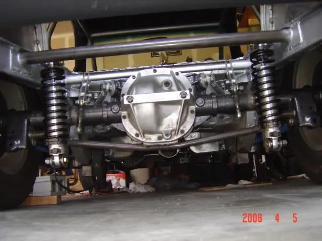

What did you do for rear shocks/springs when you minitubbed?
I keep going back to wanting to tub this car. I just do, that's as far as the reasoning goes. I want to be able to lower the car. Possibly narrow the rear and run a better looking wheel and a bigger tire.
Obviously that cuts out the factory shock mount.
Team Z's kit has a support bar between the rear wells and moves the coilovers inward. This is the only logical answer I think.
I'm sure there are more choices

What you have pictured is the easiest way to skin this cat, if you are putting a roll bar in this car and wanted to do something a little more trick, you can mount that cross bar as part of the roll cage and run a longer shock through the floor.
If/when you mini tub the car, make sure that you notch the rails to get enough clearance to slam the car if that's what you're after. You will also need to consider adjustable mounting points for the upper control arms once the car is that low to the ground to fix the suspension geometry that you just destroyed :)
