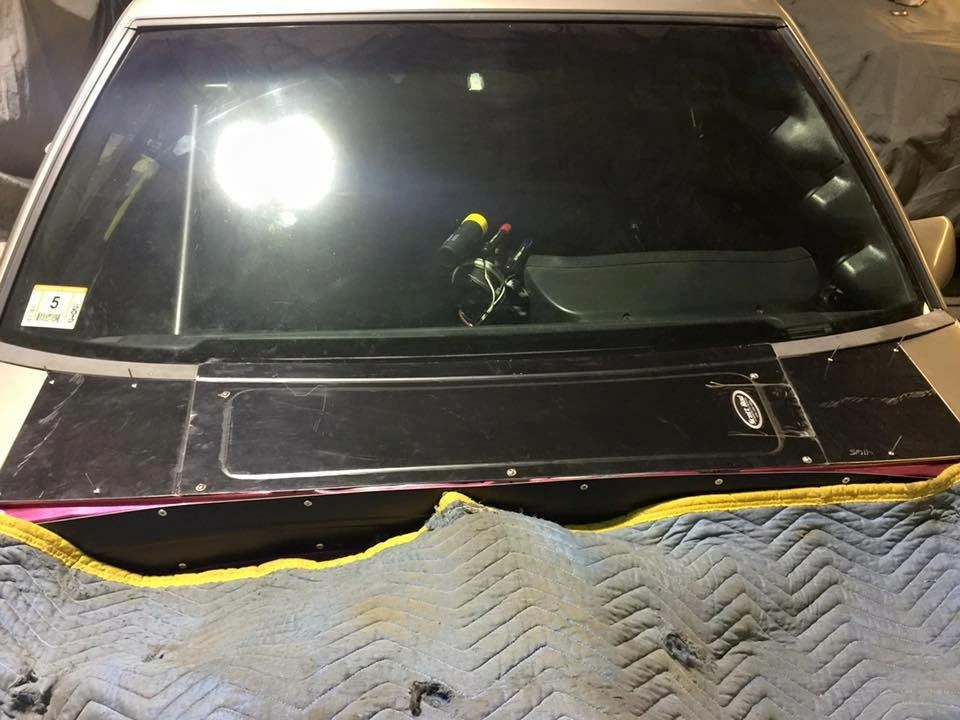

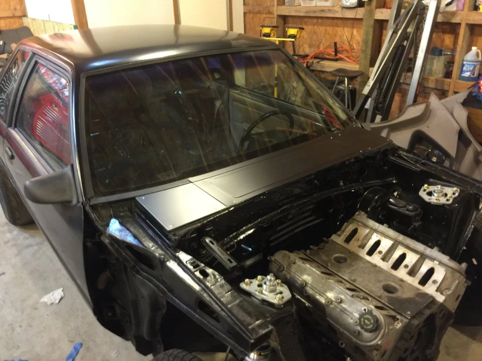

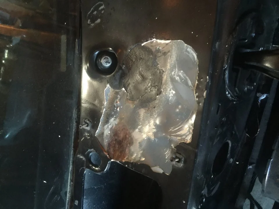

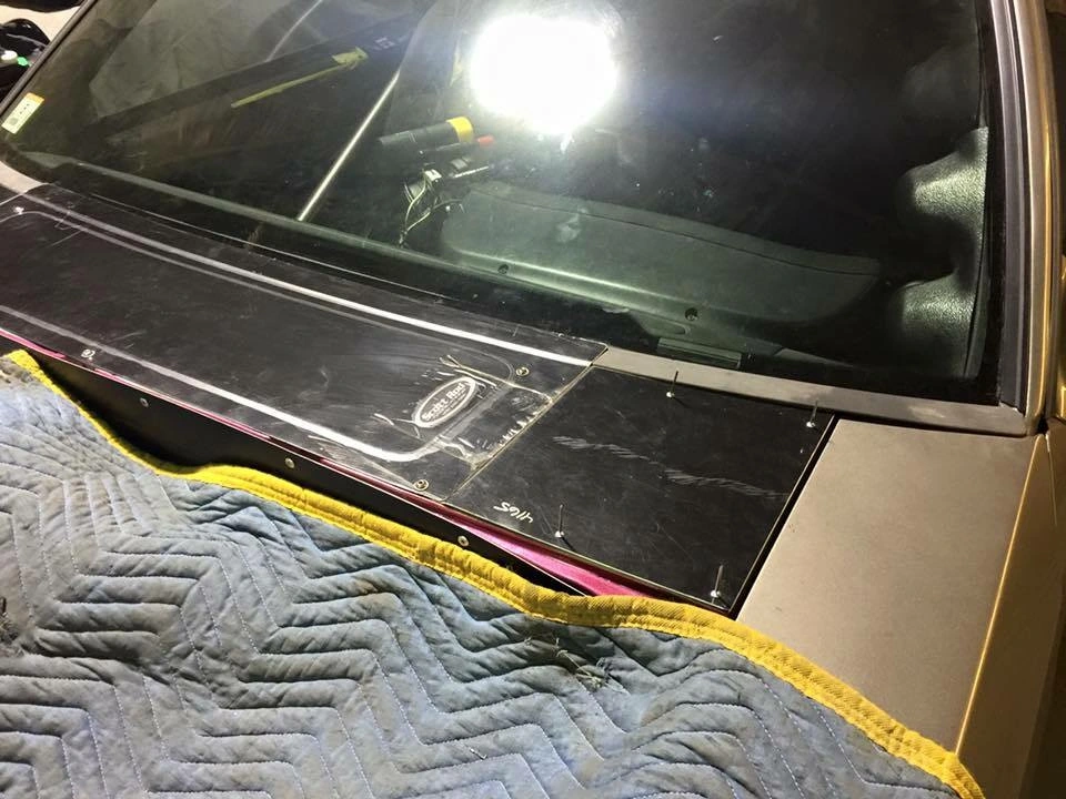

Here's a fun update.
My coupe is very straight. It's been painted underneath and the floors and engine bay were painted and sealed, rust free etc etc.
Except....
the cowl had been damaged and "repaired". You could see the poor filler work on the passenger side, and the drivers side was even worse. But I was aware of it, and it was still cheap enough to carry on with the purchase.
Fast forward to a couple days ago and it's flip flopped between 50s and freezing ass cold enough that the Bondo on the drivers side seperated from the sheet metal and there was a nice sized crack.
Which I turned into this fine crater you see before you
(any women or small children should leave the room now, I'll wait)
It was over 1/8" thick in some places. They didn't bother to pull the dent at all. Just gobbed in filler until it was perfect...if you stood back 20' and squinted real hard
The other side is much better but still terrible.
Previously the only real option was to find a clean cowl on a JY car and cut it out. Then go home. Pull the hood and fenders and cowl vent and windshield and the glovebox and left taillight and then drill out the spot welds under the windshield, and patch in your new piece. Sounds like a blast.
Turns out there's an alternative... If you don't mind ditching the windshield wipers.
Scottrod is making the extension pieces to cover this area. Paired with the cowl vent delete and I think it's a nice looking alternative.
I've ordered it in satin black.
Reactions: Davedacarpainter and A5literMan

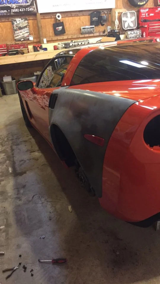

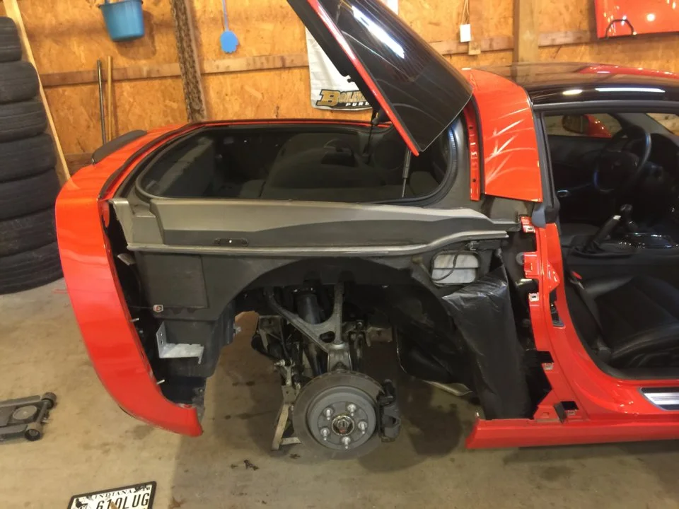

Had a chance to do a big project I've been itching to do since I bought my corvette and was able to make a decent PROFIT for once so it went down the road.
Started the corvette project last week.

Beginning stages of a complete OEM widebody conversion
Reactions: Boosted92LX, 90lxcoupe and RaggedGT

RaggedGT said:
Is a big brake kit and very wide wheels coming next?
Won't be a big brake kit. They're z06 quarters, so will be able to fit a 12" wheel and a 345 tire.
