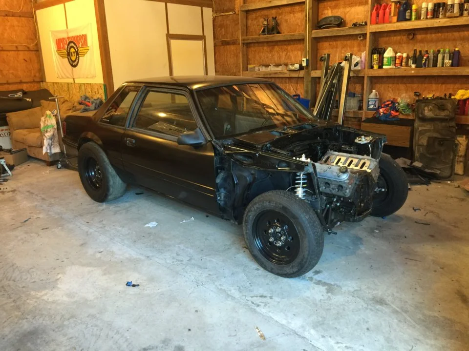

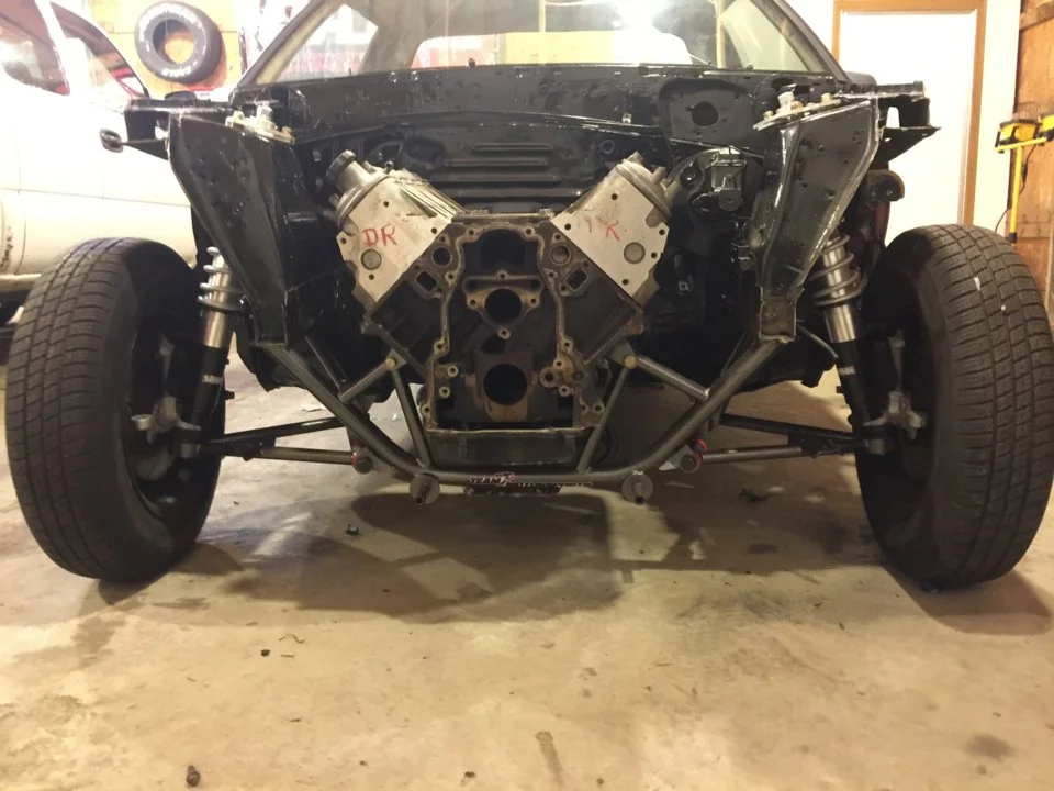

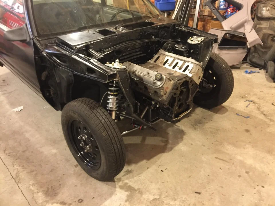

It's cold and my garage looks like a war zone. But the mockup motor is in so we'll call it a victory for the day

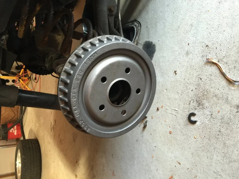

Dem fancy Ranger Drums right there
Found a set of Moser 28 splines cheap and grabbed a set of ranger drums for $50. Gonna put this rear end back together as is.
Really hoping to find someone selling a built 8.8 and just swap out the whole shebang. Who knows.
Saw over on the corral classifieds a 33spline mower axle/spool etc. you could check that out?
Darn auto correct "moser" not mower lol
I'll check it out. The axle/spool/eliminator combo is a little over $600 from moser and strange. But part of me still wants to tub the rear and cut the axles down so I've kind of held off on investing in anything yet. with all the welding and bracing that I would like, I'm hoping to come across someone parting out to save some time and money.
Reactions: A5literMan
That looks great Tanner! You know i have a car that's really solid, except for the front frame rails being totally ruined from a wreck. I've thought if i could chop it all off at the firewall and weld in an entire tubular front end I'd have a good car with a title. Does anyone sell a kit to do that? @madmike1157 @84Ttop
No one really makes a kit. Since there are so many variables. You get into a little more trouble chopping it off at the firewall since you lose the shock mounts but it has been done quite a few times. Typically tied into a cage.

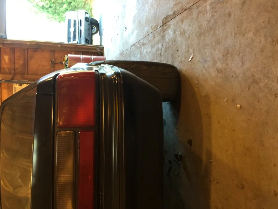

So these black draglites came on the cobra and I never paid them much attention. 275/60/15 on what I thought was a 15x10 6.5.
I've never seen this much clearance on the inside before though, so I'm gonna assume they're a 15x8 lol
Nevertheless, it's been "5 lugged" and so it shall sit
Sideways pictures FTW!
