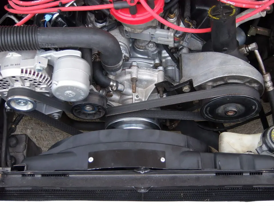

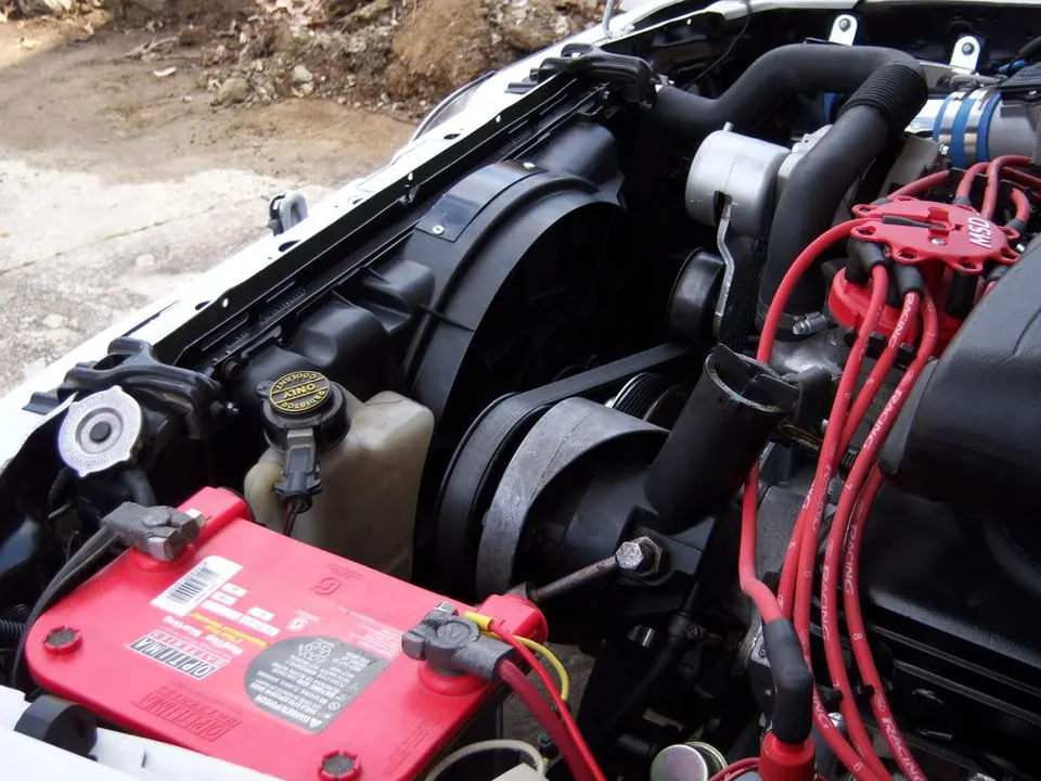

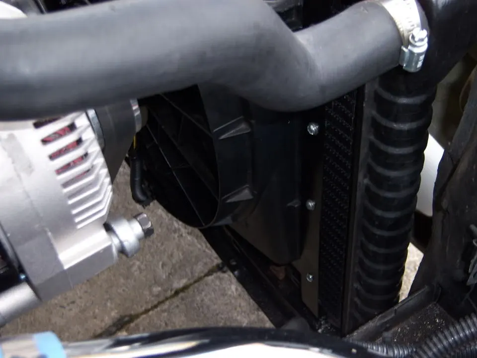

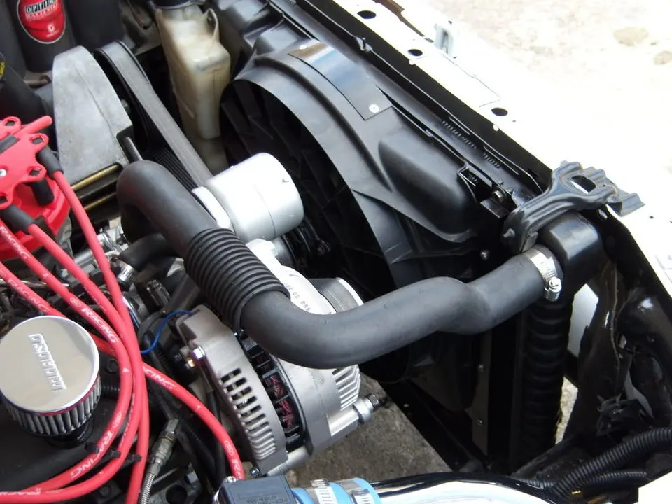

i just finished the taurus and i remember when doing the research i could find many pics of the taurus fans...just thought id post up a few, may help someone... lemme know what you guys think too

Hope yours doesn't catch fire!
Nice bracket! I just used some thin aluminum strips from home depot and a hack saw

I like it.....

Nice, thats the same fan i have. I love it, very powerful. It blows my old black magic fan out of the water.

Awesome. Looks right at home in there.

Very clean install, looks awesome! What's the black strip riveted on top for?
Edit: Never mind, forgot there was a gap there...
