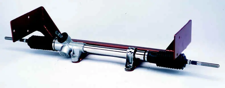

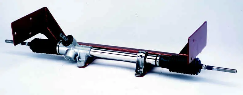

Well I fianlly got the suspension and ride hight right to where I wanted, along with the new wheels are tires. Engine is almost finished being built, then after that, its time for manual rack and pinion. Flaming river just came out with their set-up, its goes for about a grand, and TCP goes from 1400 to as low as $1050(forgot where I saw that thou). Anywaise, I was wondering if anyone had any info on the pros an cons of either, or how different they are or anything. Anyone on here with the Flaming river setup? I know we have some with TCP, are you happy with their R&P? Thanks

First off, from their website, "The rack and pinion has a travel and ratio with full turning radius that feels almost like power steering!" There's something fishy about that statement. Did they try and get that "power" feel buy increasing the steering ratio? In other words, with their manual rack, how many turns is it lock to lock vs. a power rack? A higher steering ratio sure could ease the effort, like power steering does, but I'm not a fan of the trade off. Also, define "full turning radius." If they meant that the turning radius does not increase, then why didn't they say so?
Second, by looking at their site, they're using a rack with end take offs. We've discussed this issue before on this board. End take off racks tend to give some pretty nasty bump steer because it can not mimic the original geometry of the steering system in the Mustang. Granted, the OEM geometry wasn't the best either, but end take off racks tend to worsen the problem. Unless they addressed this some how (which they make no mention on their web site) then I wouldn't buy one until after I was able to drive a car that already has one of their racks installed to make sure none of the issues I've brought up are a problem.

Thanks for the replies and thanks for the comment dolfan87... Good point about the TCP being billet and the economy one not being. Having the new column would be nice, but its not something I need. I heard from a few people that the TCP rack shortens the turning radius just a bit, which could be just them installing wrong, but if it is true I would like to avoid that.
I think what you meant to say was that it increases the turning radius. If it shortened it, that would be a good thing as it would allow you to make sharper U-turns. I have heard that it doesn't change at all and also that it slightly increases the turning radius. However, I heard the increase was less than a foot (6-8 inches) which to me isn't a big deal. I've driven TCP's '67 fastback and I couldn't notice any increase in turning radius.
As far as any bumpsteer corrector kit, those kits are designed for the stock steering geometry. The Flaming River rack is it's own beast so I have no idea what kind of effect it will have on it.
