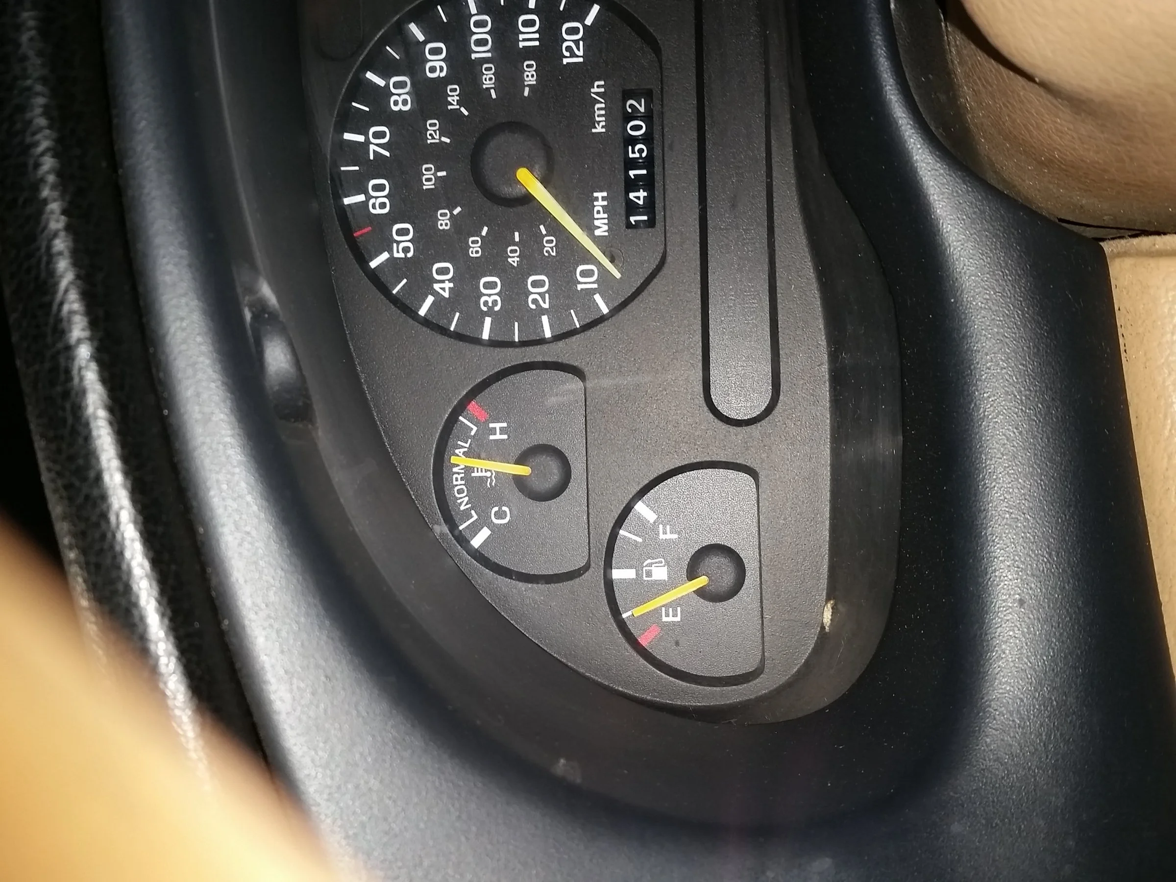

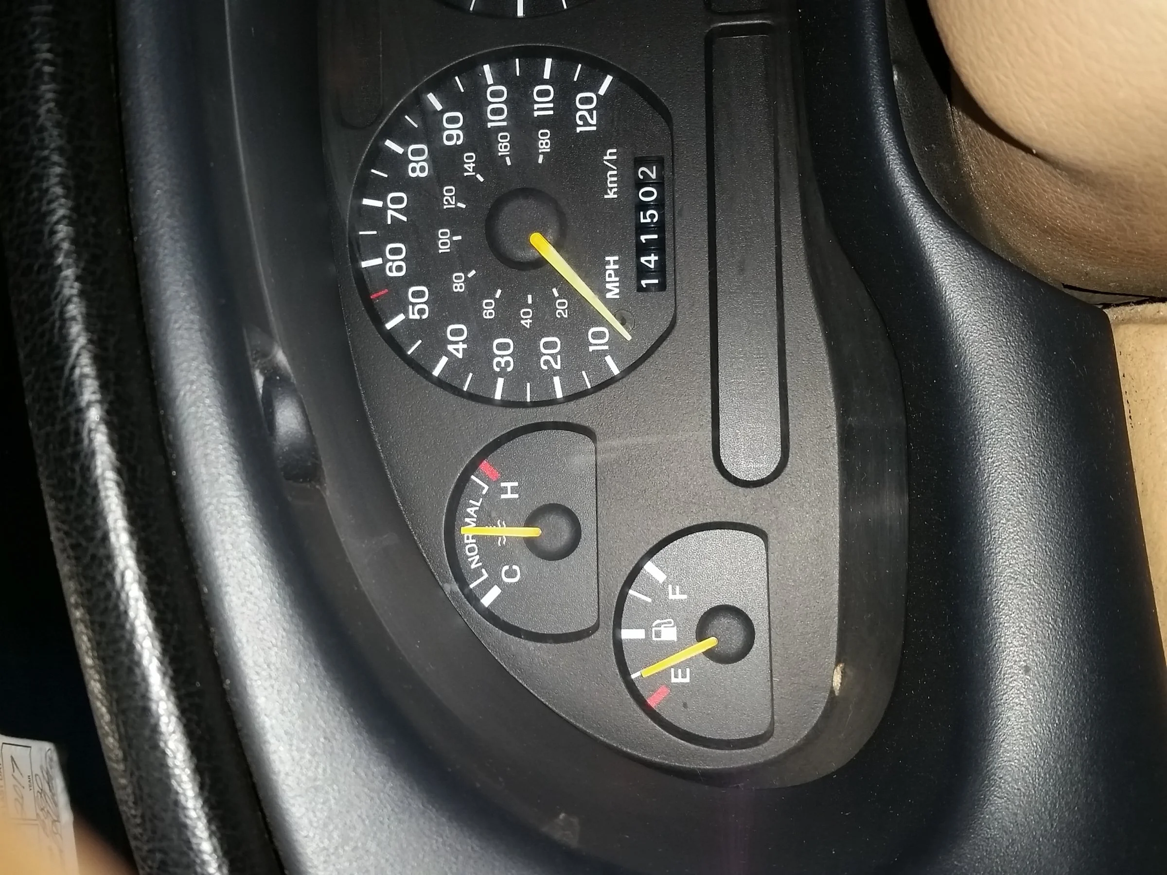

Just curious to see if this work everybody else is temperature gauge sits around?
I flushed it until the water came clear out of the motor and the radiator. Honestly seems like going up hills and stuff. It's one that starts to run hotter. But never goes beyond what showed.
The second photo down is where the fan finally kicks on.
The first photo is where the fan shuts off. And that's about where it stays
Side note....there's a 195 stat in it. Maybe a,180 should be put in?

Are the photos I put up Normal? Its in the normal range....but is that too high in the normal range???

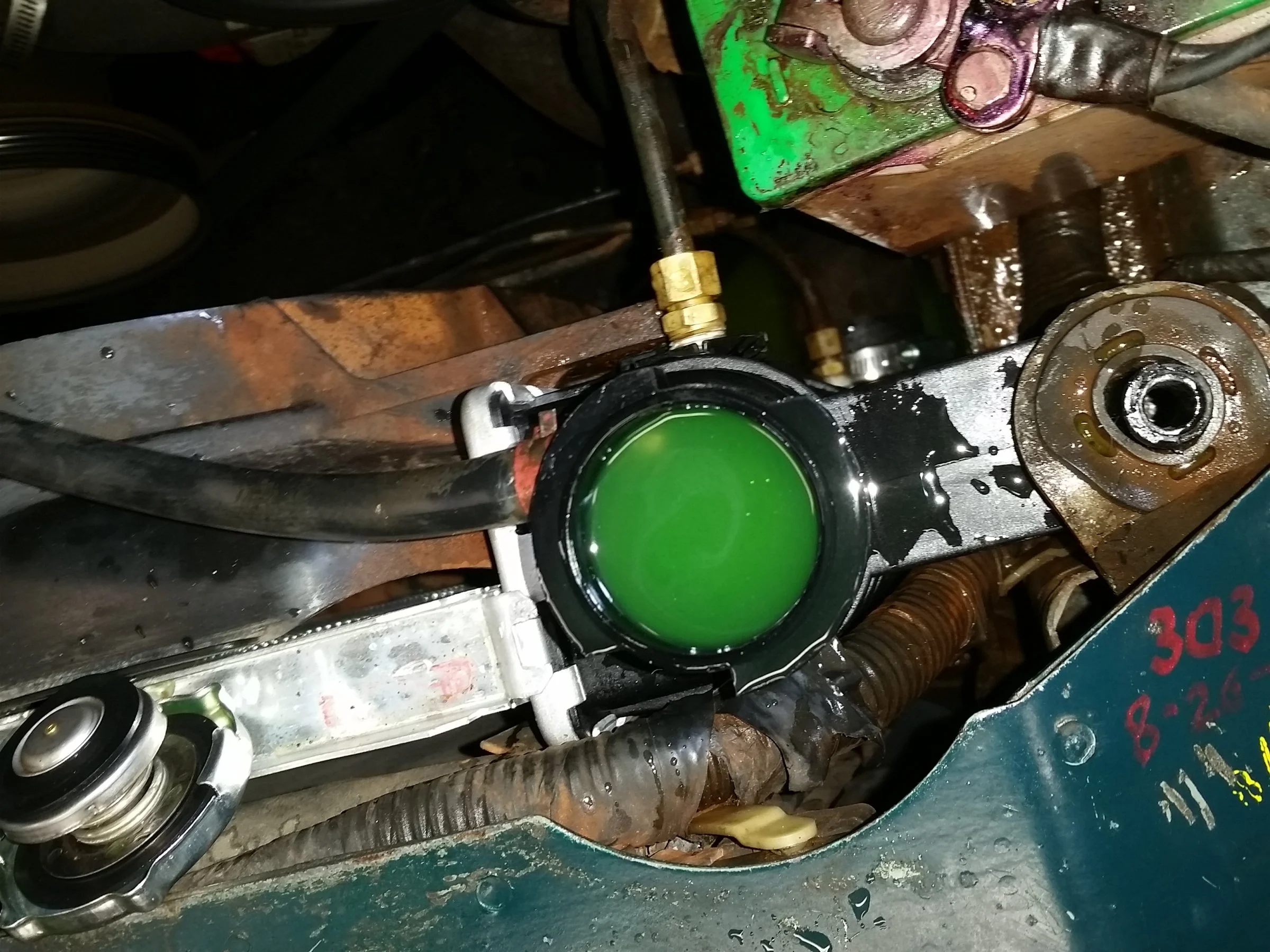

I took the cap off and opened up the bleeder valve, and fluid came out of there right away. So I must have bled it the proper way by accident. It's sitting here running and here's what the coolant looks like. It's not bubbling up for anything weird. I have no idea.
That's what the car running in the picture

Follow up!! I opened the bleeder up next to the coolant sensor again.
Some air came out. Not much but some did bubble out then started streaming.
Now the fan is kicking on right as it touches the "M" instead of going all the way up to the "A"!!
And goes down to the "R". So it's slowly getting better!!!!
At 45 mph cruise it is between "N" & "O".
My overflow bottle is staying right on the hot line when running at operating temp. Right where it should be.

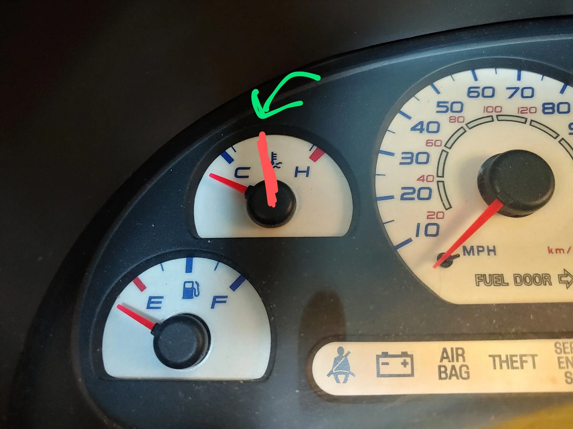

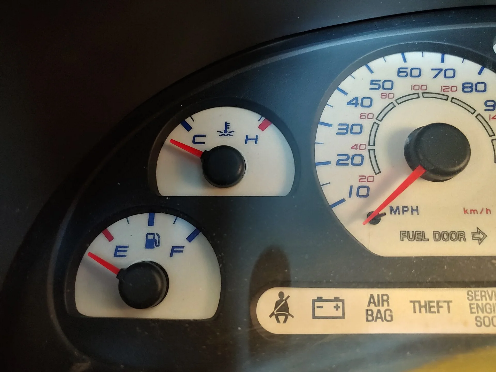

My temp gauge does the same as yours i had engine issues not related to to gauge and wound up swapping in a used v6 that was less miles being this engine was already swapped once and the car has 300k miles but when doing that basically everything was changed all the sensors and i bought a whole new cooling system new hoses new water pump new thermostat and radiator and condenser.. Before changing the engine the temp gauge set like yours ive attached a few files one is the guage with the car off showing it is sitting right so i dont think its been moved and the one with a yellow arrows is where it sits the one with a green arrows is where it should be sitting. My ect is 198-210 which is withing standard i believe which means it should be sitting where the green arrow is.. However i have a theory which i will be testing, i believe it to potentially be my fan thou it turns on and works but before it overheated with ac on (this is with the old engine) and i believe something with fan may be faulty causing it to sit higher i guess saying somethings wrong
Tldr i think it might be a faulty ac relay fan thingy thats on the fan assembly and the fan doesnt spin on all the stages
