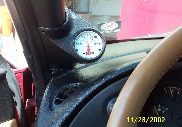

If this helps.....
Here's the one you want:
attachment.php
Now, it does NOT have to be that style(color) but this is the one.
FWIW, you can see on my stocker in the background what 180* is equivalent to.
RC
