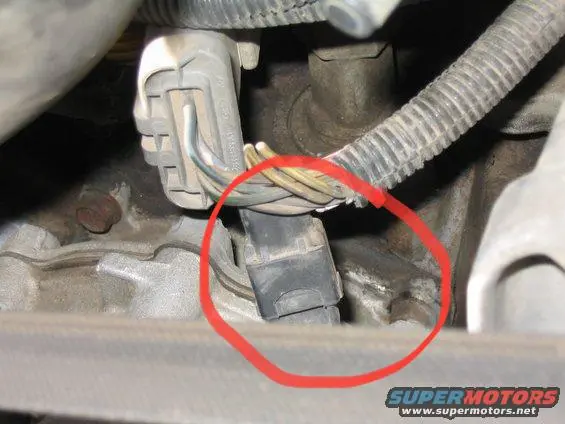

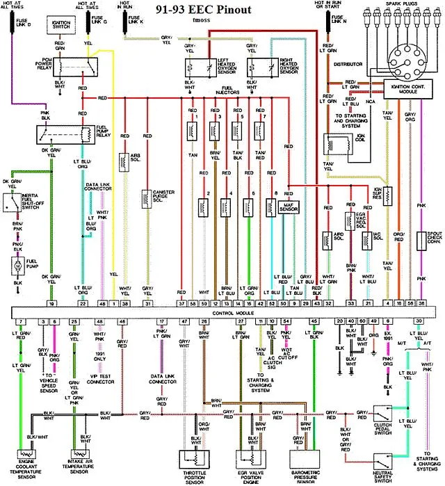

Spout:
Located here:
Pink wire, right side of this diagram:
Reactions: Shakerhood
