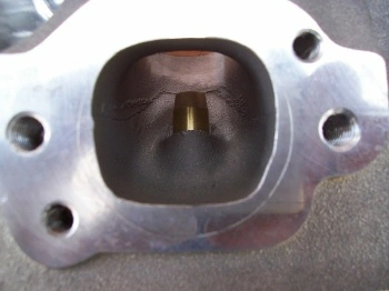

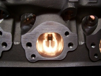

This is a stupid question but I keep reading in magazines about these engine build up and some refer to Trick Flow Twisted Wedge heads. I have a set of TFS street heats, can these be ported to accommodate a stroker Windsor??? Can they match the performance of a R series head or a High Port Head???
They can be ported to make the power, they are MORE than capable to make power on the stroked W engine as they are. The bowls and inner runners are pretty much the same, CC's are different and the exhaust ports are different and Port work can up grade that if needed.. run the heads, get a good valve job and rock!!
