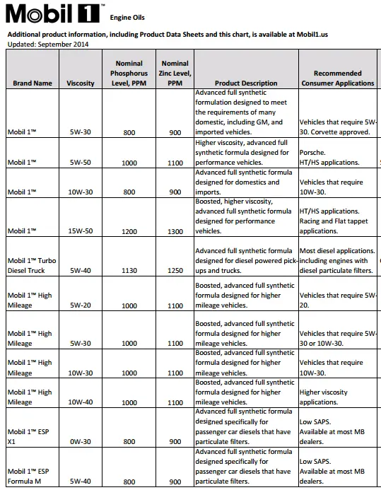

Here is another article that discusses the ZINC factor. Its probably more important to those with older classic engines but I think I will still start adding this inside my motor oil for my late model 1989. I have a high mileage 1997 dodge as well and its burning oil. I may go with the mobile 1 high mileage and add the zinc to it also.
http://www.mustangandfords.com/parts/mump-0907-zddp-zinc-additive-engine-oil/
Mobile 1 chart shows there is more zinc in their oils than valvoline engine oils. I can't find a nice chart with valvoline but I looked up the high mileage valvoline and found its zinc additive is only .083 w% vs 1100 ppm in mobile 1 high mileage.

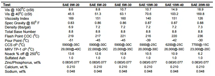

And here is Valvoline High Mileage and its specs.
http://content.valvoline.com/pdf/maxlife.pdf

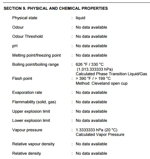

And then I found this hunting around, Ashland MSDS for valvoline high mileage. Check out the boiling point properties:

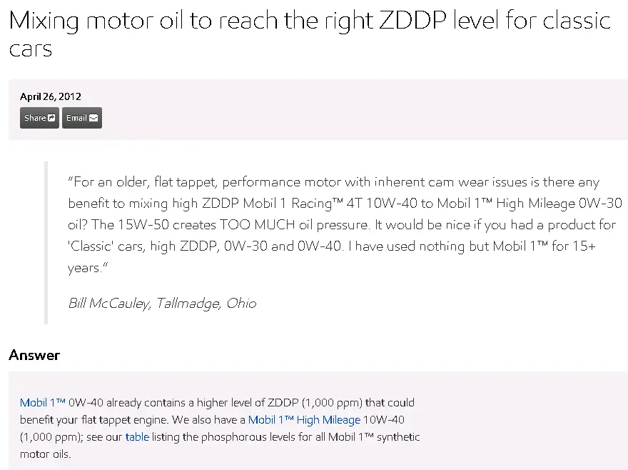

I like this too from Mobile 1 website. The information above states you need more zinc than whats in mobile 1 itself but nonetheless, mobile 1 has more zinc than other oil manufacturers which in my book is a plus. However, if you don't use a zinc additive, then this is a better choice for those flat tappets ;)
