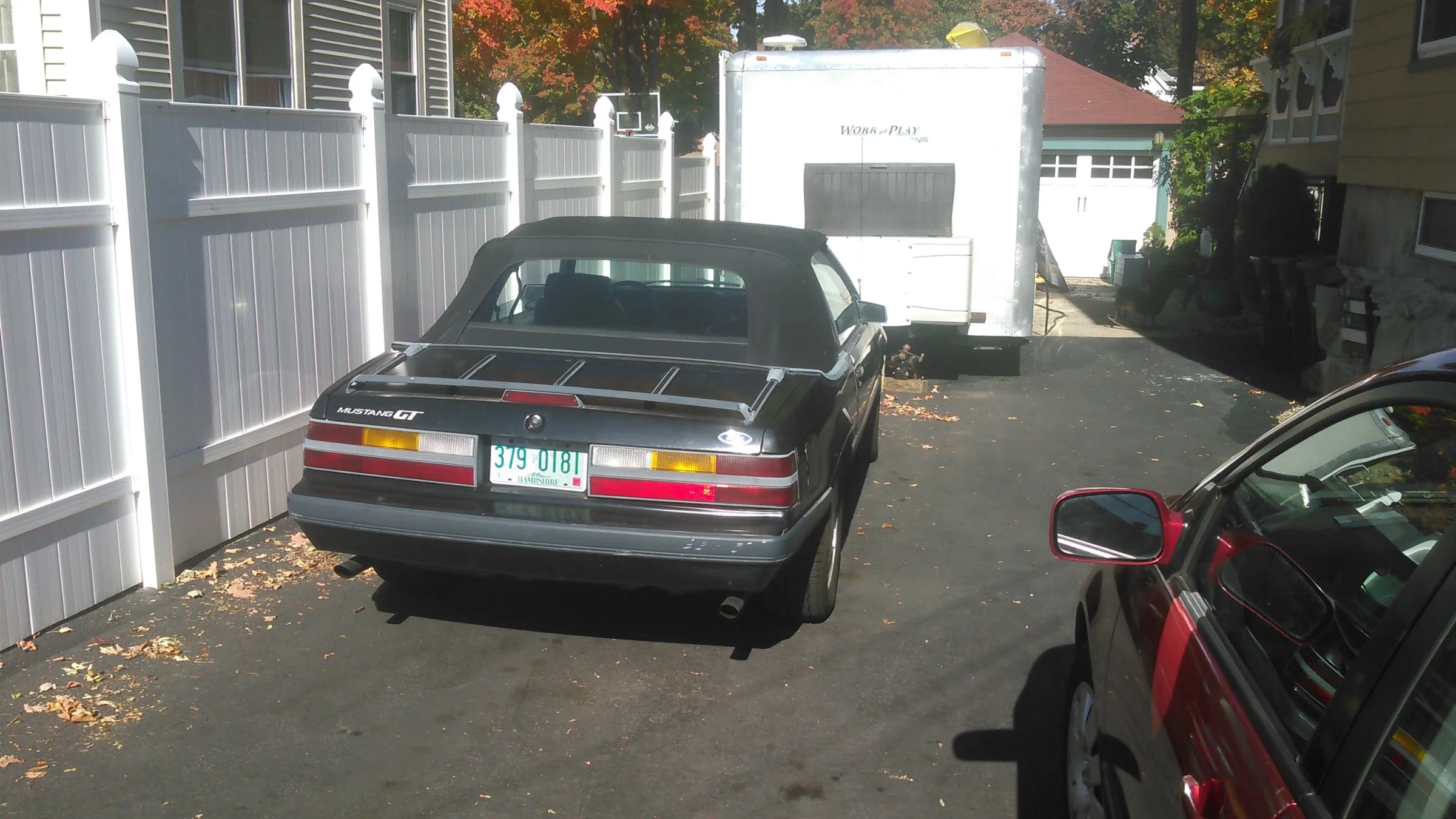

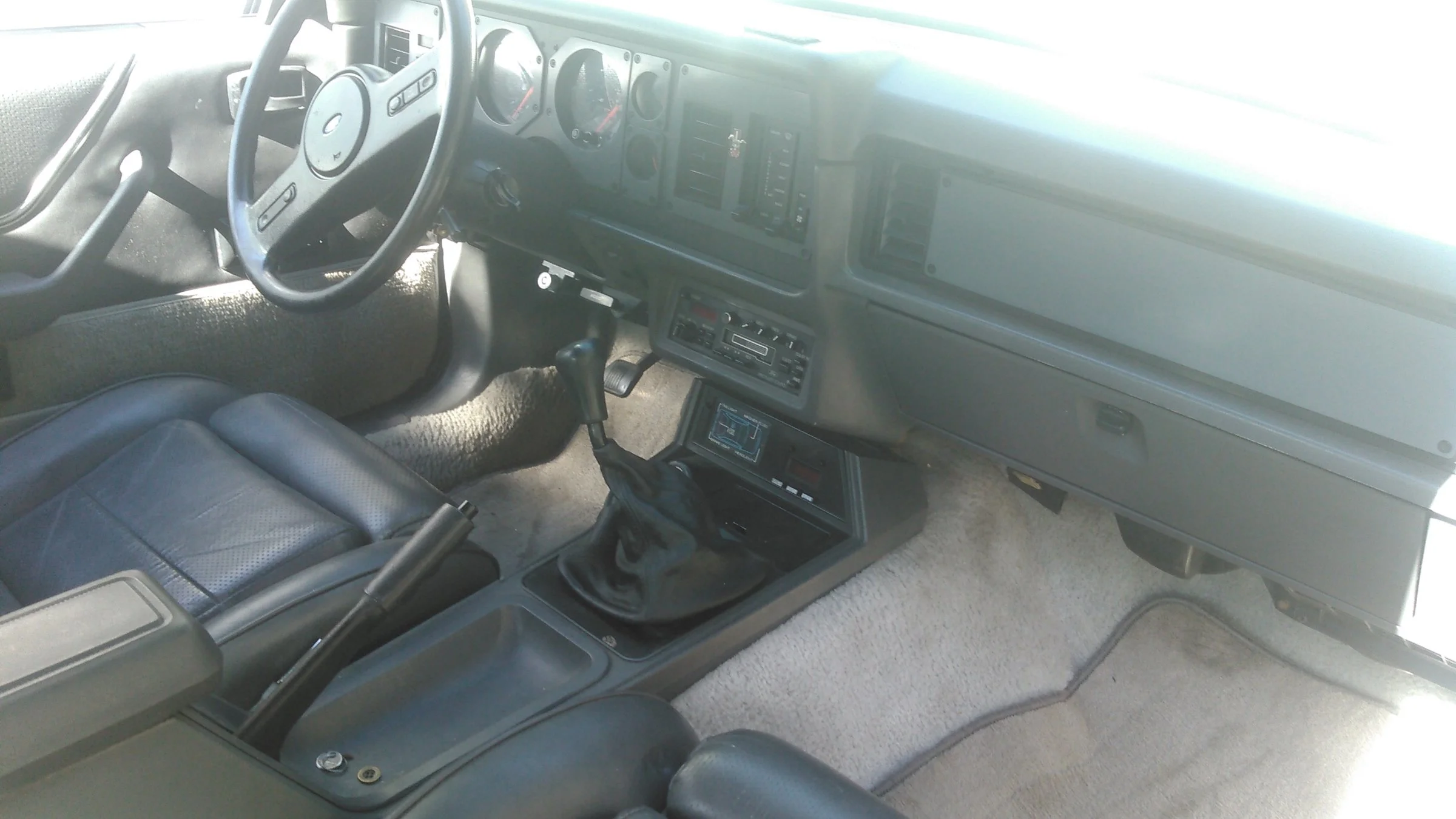

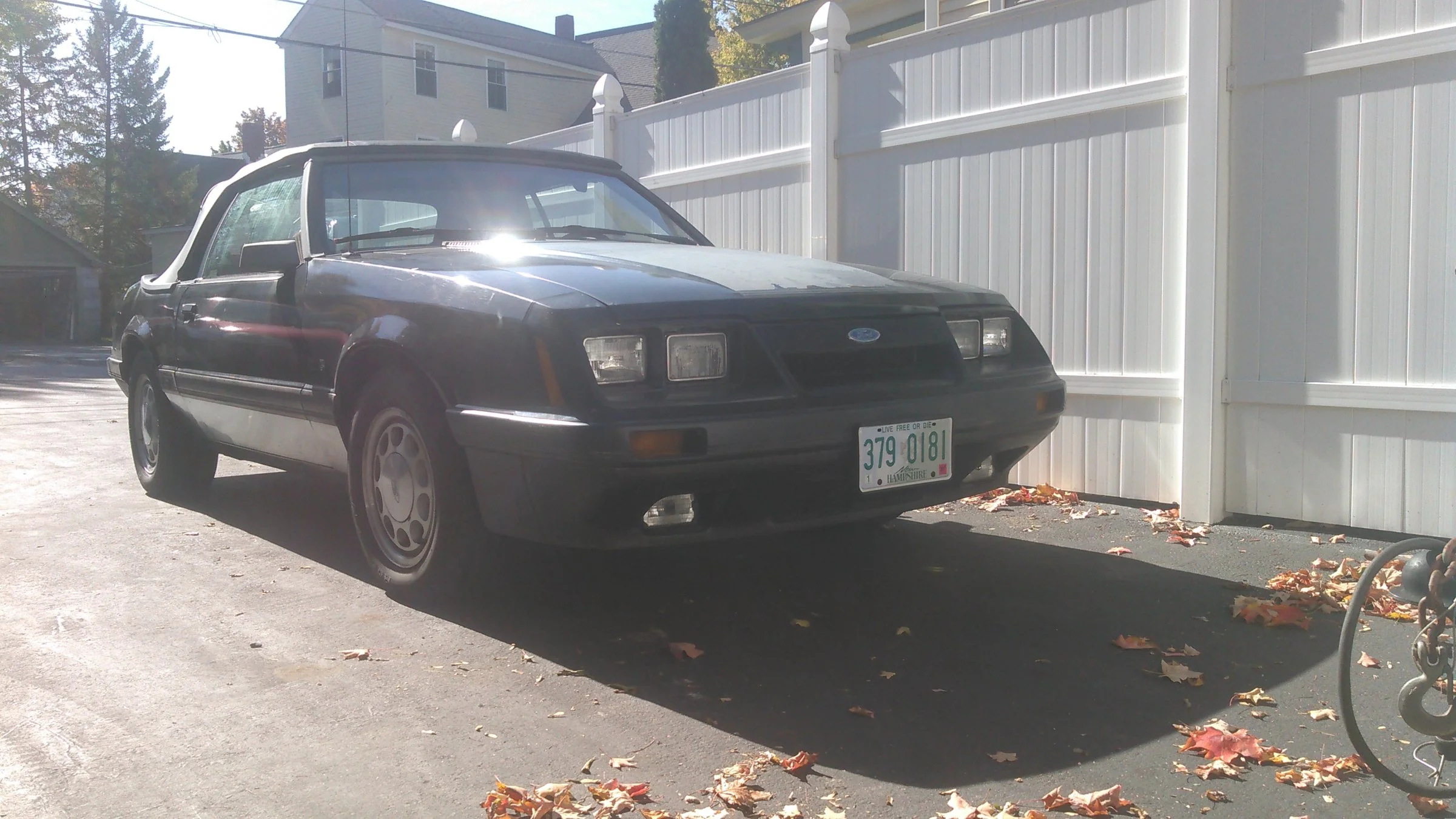

Original female owner, has all paperwork from dealership. All original, unmolested, everything works.
Awesome find brother,but I feel you may owe the wife BIG now lol.
So does this mean no more cobra clone?

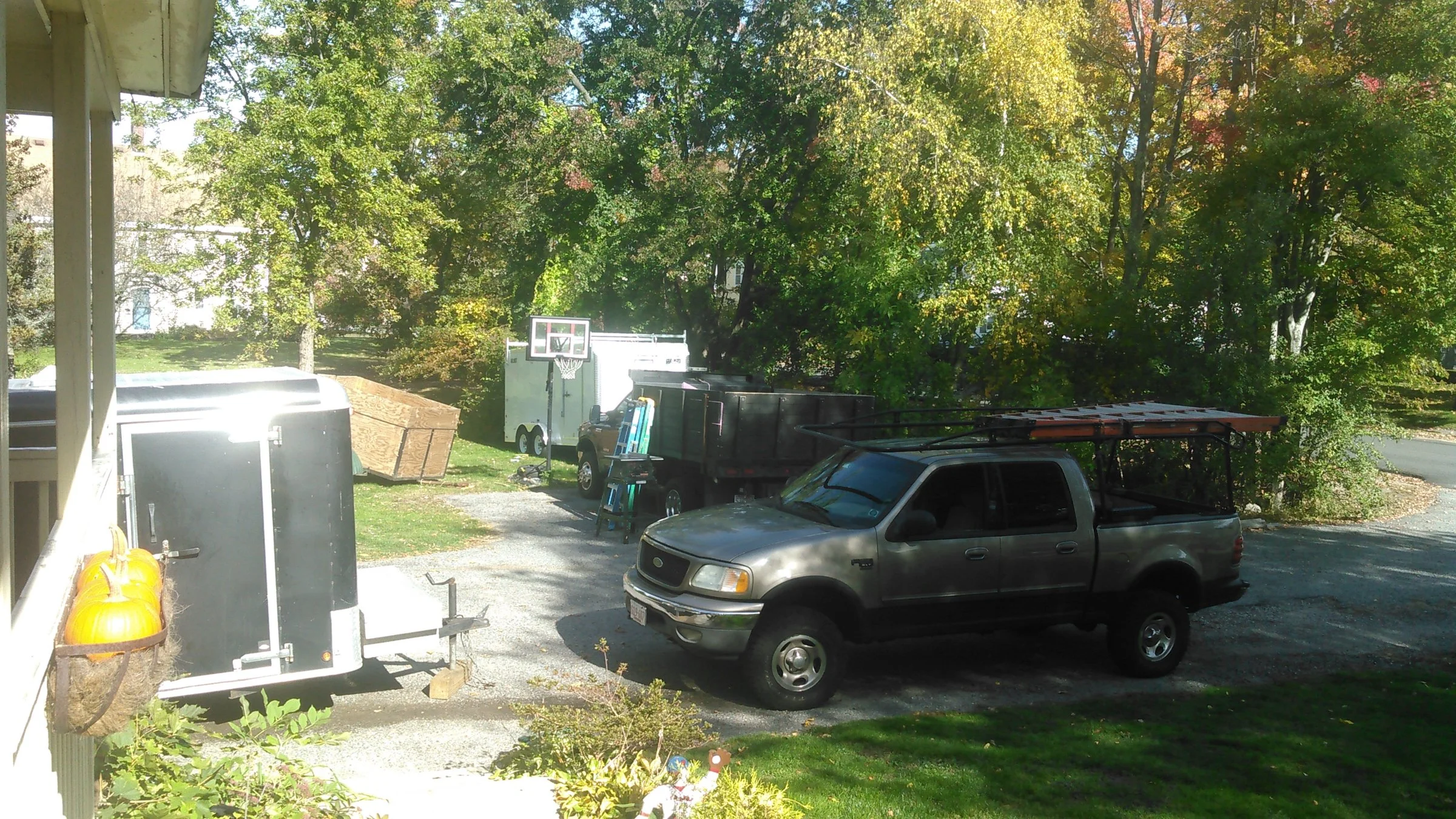

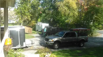

For now. The car costs the same as all the clone parts. I replaced a roof for cash, so I'll have to find another roof to do. Now I need a garage addition, which means I have to remodel her bathroom first. This car has been garaged since new, still 30 year old paint has clear coat coming off. Interior immaculate. Only rust was under doors. Frame rust free, even the pumpkin which was odd, factory must have done something. Shock towers spotless. Had some rust proofing done at some point. Not doing anything to it but body work. The LX is still getting everything fixed over winter and prepped for paint in spring. 86 going to friends house. Seriously can not bring another car home. I have two work trucks, three trailers and a plow. Plus three boys with their cars, her car. If I remodel the bathrooms I'll be home free. Better get to it.
