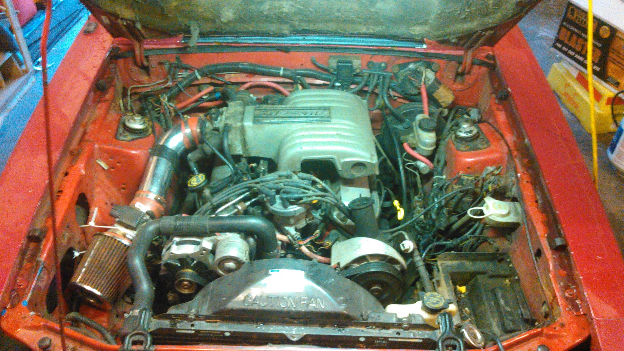

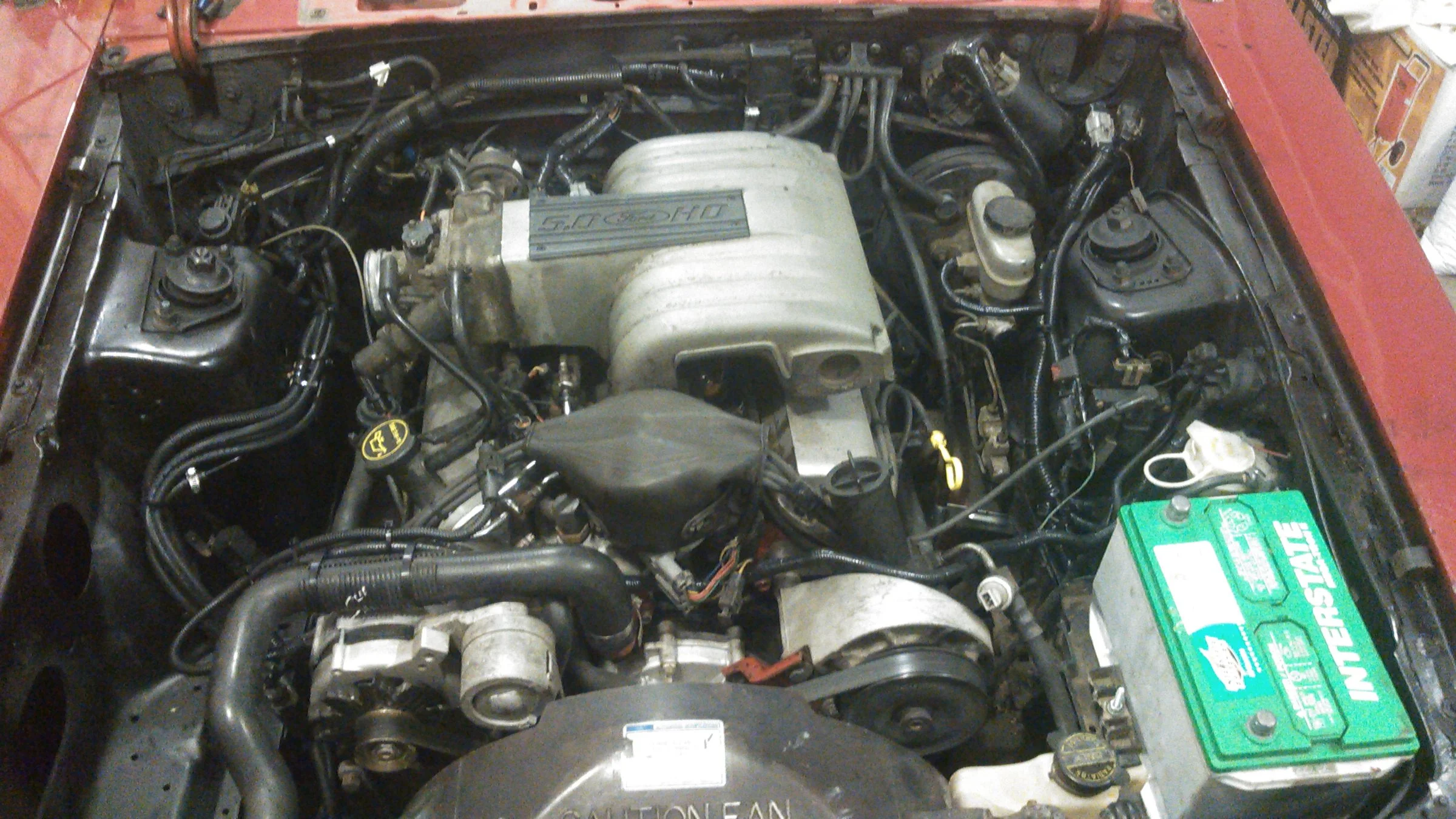

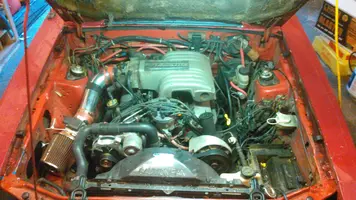

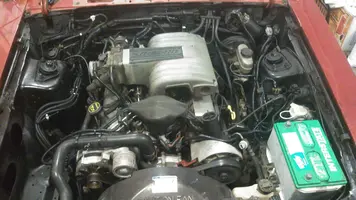

Before and after. Putting in some late nights so I can drive this thing before the snow flies. All new harness wraps and vacuum hoses. Entire engine compartment cleaned and por'd. Intake plaque needs to be sanded still.

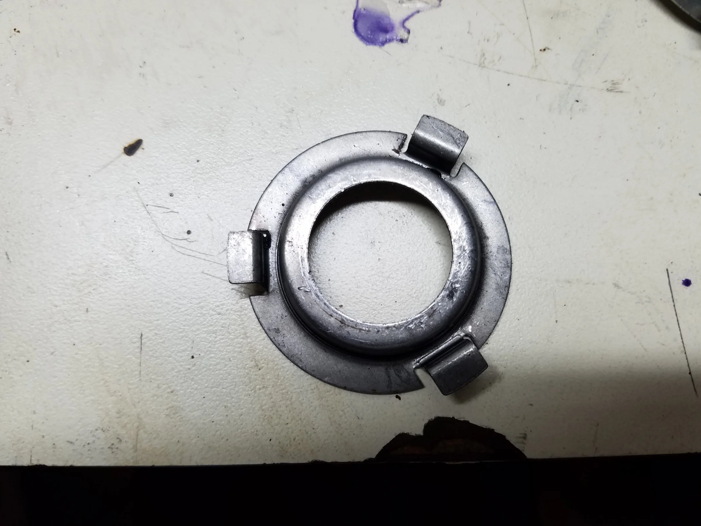

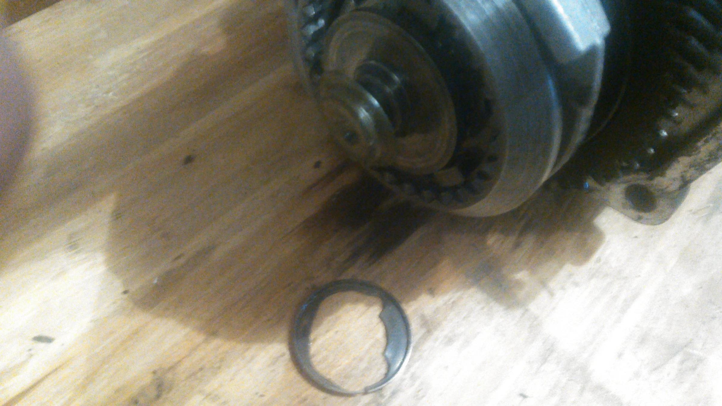

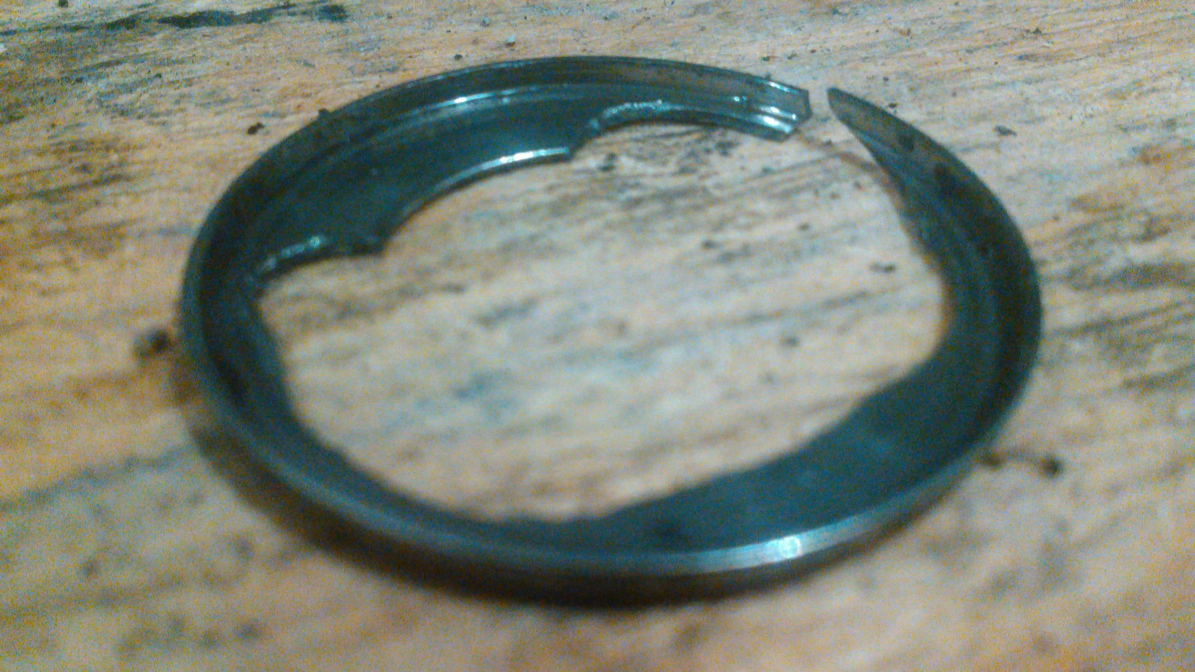

Exhaust, driveshaft, transmission, clutch, flywheel, pilot bearing, and rear main seal all out. Bearing retainer is aluminum and pretty well worn out, so was throwout bearing. Probably the cause of crappy sticking engagement. Flywheel I guess is also due for replacement. It has the burned dark spots, worn down pretty good, looked ok to me. The clutch and pressure plate were fine, will sell them on craigslist. In order to get the one washer for the transmission I need to buy a master rebuild kit for a hundred and something bucks. I've never rebuilt a transmission, could be a $1500 experience gone bad. Don't really want a $150 washer, Have to think about that one. At least now I can finish the por 15 on undercarriage with clutch out.

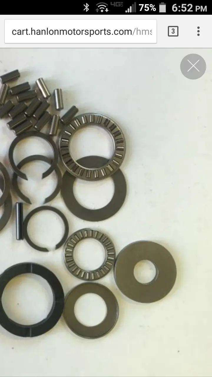

What washer do you need for the tranny? I may have one left over. some of the parts they send you are no wear items and can be reused. I may have what you need.
Joe
I will have to sift through my old stuff. I don't recall any washers that had a lip like that. Of course my trans didn't have a reverse break either, so that may be why.
Joe
Yep, you are right. I went back and watched the video I used to rebuild mine. he shows it, and then comments that you will only have it if you have a reverse brake. I will continue looking, but I don't think that was in my Astro rebuild kit.
Joe
Do you know what the name of that part is? I would think that Hanlon, Astro, Thegearbox, any of these guys should have that part.
Joe
Found it in a small parts kit. It's only in the 83-84 T5 nwc, mine is an 84. 85 has the exact same set up minus that washer. The reverse must just brake on the cover. The cracked washer still fits, nothing to really catch on the cracks. Reverse worked fine before, I'll roll the dice. I know where to find parts. Thanks for the info
