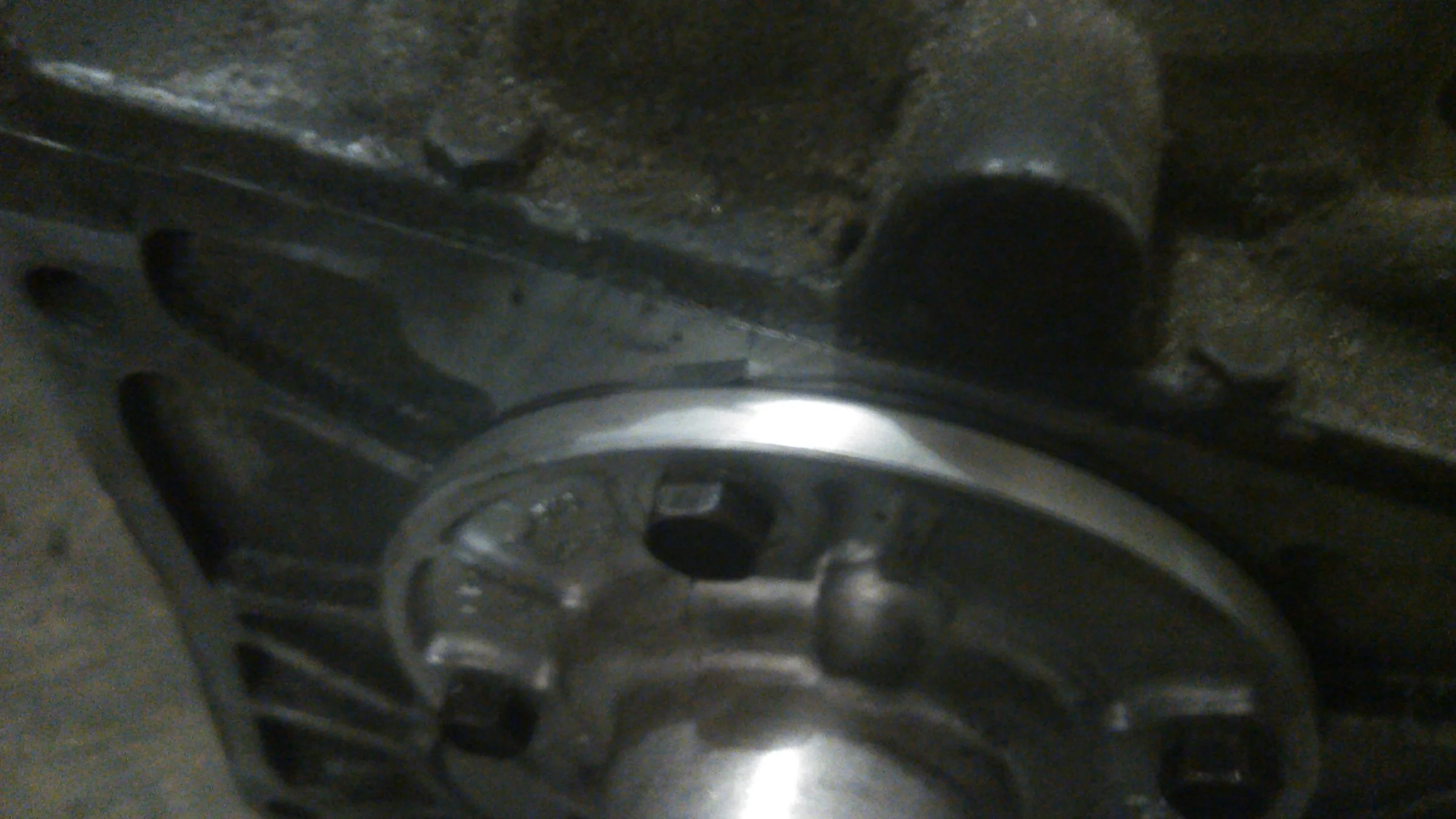

Everything was going great until I heard a pop removing the extension housing bushing. I removed 3 of the 4 bolts in anticipation of replacing the throughout bearing retainer first. I didn't. If case leaks I get to do a transmission rebuild. Very small crack about input shaft.

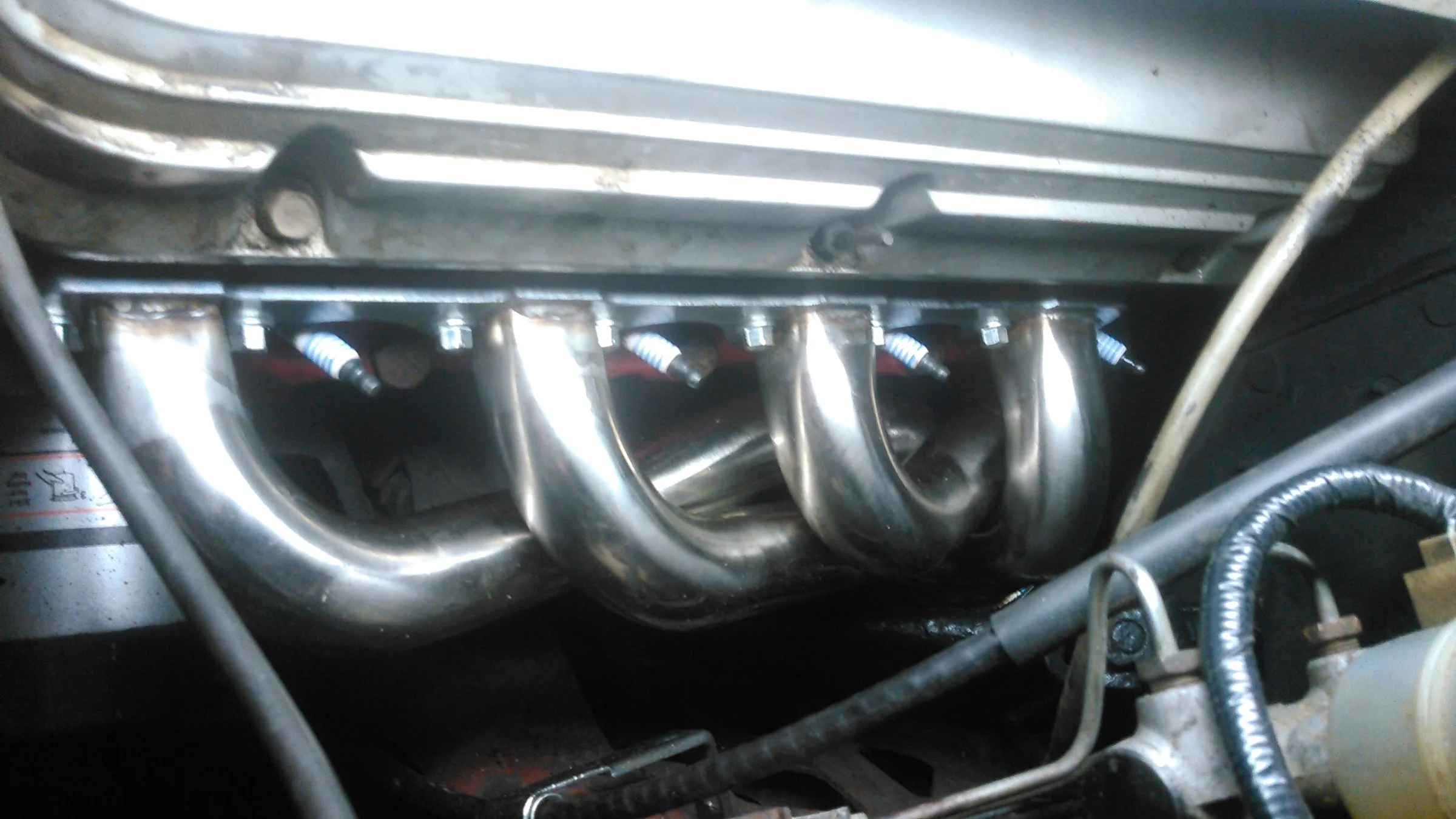

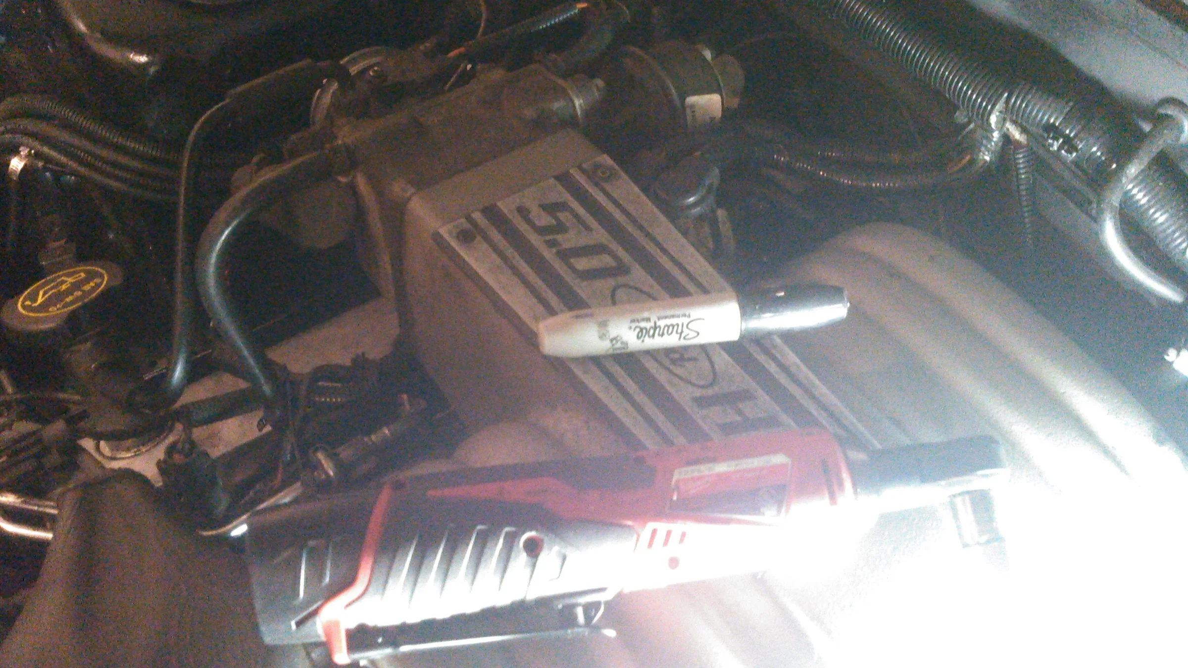

Picture of my drunken LMR shopping spree a month ago. New headers being installed.
That Milwaukee battery ratchet is the second best tool I've ever bought next to a roofing nail gun
top left bolt has crack.

The case is under some decent pressure right there. The gear assemblies push towards the drivers side when spinning. Hope it stays together.
I'm sure you could find a case pretty cheap and transfer parts over.
I can't see the transmission case crack causing any problems. it's on the front top and surrounded by bolts. Everything is back together, shifts and runs mint. Have a spare case if it blows.

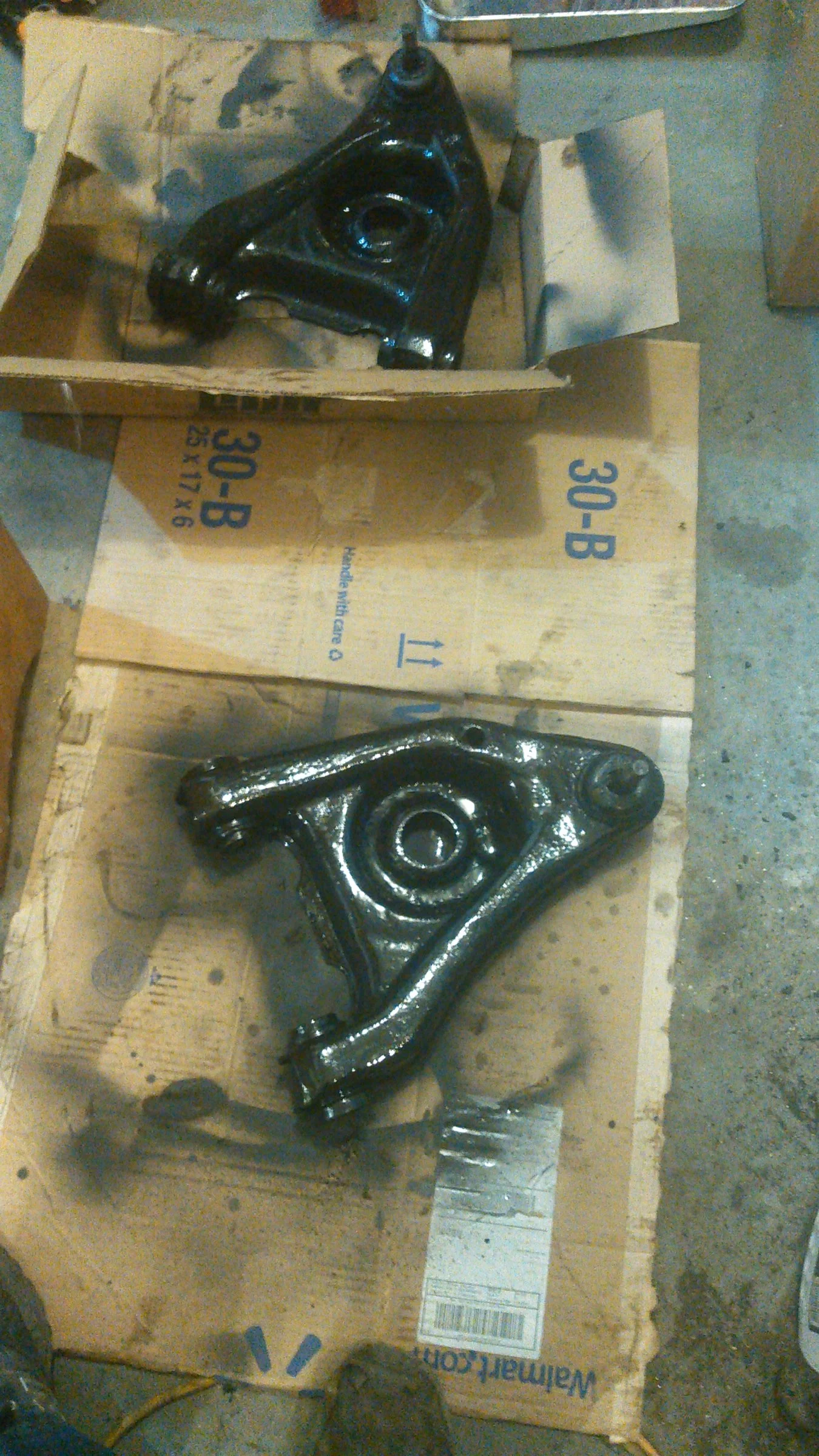

Started the suspension tonight. Just found out the hard way not to paint threads with POR15. Had to grind notches in the polished steel for the vice grips to grab, no matter how big the breaker bar, the vice grips let go. I even vice gripped the vice grips, still would just spin the shaft. Ended up torching the nut until the bushing caught fire then shocked it off with 5lb hammer. Wtf! I thought the nut and bushing washer was one piece like a washer attached nut, I would have just cut the fn nut off. Other bolt is painted also, just cutting that one off :baby:
After suspension is done I'm done with preventive maintenance and all the ocd repairs. Once the snow flies it's on to the body work and clone kit :cheers:

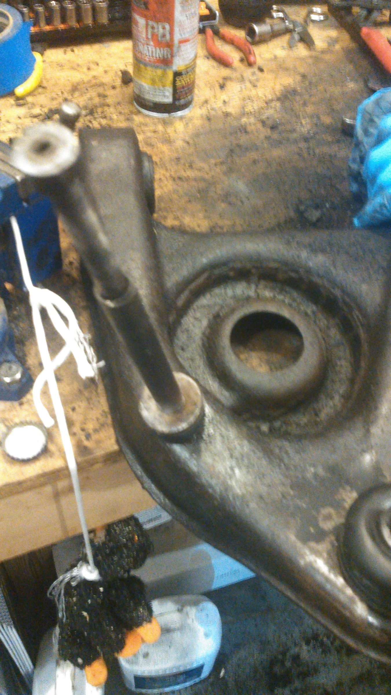

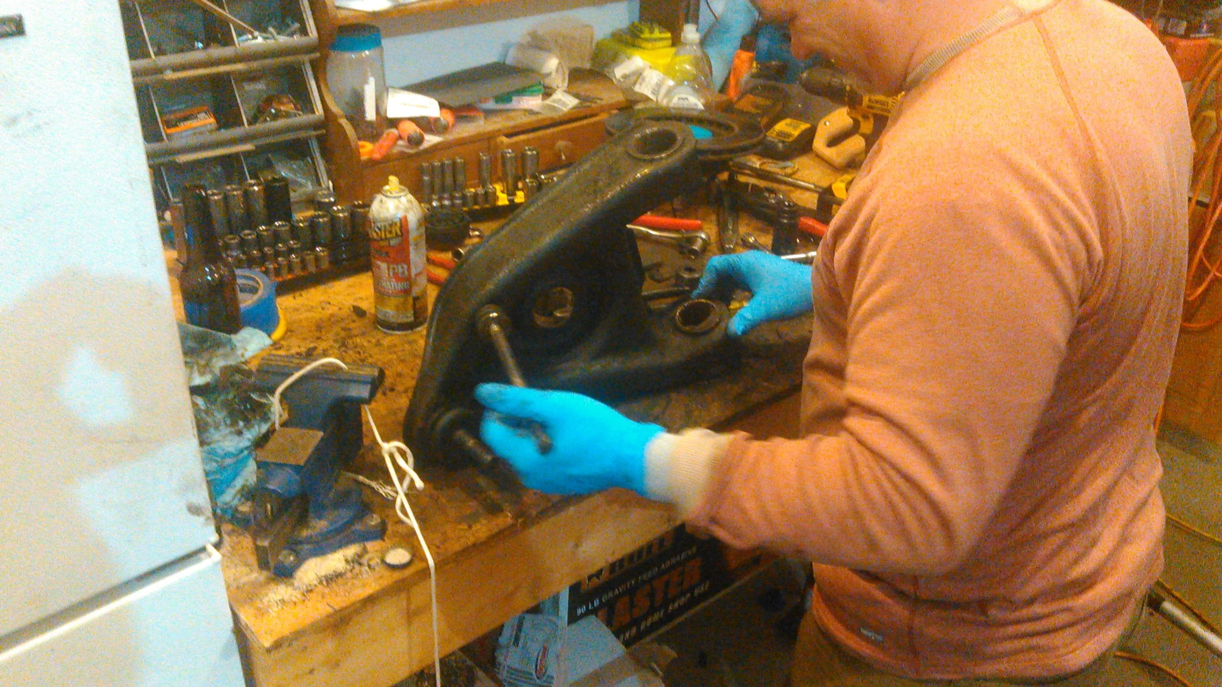

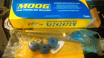

All I wanted to do was swap the springs and shocks..now the spindle and control arm are sitting on my work bench. what is the rod called that connects the two? has a sleeve rusted to it, won't come off. has rubber bushings at both ends in both sides of the metal. The hole in control arm is quite big for such a small hole, wait what? Is that normal?
Your ball joint connects the spindle to the swing arm, but I dont know what sleeve you would be talking about. Nor do I get what you mean by bushings at both ends. That sounds like you are talking about your sway bar end link.
It took too much effort to lean over and look earlier. yes, it's from ca to sway bar. after four hours of heating and beating it's pretty much fubar. I've been beating the front control arm bolt for a good four hours, finally broke loose. Now it's on the bench and this sleeve is frozen. giving up early on this sleeve, it's seized, so I'd like to have spare before sawzall is called in.

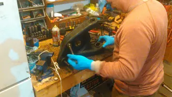

Here is my buddy stuck drinking beers just watching me, felt bad and started removing ca grommets for me

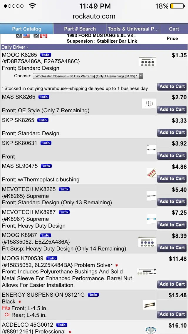

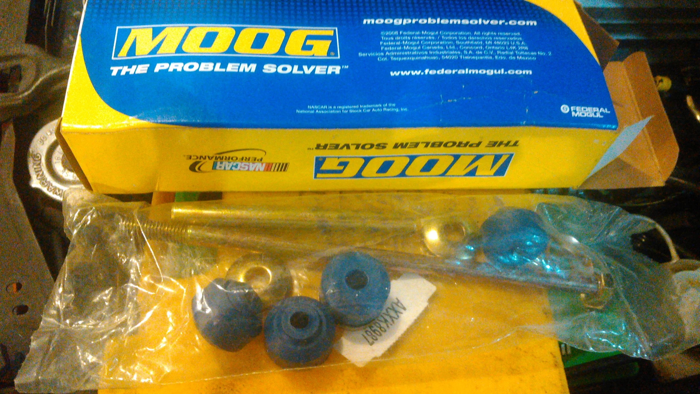

New control arm bushings are a good thing, you should consider doing eurethane. The sway bar connecting link and bushings should be replaced anyhow. You'll be happy with the results.

It took too much effort to lean over and look earlier. yes, it's from ca to sway bar. after four hours of heating and beating it's pretty much fubar. I've been beating the front control arm bolt for a good four hours, finally broke loose. Now it's on the bench looking all :taco:ty and this sleeve is frozen. giving up early on this sleeve, it's seized, so I'd like to have spare before sawzall is called in.
Sawsall away- swaybar end links are cheap and easy to get at the parts houses. Online etc..
