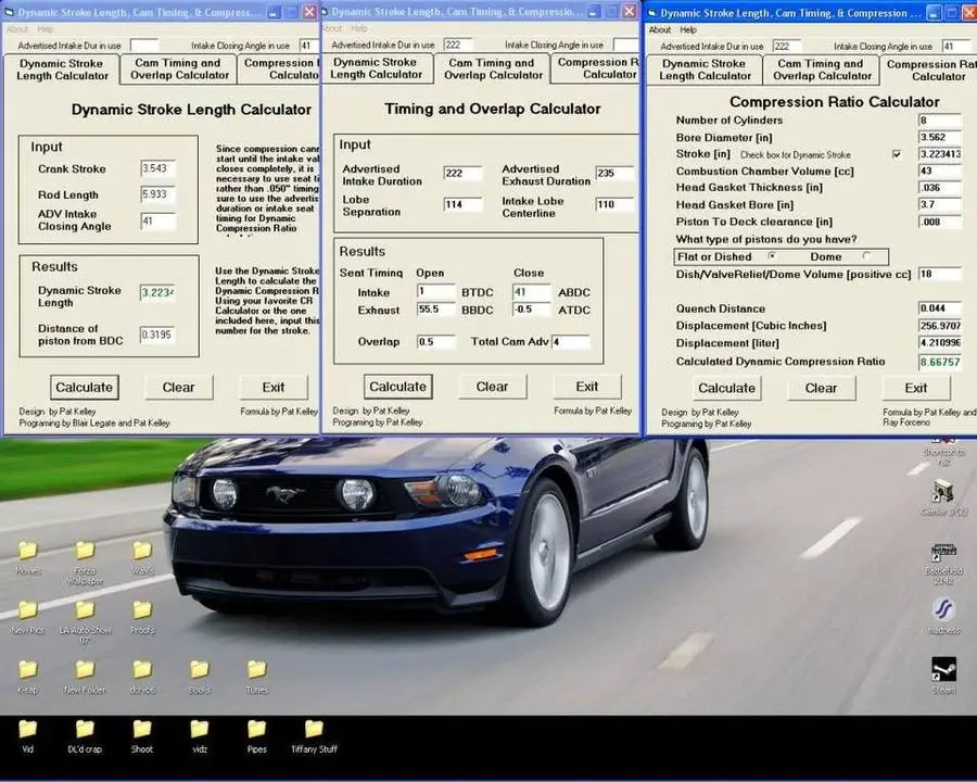

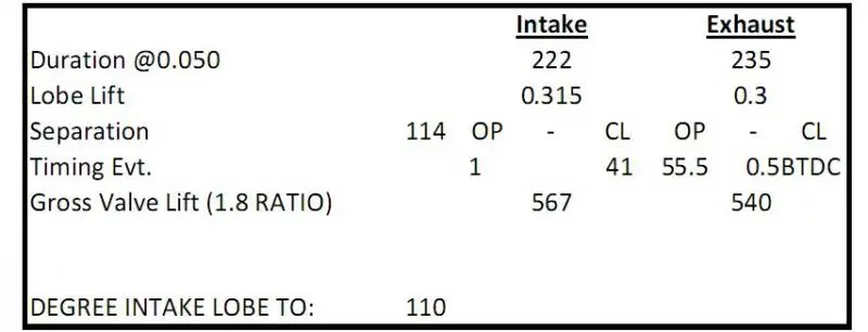

Nah, I have stage 1 n/a cams in right now. I went with a custom VT grind designed to specs that make me happy. You could call it a stage 2.25 and it sure as hell wont have any problems in the low end. I wanted a late intake valve seat time for lower dynamic compression during operation, but also a close to nill overlap to build boost down low and help my PD blower. Most centri guys want some up top range so overlap is desired, my pal Emerson with a YSi trim and now Novi 2 k has Crower NPI blower cams and his has like 4 or 6 degrees (i forget) of overlap. Not a dog down low, but kills up top for sure.
Here's mine:
yours does look good for you pd blower set up! congrats. the dyno sheets for the blower hitech look good. there doesnt seen to be a loss down low and they seem to really excel up top. however, that is on their own web site so who knows.

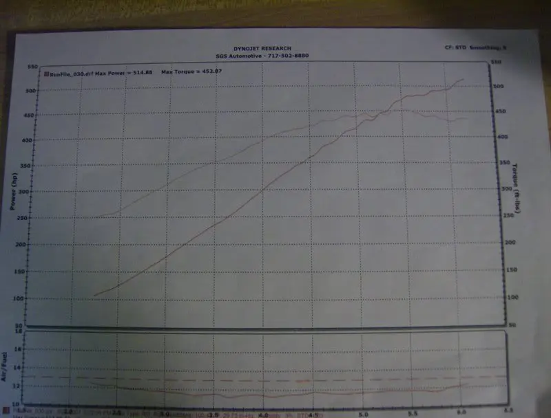

I'm running Houston performance s292 cams. I went from 431 to 516 with no other changes. I just dropped them with a cam retention tool ran them on stock valve springs for over a year and did not degree them.

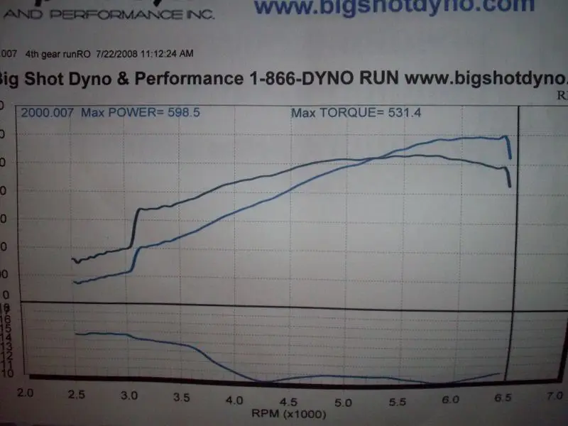

Then I installed them in some patriot heads ran them for a year. went 572 at my tuners dyno and 598 at another dyno with a little S-trim. Where I tune has a very old dyno.

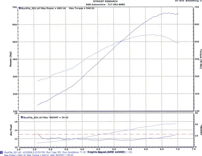

Then I went to T-trim and tfs intake and put down 665 still using the same cams at my tuners last week.

S stands for street cam. When I was using the s-trim and a stock intake it made 598/531. The intake and T-trim raised my power band not the cams and even though they where designed for less rpm they still did well when pushed to 7k.

At only 12.5psi with stock heads and intake I made 515/453 I was even runing them with stock valve spings never degreed and I dropped them in with a cam retention tool never removing the timing cover. the 80+ incease was also with the same pulley. Imagine if I did it right lol
Even people with low boost see good results from these cams
They are only 531 lift. Look how flat for a Centrifuge supercharger when I pushed the little S-trim hard.
Stock intake, patriot heads and S-trim @ 16.5 psi. Not my tuners, I did 572 there but is dyno is ancient. I also read lower where I tune than anywhere else.
All the power by 6400 with stock intake and a S-trim
Now the same cams still not degreed TFS intake with oval tb upper, and an Accufab single blade oval TB. S to T-rim same pulley
665/540 @ 20 psi and 7k rpm.
