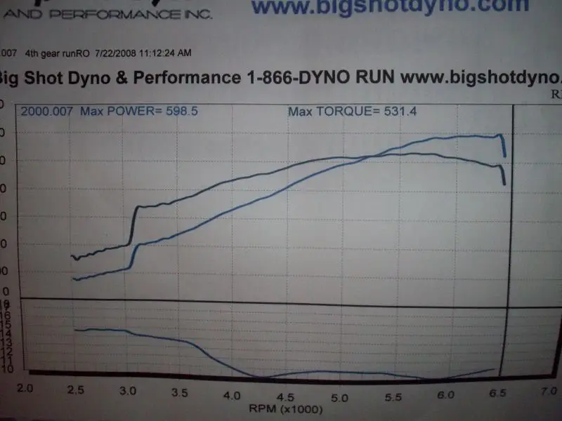

S stands for street cam. When I was using the s-trim and a stock intake it made 598/531. The intake and T-trim raised my power band not the cams and even though they where designed for less rpm they still did well when pushed to 7k.

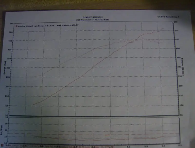

At only 12.5psi with stock heads and intake I made 515/453 I was even runing them with stock valve spings never degreed and I dropped them in with a cam retention tool never removing the timing cover. the 80+ incease was also with the same pulley. Imagine if I did it right lol
Even people with low boost see good results from these cams
They are only 531 lift. Look how flat for a Centrifuge supercharger when I pushed the little S-trim hard.
Stock intake, patriot heads and S-trim @ 16.5 psi. Not my tuners, I did 572 there but is dyno is ancient. I also read lower where I tune than anywhere else.
All the power by 6400 with stock intake and a S-trim

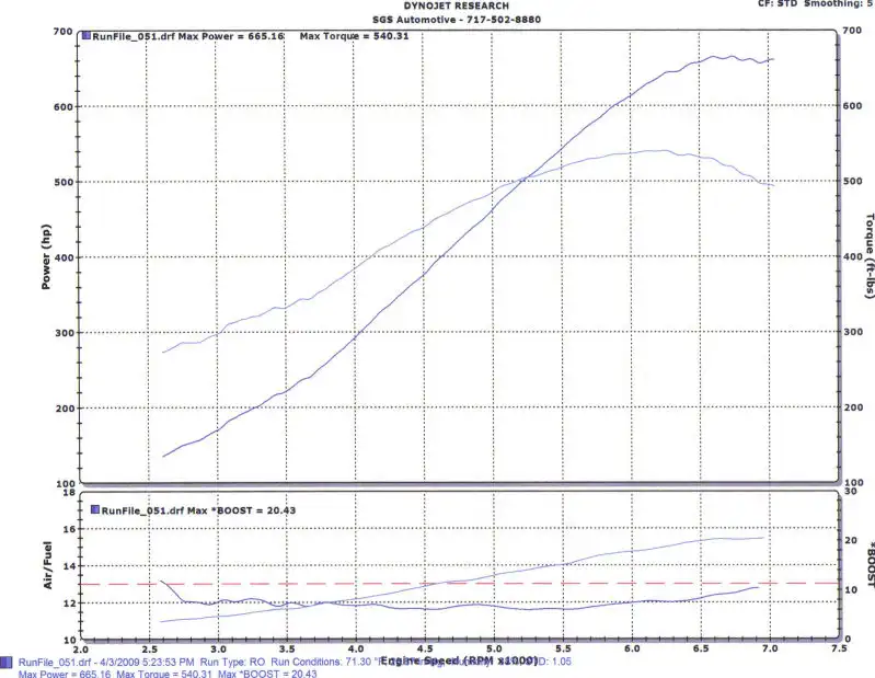

Now the same cams still not degreed TFS intake with oval tb upper, and an Accufab single blade oval TB. S to T-rim same pulley
665/540 @ 20 psi and 7k rpm.
The only regrets I have is that I went with the S instead of the R cam.
Holy crap George, please tell me your car did not go to 12.5:1 afr at 20 psi??? He was letting out of it correct? Are you spraying methanol?
