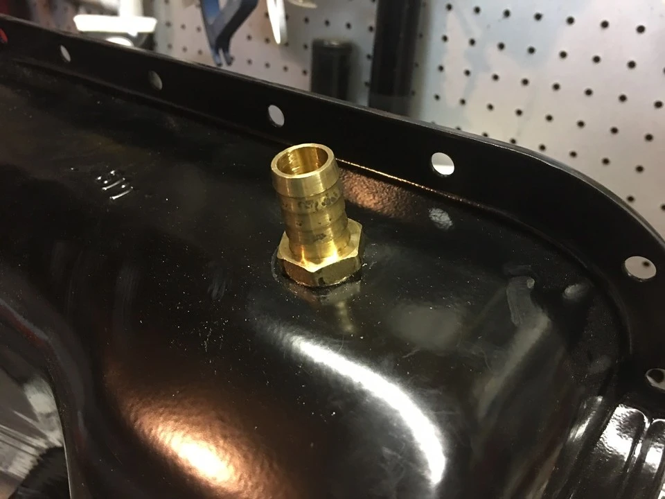

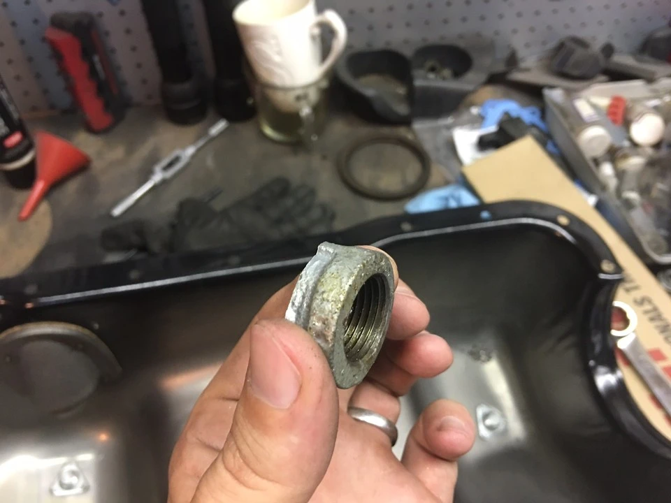

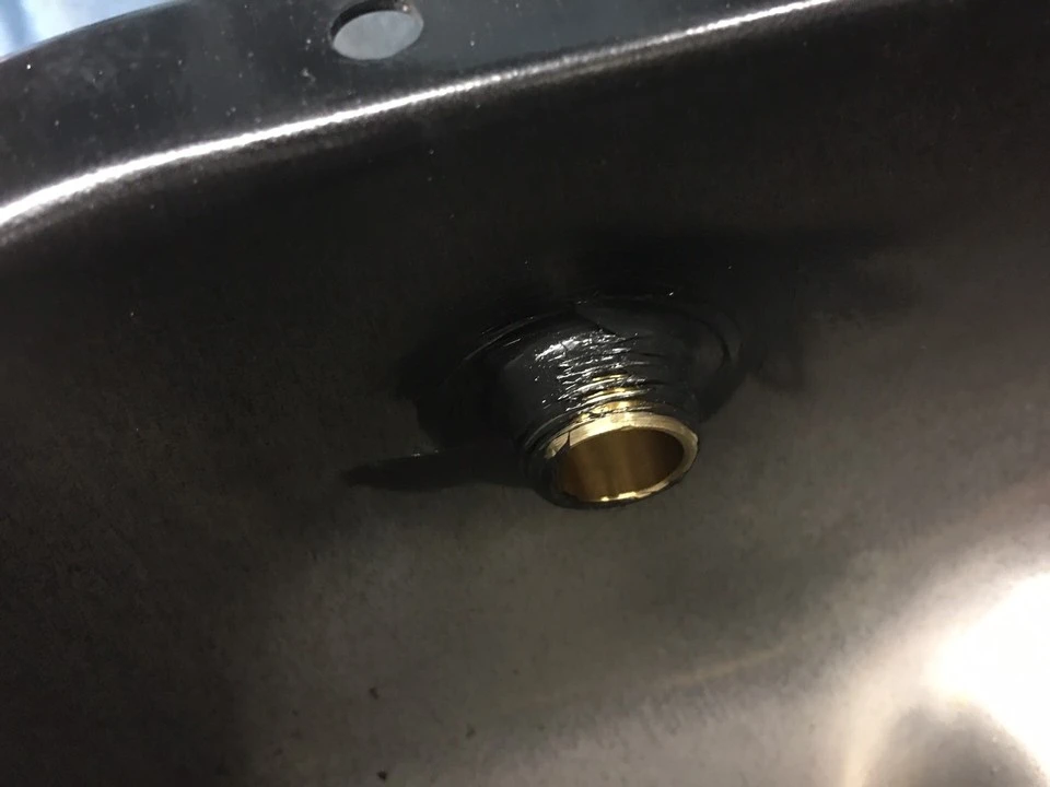

So about yesterday - It was one of those days where you have no business trying to squeeze in working on stuff in between other engagements because you get in a hurry and sh*t happens. I did get the oil drain in
Liberal RTV on the back
For good measure, I got a 1/2" pipe cap, cut the back off and screwed it on the back of the fitting and used a little more RTV to make sure there would be no leaks

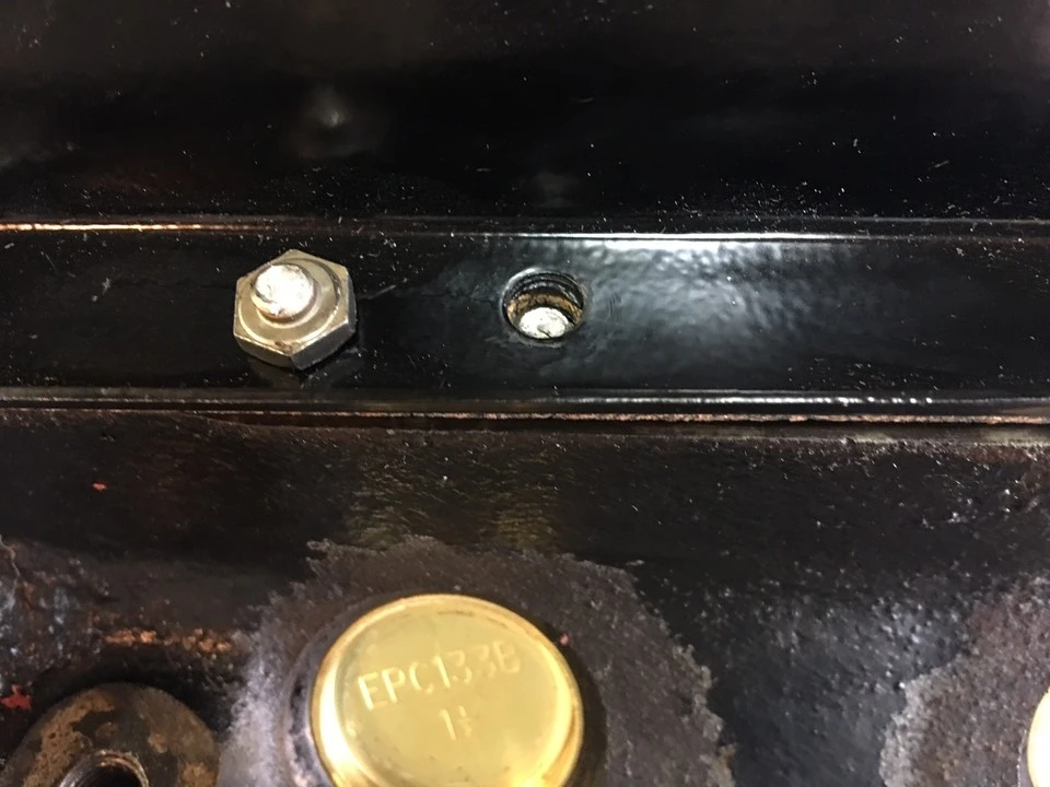

When installing the oil pan, I guess one of the holes had a burr in it. I started all the bolts and was running them down with a socket on my drill. WTFover.

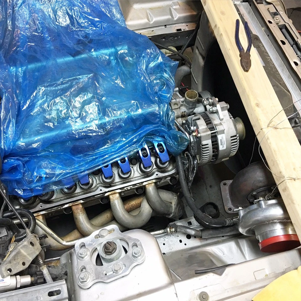

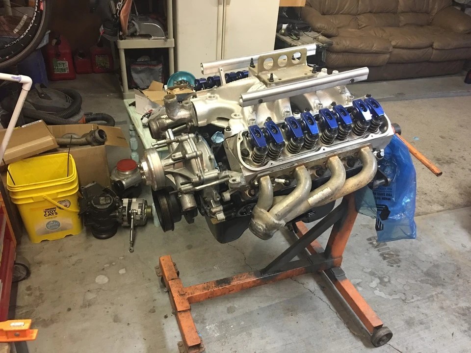

And here's the current status. Ready to drop in for a test fit. I think the header will fit but the pan will need clearancing. Will find out this week, if not tonight.

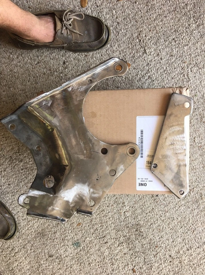

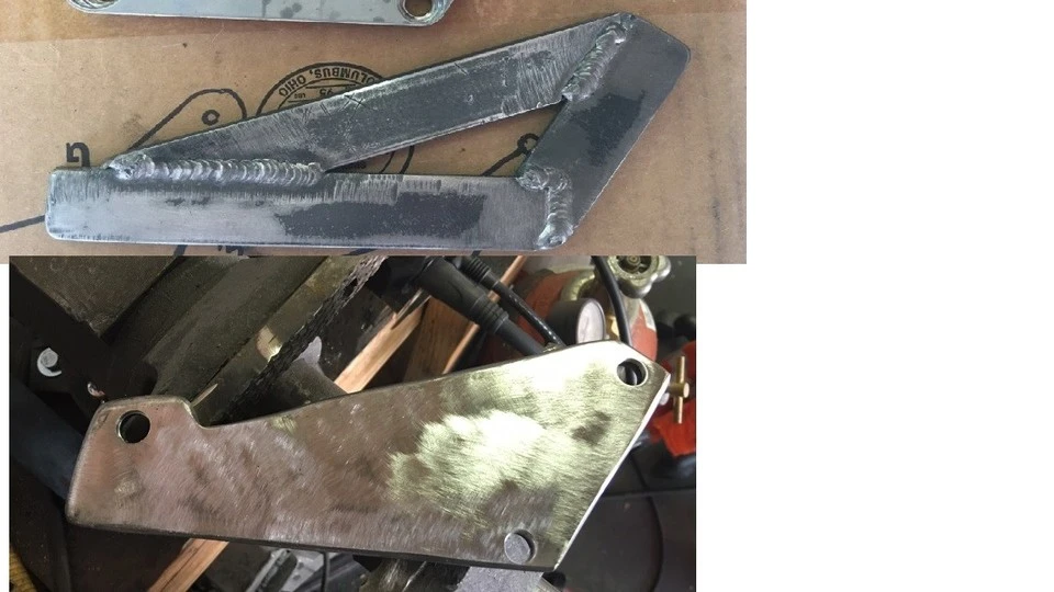

I put a sheet metal skin on my alternator bracket to make it a little more....well... less hack-job-ish. I think it turned out well.
I also knocked down the welds on my A/C bracket and dropped them off with my buddy Scott Coates at Coatings by Coates to get powder coated black. The coating should make it look like someone knew what they were doing when they made it, hahaha. His work is top notch and we are currently scheming on a color for the stuff in my engine bay once it's all finished up.

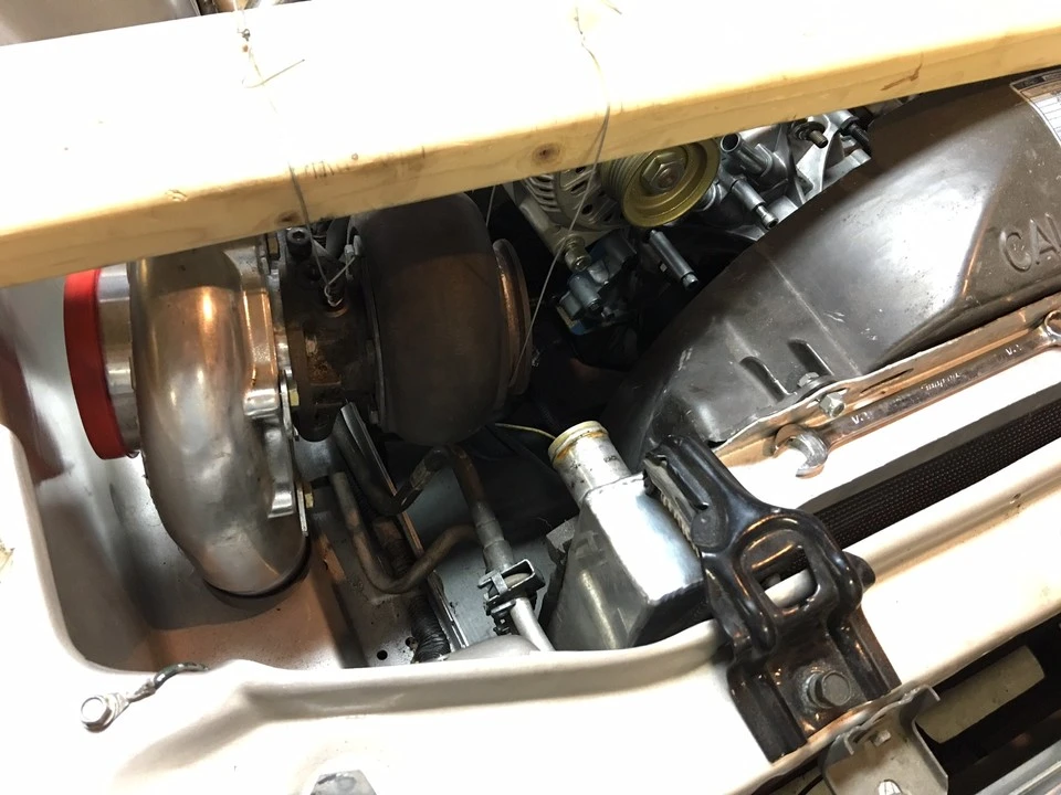

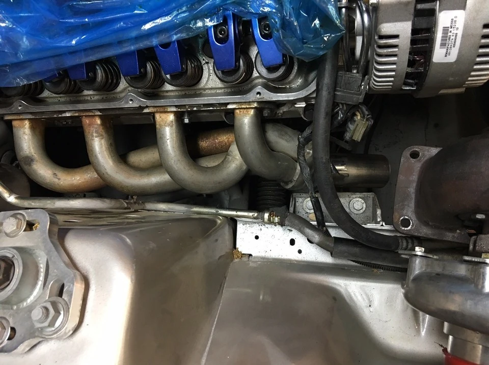

It actually fit, it's just that where the collector sat in relation to the turbine housing placement in relation to the A/C lines, alternator, and radiator was never gonna work. So the downward angle of the shorty header I had waiting on the shelf works better in this case.

I looked at it. I saw that the tubes cleared the strut tower.....(amply)
But, there's more to "fit" than just fitting in the box. (all stuff I'm sure that you are now all too painfully aware)
Building a header is a bit ch, especially when you gotta do it one little splice at a time, and now don't have the luxury of being able to hold the joint w/ one hand, and pop a tack on with the other.

Oh, what's in the picture is NOT what I built. That's just a 'regler ol shorty - aka Plan B. But I post my stuff regardless for two reasons - 1) I have no shame and 2) I value the input of others (i.e. you) to tell me where I'm effing up and say 'do it this way.
Edit 1: Plan B (pictured) should work fine, I just ran out of time last night to get any further.

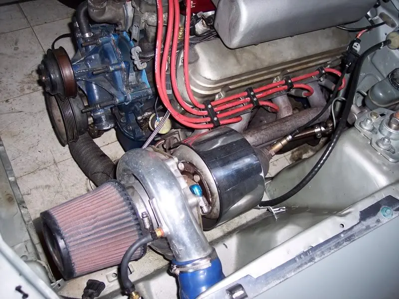

Short term - in front of the front tire.
Long term - Raceoholic's DP.

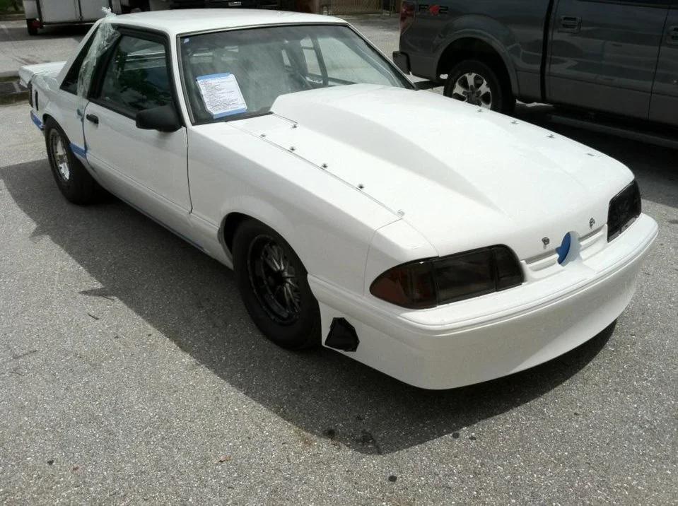

Race car Status-at least temporarily
:-) lol
Long term - it will go down and outboard of the frame rail, come back in through the K member and straight back to the cat back. Similar to Raceoholic's DP.

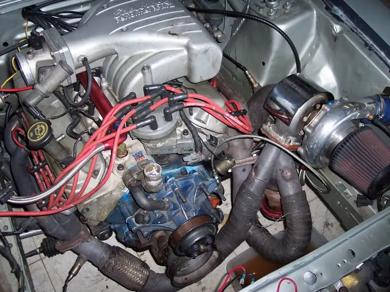

Turn that turbo around and save yourself some square footage. Running a DP across the engine bay f*cks up all the accessories routing and clearances. I'd avoid it if I could.
Unless it doesn't fit your long term goals. Even in that case I'd turn it 90* and forward face the turbo
Mine is forward facing and i hate it. It's all got to come out to get to spark plugs. Not a good design.

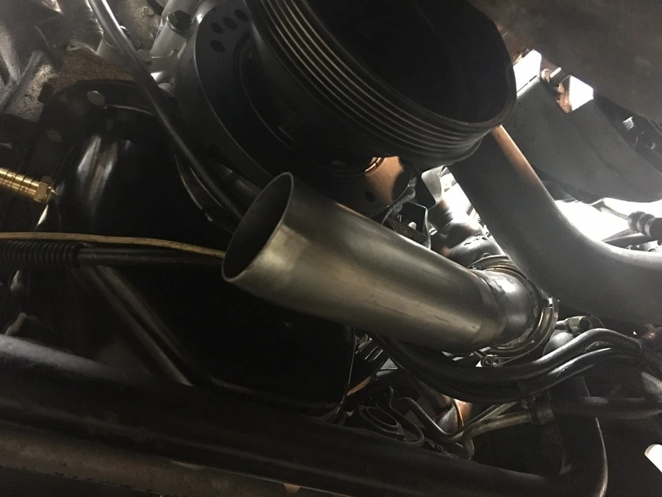

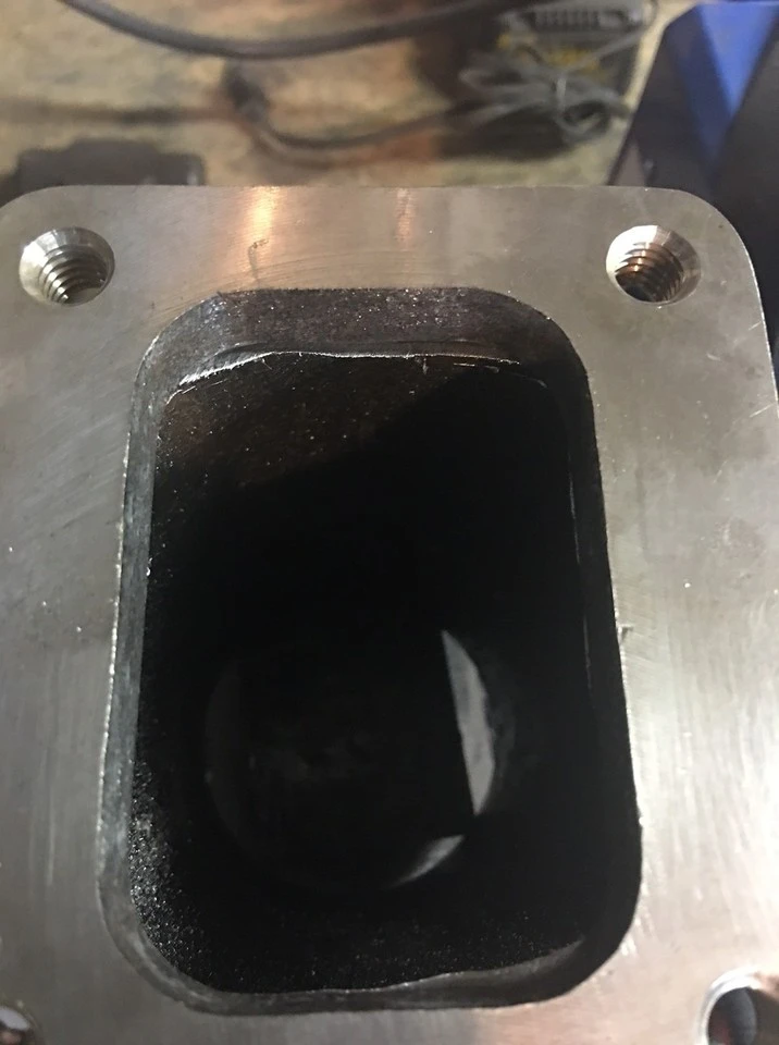

Here's the whole story from last night:

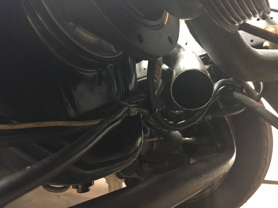

I bolted on the PS pump and hooked up the hoses, ran cables, blah blah etc. to make it as close to a complete engine bay up front as I could. After a couple of fitments, I got a 45° bend cut just right to snake between everything as such:
Then we added another piece and a V band so I didn't have to keep unbolting the header.

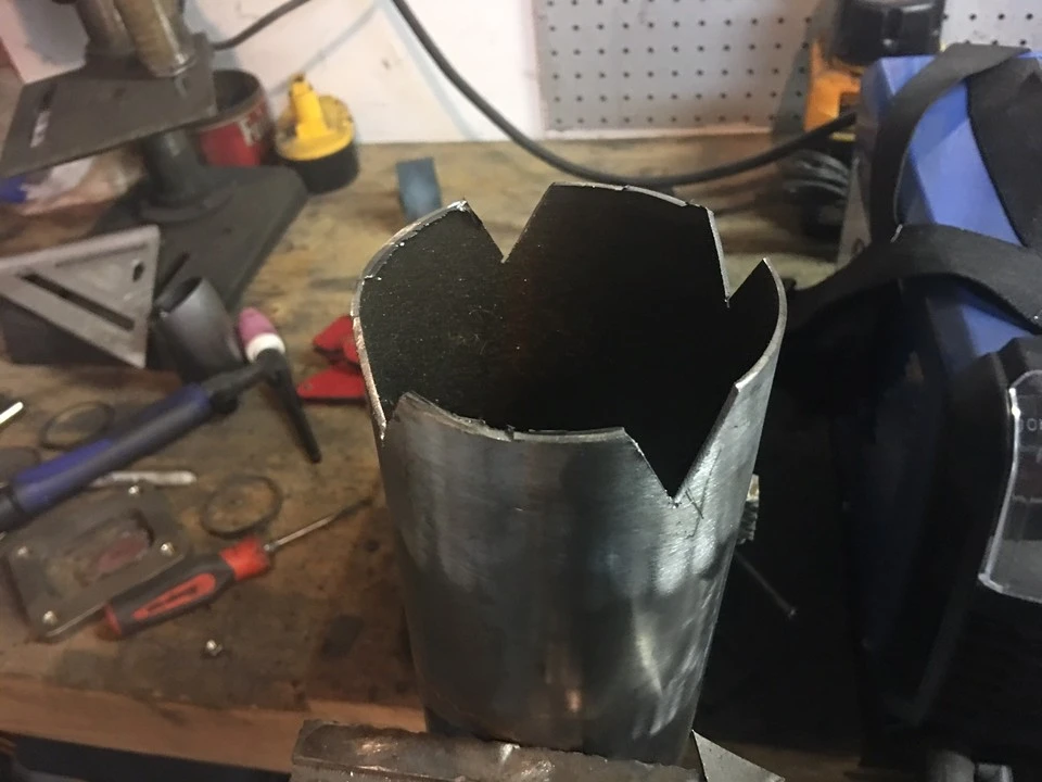

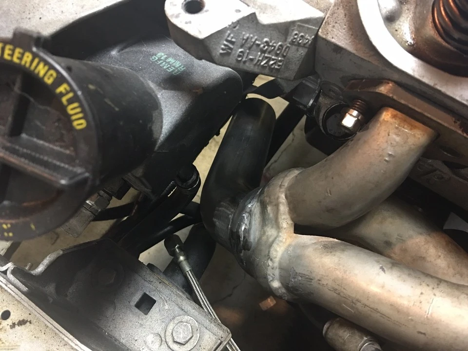

Then we ran out of welding gas, but it was well before my self-impose 8 pm curfew so I decided it was time to start working on the merge into the flange. It started off well, or so I thought:

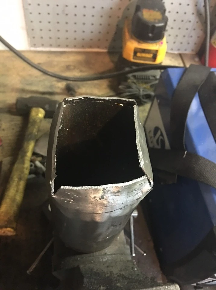

But the execution left a little to be desired.
Although, it fit on the flange pretty well.
It's pretty well documented that I'm a function over form time, but even I can't let this go. It looks like a bag of mashed up a-holes. I will re-do it tonight, although I have to do a brake job on the coyote which will probably take up most of the evening.
Making progress at least! The more I use the TIG, the better it seems to be getting, although I keep finding myself saying "you dummy, you know better than to try it like that." After burning a hole through something. Still worlds better than using the MIG, although it would be nice for tacking pieces together in place.
